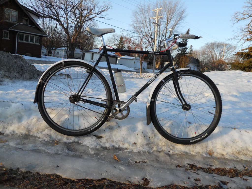

I’ve fit bontrager 29.3 2.0’s in my x-check, and I’m pretty sure that’s as big as I’d wanna go.
still had room for fenders vertically, but tires were as close to the seatstays and fork blades as I’d ever like to get.
