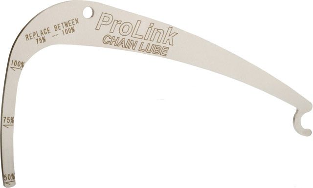

Once I settled on this guy:
And started changing at or before 75% my cassettelyfe has been nearly limitless.

If it slides all the way down on side A, you need a new chain. If it falls all the way down on side S, you need a chain and cassette. If it falls in on side S and rattles back and forth, you also need new chainrings.
It doesn’t tell you quite as much as the pro link one, which is really nice, and does the same thing as the park one pictured above. The main advantage of the rohloff is that it fits into the little chest pockets on most shop aprons pretty nicely, so you can keep it with your pen and your 3/4/5mm Allen wrenches.

Unless I’m missing something, that’s subject to the same misreadings as the CC-3, Rohloff, etc.
Unless I’m missing something, that’s subject to the same misreadings as the CC-3, Rohloff, etc.[/quote]
damnit I thought they’d changed it to use the inside face of the tooth
guess it’s just the hard-to-find Shimano tools then
QBP has it, but it wholesales for the cost of a new chain. I wish I had taken the one from my last job - I was the only one who ever used it.
[quote=b-roll]Once I settled on this guy:
And started changing at or before 75% my cassettelyfe has been nearly limitless.[/quote]
I like this one as well.
shimano tool is rad, but in practice it works just about the same as the tools that double count the wear like the pro gold or the park ones.

I don’t get how technically ‘double counting’ the wear is a thing if you are reading out an arbitrarily assigned percentage rather than an actual distance. Seems like the correction is built into the empirical confirmation of the arbitrary scale. By empirical confirmation I mean reliably getting fresh chains to be happy with existing cassettes and chainrings, while not replacing chains at an absurdly fast rate.
