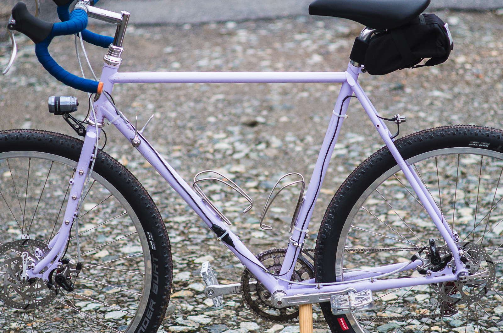

I just rebuilt my PolyV proto with some weird stuff. Please tell me how much it sucks.

I’d like it if you cleaned up the dyno wires so it looked equally clean from the NDS and the DS and got some blue housing.
The shifters get a pass because not everyone like easy to use shifters.
Are those the new VO rims? What widthway?
Looks like you ran into the same dynamo routing problems I did.
Any reason that VO chose to go internal rear brake routing instead of continuing the zip-tie mount trend seen on the chainstay & fork?

You are a very patient man. That is some great routing. I like the internal brake routing cause it’s really clean and it adds a nice touch of class. I’ve been thinking of drilling the frame for internal Dynamo routing but I don’t want to encourage people to drill their frames out.

dynamo wire heatshrinked directly to the shifter cable itself is some galaxybrain.jpg
Yes. Everything will be revealed in time…well, when the blog post goes up next week. But they’re good for tires between 38-2.3, and tubeless. I mounted some aggro 2.5s last week, but haven’t ridden them yet.

-It isn’t snowing here yet. I thought we liked the Thunder Butts? They seem to roll well and are pretty comfy.
Just smang some di2 conduit tape on there and it’s done.
Thunder Burts are A+++ in my book. Still among the best “gravel” tires on the market, despite not being marketed or sold in such a way.
I think it is pretty
Other than the wiring of course
