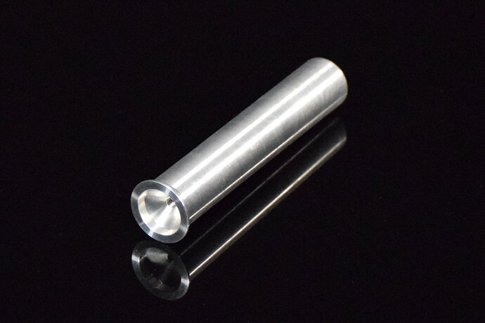

Another possible option:
Caveat: the inner diameter of the steerer tube needs to be greater than 23.5mm and less than 25mm.

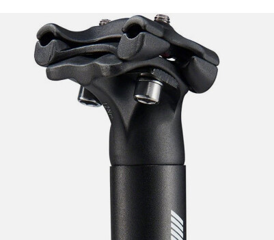

yeah, Iāve used many of those and donāt care for themā I was thinking about something where the angle adjust was controlled by turning a dedicated screw or cam. arguably I guess I could try a one-bolt with a wedge clamp like Canyon or a transverse bolt like Ritchey
Which type of two bolt do you mean?
IME the bottom one is basically separate because one bolt controls the clamp force and then the angle is controlled by the other.
Looked at this too, consensus seems to be - conceptually - it might help, it might not but itās not going to hurt?

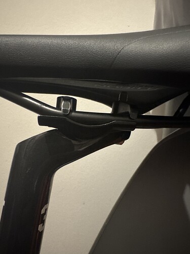

I have a 3T Dórico which has the two bolts fore and aft like your second example. however in practice, tightening the aft bolt āenoughā affects the angle much more than the front bolt
you can see also how much of the aft bolt is exposed with the saddle levelish
it is also possible that Iām an idiot and have some part reversed

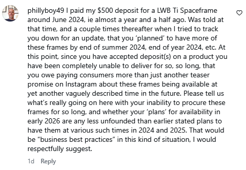

Thatās what I was saying about him having strangely few frames in stock. Either business is booming or something is amiss!!
They went through a period of having nothing in stock after one of their sales in 2024, maybe early this year as well. But the amount of sales/discounts theyāve been having makes me wonder whatās going on there.
