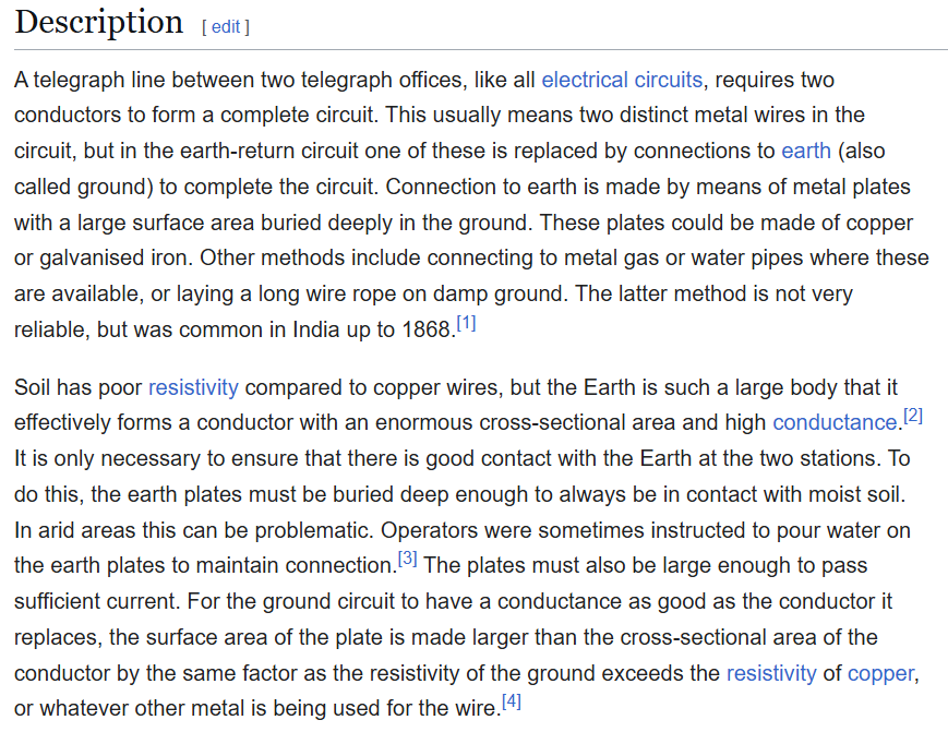

Can any of you explain to me how a single wire telegraph worked?
without googling? guessing the ground is the ground
that’s what the google says but that makes no sense, how does that create a circuit?
just measuring voltage on the wire compared to the physical earth(?)
I know this is how it worked, I just doesn’t feel correct.
I think the telegraph lines were positively charged by either end by huge batteries .The “earth” was to provide a path for the remote signal. Current needs a voltage difference to flow. It’s typically high to low, but there are negative battery systems that get used in communications a lot.
If you really want to get weird, IEEE Std 80 gets into grounding for AC systems. I have a buddy that is on the committee that understands it way better than I do.
So it’s not completing a circuit through wet dirt it’s moving from high state to low state? I can deal with that

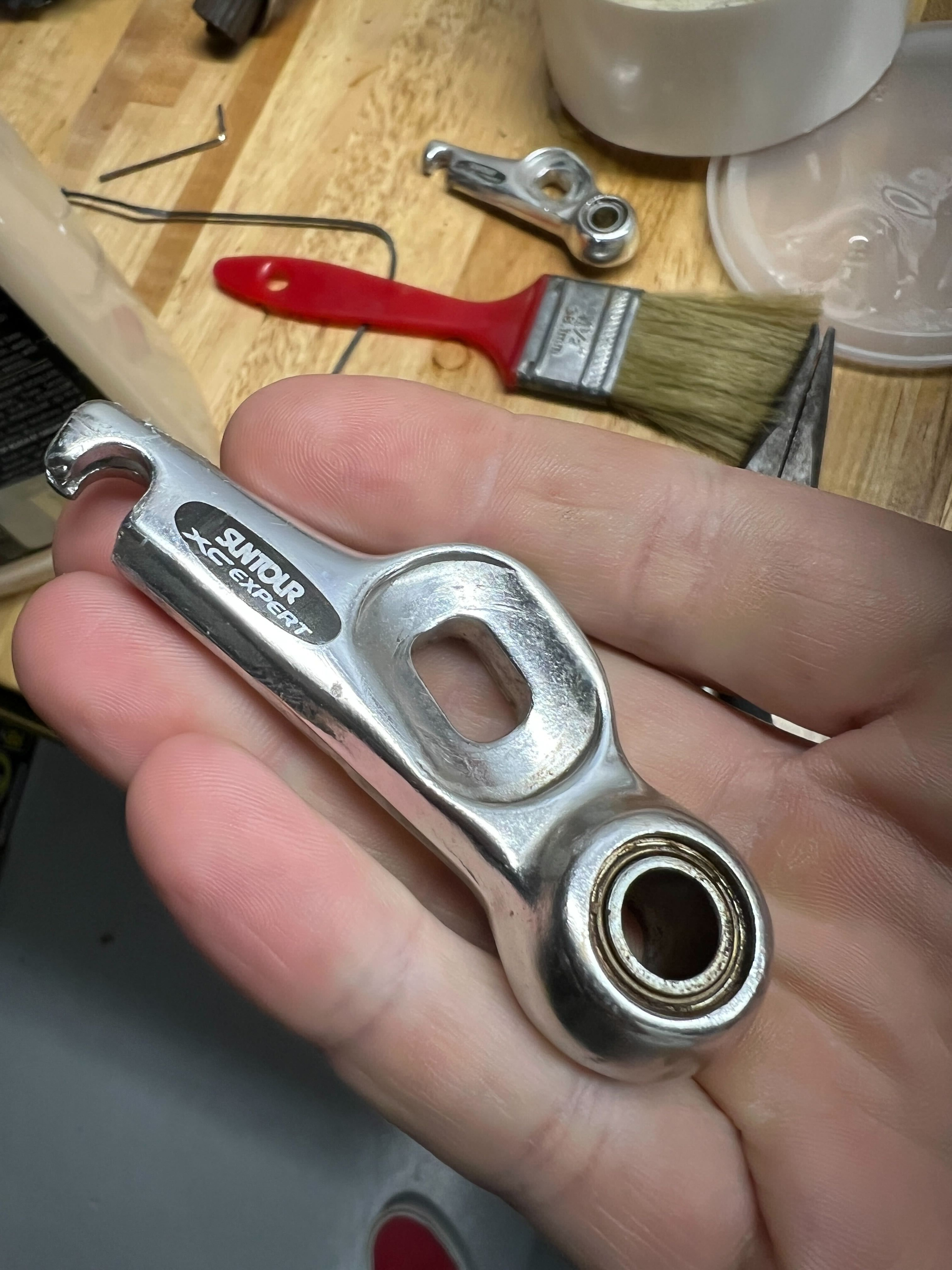

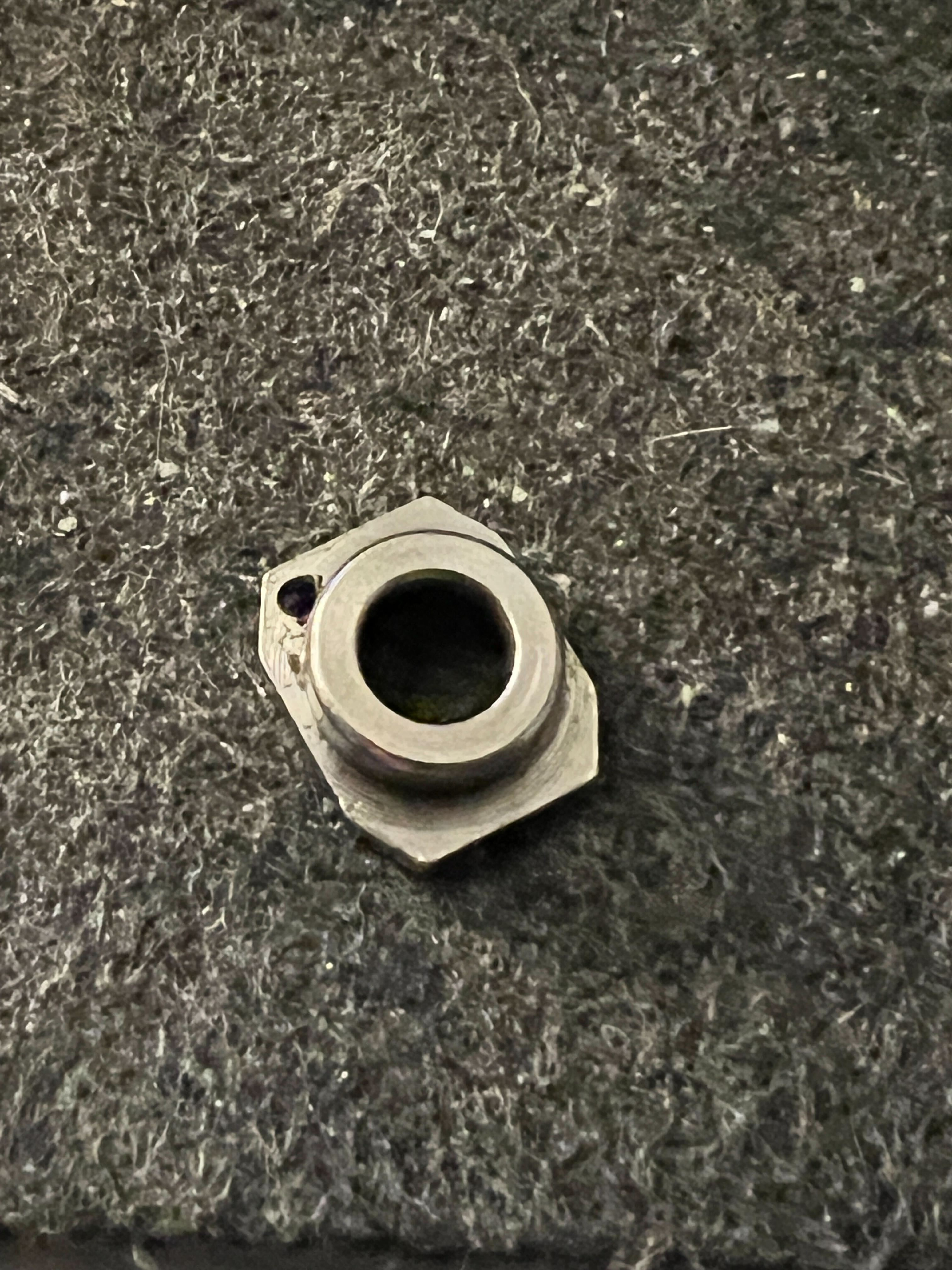

I’m starting to set up these old Suntour XC Expert canti brakes and you need one of these PER ARM right?
I took these brakes off a ~93 RockHopper and I assumed they were fully intact, but I only have two of these total. No idea if there were only two to begin with, or 4 and I lost two of them or what, but I’ve never set up cantis from scratch before and it’s pretty straightforward but I still have no idea what I"m doing.
(Arm for context)
I’m tempted to just buy some old Avid Shorty 6s or fun color Dia-Compe 980s and cal it a day rather than messing with this old Suntour stuff.
is that supposed to be the tension nut?
I believe so, but it’s not a nut (obviously)

And for this one I’m just now noticing that there’s only one, which is just weird to me, so I wanted to check with the team of experts.

yeah I see that tech doc has only 1 spring tension balancing sleeve nut.
which I have seen on bikes before, like I wouldn’t necessarily assume you need 4 per bike
Very good … they were intact and “working” when still on the donor bike, as in they didn’t feel weird when I manually compressed them with my hand before taking it all apart.

Easier to adjust if you only have them on one side
