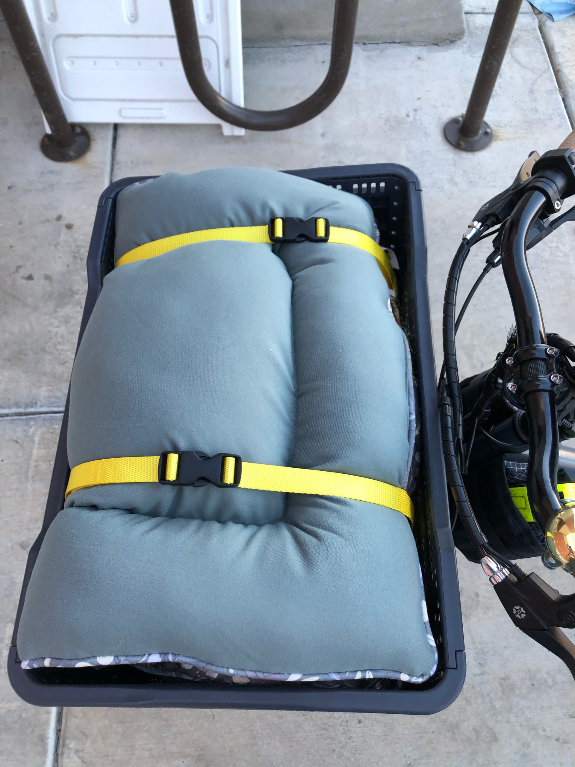

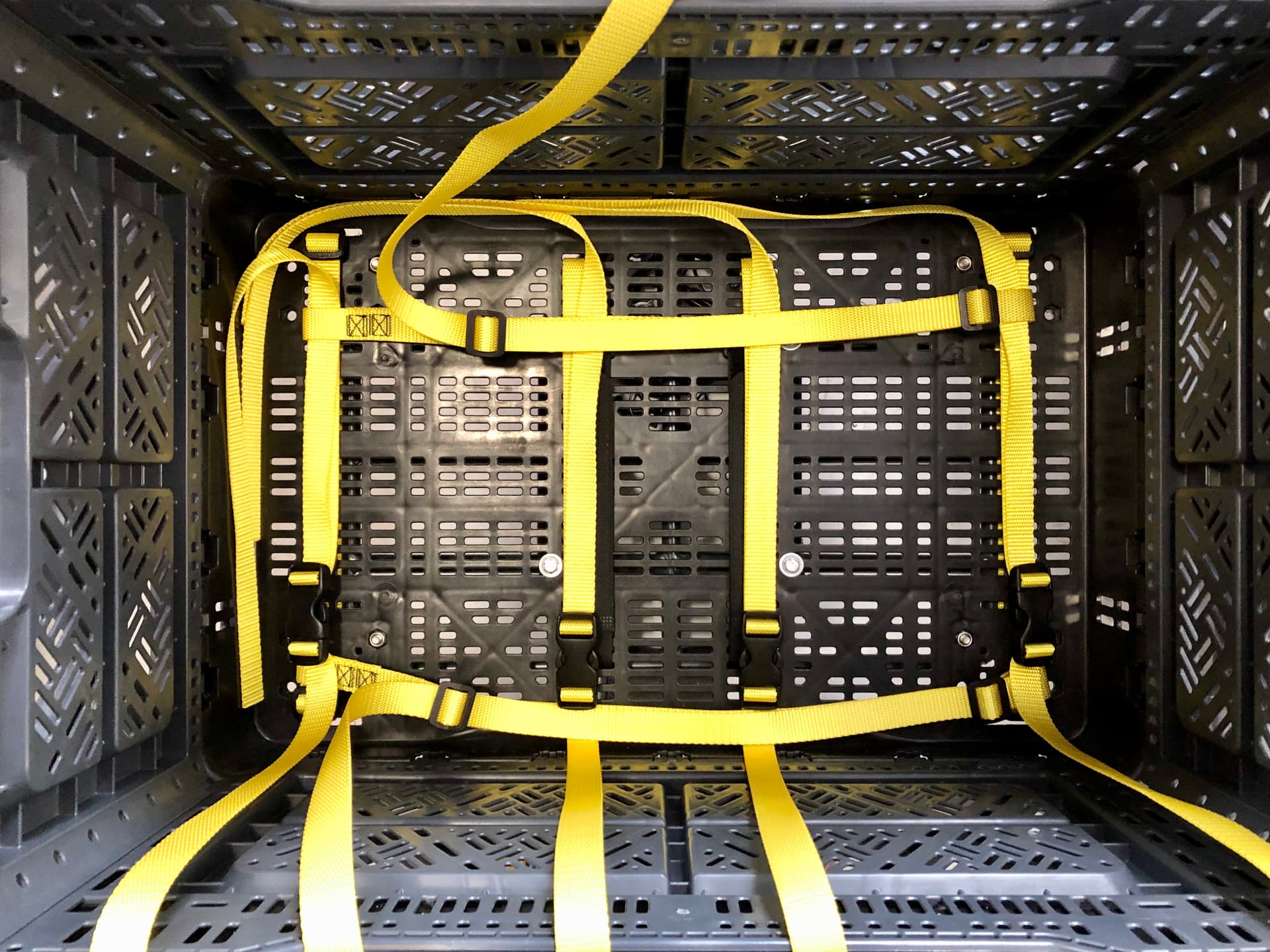

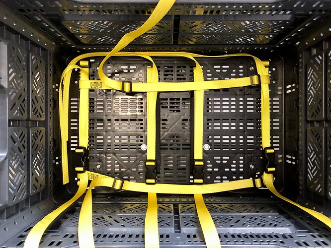

Straps inside the BIGANT. Do it right and it will still fold flat.

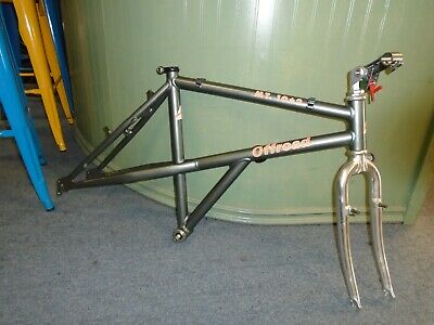

I’ve been passively looking for an alloy frame to replace my steel one as a clydsdale platform. Should I get this ridiculous thing?
That’s a 9/8 headtube, right?
edit: hmmm, I’d loose my kickstand. Not sure I wanna deal with no kickstand on a cargo bike.

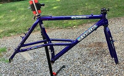

edit2: this one has a confirmed 9/8 headtube:
E-stay bikes love to crack seat tubes….
Why?
And where do they crack?
cruising the avenues in my big silver pyramid
chain tension twists the seat tube and they find a stress riser at either weld or sometimes somewhere in between
ive never actually used the fold down capacity, and i always keep a 1" thick layer of closed cell foam (because it was free) in there to stop rattling. I actually even hide my pump and the security allen key for wheel removal under it too. but if i had to i would have no qualms throwing the foam away

I’ve folded it down once, maybe twice, and only before it was electrified. Now I DGAF about air resistance. Plus, anything big that I might have had delivered to the office (to portage home) gets delivered to home now because of the stupid pandemic.

SQ: do e-stay bike plane like crazy before they crack?
i imagine this being the reverse of my katu issue
@orloved help this fellow out
edit: he sent me this earlier https://fortmyers.craigslist.org/lee/bik/d/cape-coral-offroad-752-bike-for-sale/7391137996.html
oh yes – if you need this picked up I’ll be around Ft Myers around xmas!!! Always happy to help with a horrible bike decision
I had an 857 in college. It wasn’t good, but it sure was cool.
That or the BB falls out.
