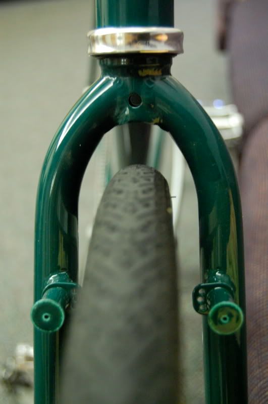

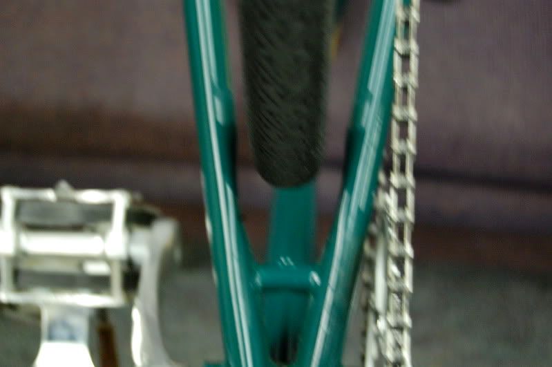

sorry for the blurred pictures but f/r tire clearance on IRO Rob Roy with 700x32’s
rear tire could go further into drop out giving more clearance
