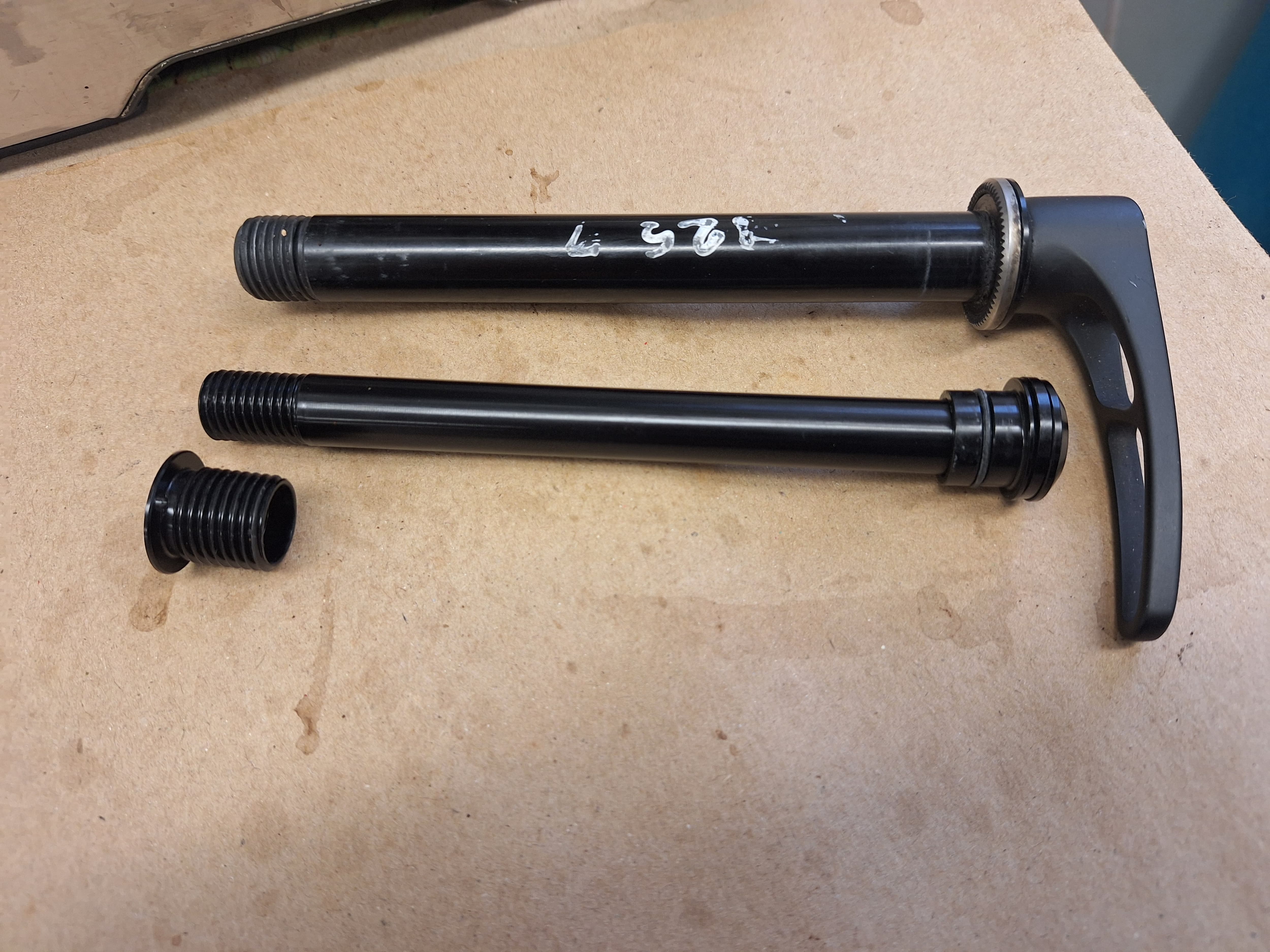

I found myself in the situation of having acquired two 100 x 15 mm carbon forks, but only having a 100 x 12 mm dyno hub.
One’s axel is 150mm wide and one is 125mm wide. I had no idea there was so much variation in TA stuff, as I only have a couple of TA wheels.
Anyway, there are zero 12mm replacements on Ali-express for the 150mm but I found a converter for the 125mm one.
It fits the fork, but not tried my wheel on it yet. 23$ from memory.
there’s an entire robert axle project incorporated around the variety of tee ayys
