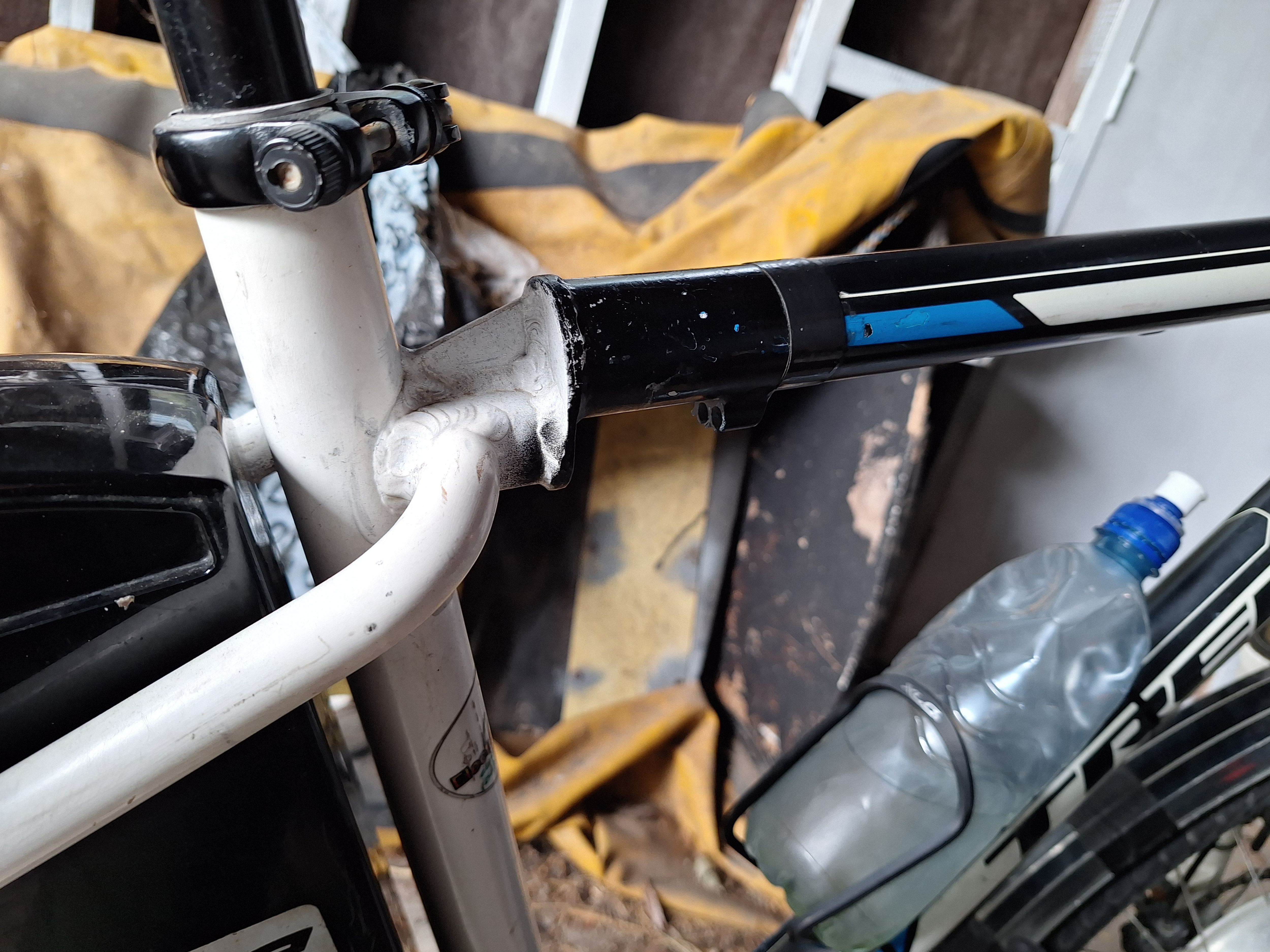

My brother inlaw told me he did this thing, years ago, and I didnt really believe him. I noticed it when checking out his younger bros KLR and Husky 701. He welded the front of one ebike onto the back of another…. Its still going strong.
