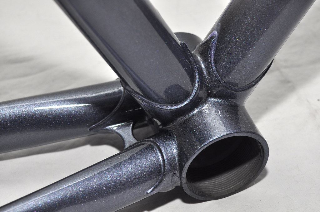

It’s all about the prep and the quality of paint. If you paint it with a $2.99 can of krylon without preping it properly it will look like shit after a few months. If you follow the steps I outlined above, you can get really good, durable results. It’s gonna take some time and cost more than 20 bucks, but it can be done.
Here’s another thing you might try for a cheap-o paint job. Do all the sanding and prep yourself. Then see if you can find a friendly autobody guy that will just hit it with whatever color the car he’s painting is. My father in law can do this for free despite the fact that his boss is a total nazi. (he can’t even use the paint booth to paint his own car).

exgirl bike is holding up fine and my red conversion held up pretty well.
kemmers method sounds awesome and i’d totally do that, but here’s what i did with mine:
took down to bare metal with stripper and wire brush on a drill
shot filler primer
sand with 320 grit
then sealer primer
sand with 600 grit
thin coats of paint
thin coats of clear
wetsand with 1000 grit
buff
wax
i let it cure for a week between the color, clear, and wetsand/buff so the whole job took like a month.
like kemmer mentioned, using new lint free cloths when removing dust and whatnot is key.
with spray can jobs it really only chips when you lay on too many coats.
i used a microphone stand stuck up the seat tube to suspend the frame. it was nice because i could spin it around.

That’s a great thread. The only thing I would add is that it’s important to always use lint free rags. Also, he says you can use any old degreaser but you really need to make sure it’s something that wont leave a residue.

acetone
sup with some mineral spirits?[/quote]
Perfect.[/quote]
acetone[/quote]
Even better, that’s what I use.
