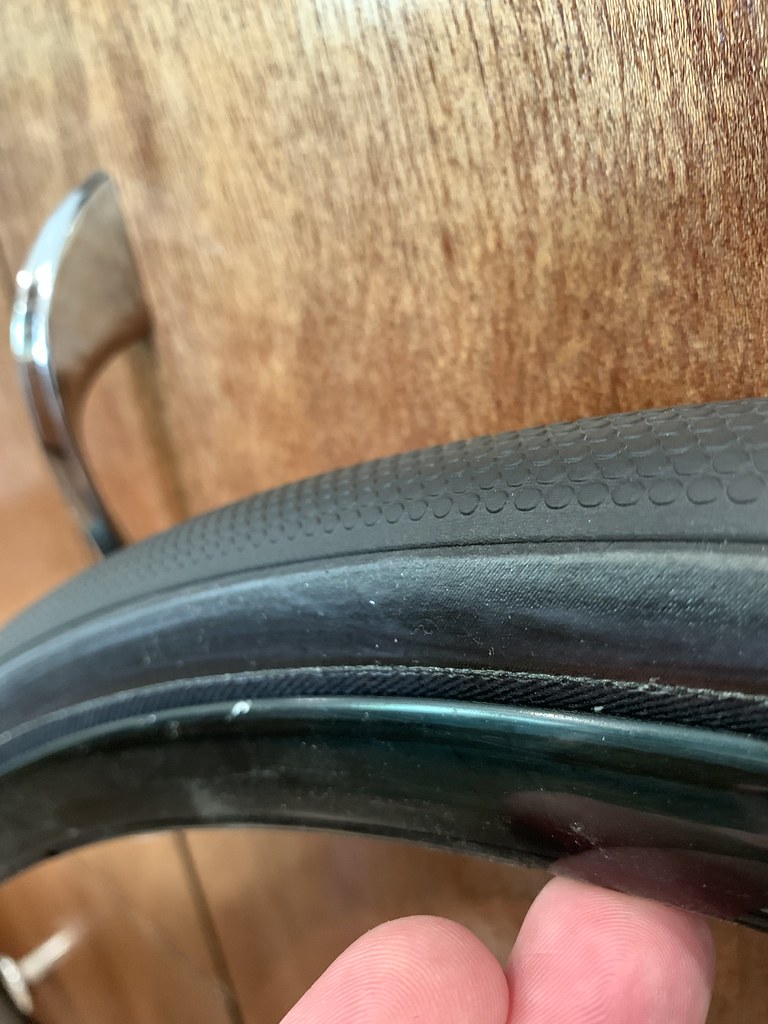

My point is that they used a piece of textile to clad the bead on a tire when, as far as I know, it is generally known to clad the textile portion of a tire (the casing) in rubber to protect it. It constitutes poor design shartmo. I think it’s fair to say that literally no manufacturer recommends that tubeless tires be thrown away the first time the bead unseals from the rim. I doubt that anyone, including you and the people who design the tires, observes that practice
I don’t keep close track of mileage. Probably not quite 5000
One time, no of course not. But removing and installing a tubeless tire a dozen times constitutes misuse in my opinion. I would never do that with any customer or personal tire and it is asking for trouble.
I personally agree that I would never expect a tire to be remountable a dozen times
But on the other hand we had a tire we used for tubeless rim blowoff testing at T and that tire had to have been mounted 50+ times before it was done
And the people who did that were not what I would call careful
And what about a tube tire? My complaint here has nothing to do with the fact that the tire’s ability or lack thereof to be set up tubeless. If I put a tube in it, it would push through the tear left by the peeled-back canvas and blow out, which actually did happen on the other Horizon. Whether you use them with tubes or without, the process of inflating the tire causes the top edge of this canvas strip to rub on the rim hook, which apparently causes it to eventually unpeel completely from the tire and leave a weak spot in the casing immediately above the bead. I’ve seen bead failures, but never seen this peeling-off failure mode on a conventional tire with a rubber-clad bead. So far nobody seems interested in addressing my complaint (the canvas) and prefers to talk past it about how many times the tire was removed or installed. Sure, if I had never taken the tire off, it would probably still be fine. My point is that it would also still be fine, even the way its been treated, if they used rubber instead of canvas to protect the bead.
OI’m not addressing it because I’ve sold over 200 WTB tires that use that same design and I’ve seen literally one that the tape began to shift and even in that case it didn’t fail (that tire was also pretty dry rotten from use and consistent exposure to sun where the bike was typically locked).
It seems that your experience is an outlier at best and likely brought on by use that falls outside what is typical or intended for the product.
I don’t think your specific experience suggests a design flaw.

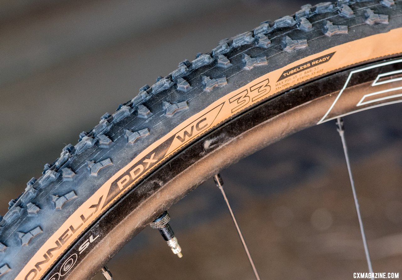

Want. 76g lighter than current tubeless pdx. 240tpi casing. Tan wall. Please and thank you.
AND they’re finally releasing the tubeless LAS. I think I’m more excited about that, but at least a month till those come through.

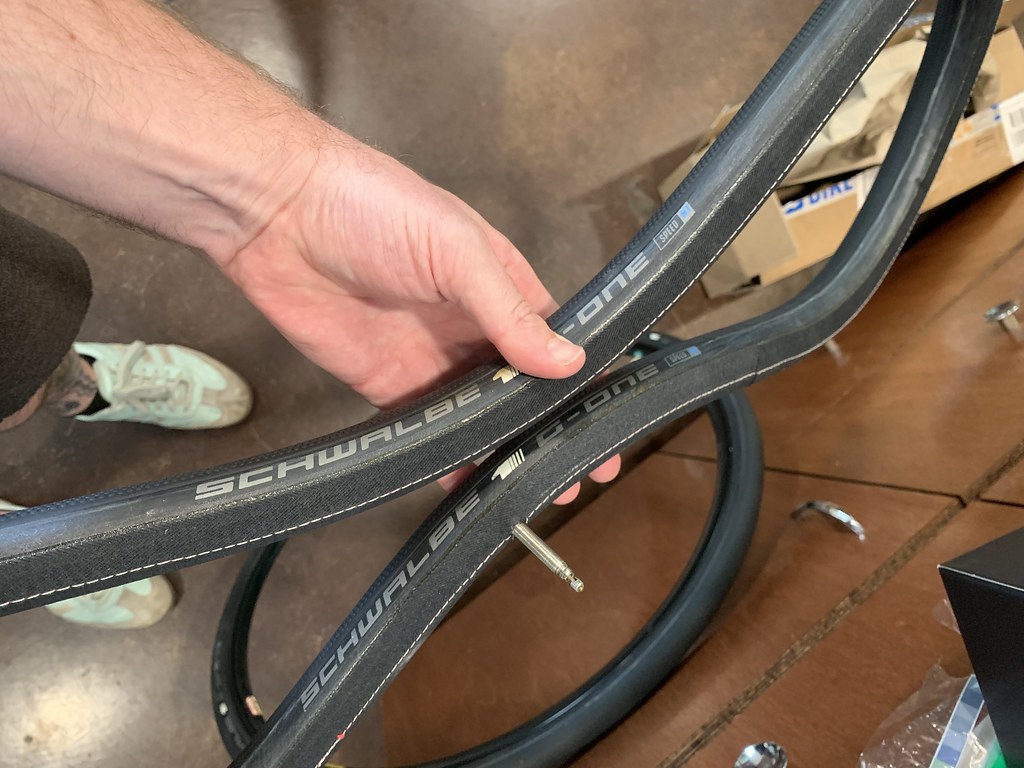

got the Schwalbe G-one speed, 30mm. they seem legit, will glue one up tonight maybe.
the casing is nice, and the treadband seems nice (less stiff than the corsa control if you squish it with moderate psi in it), will probably ride well.
there is a little bumpiness in the casing around the valvestem, that’s pretty normal with tubs i’ve found. doubt it will be felt while riding.
i put two vittoria corsa control on my bike, killed the treadband on one in 15 miles. the treadband on those is pretty stiff but it seemed like it would last a looooooong time, was thinking, oh a tuff tire that will last and will ride ok once i get the air pressure right. 15 miles in and the rear felt like it has a rock in the rim. i did really brutalize that tire on some bad edges of transition from ground down pavement to concrete sidewalks…but that what those tires are supposed to be made for…
for the blowout price of the S-one schwalbe, i might order some of those too, especially if they are the same as the G-one just branded differently.
