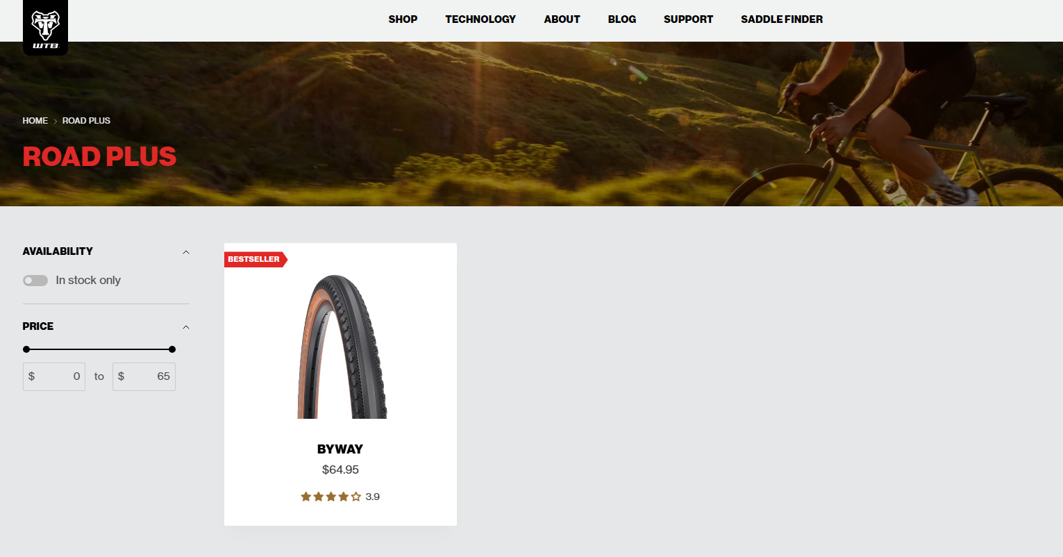

Searching for this brought me to this:
https://www.terrenetires.com/collections/honali/products/honali-700x40-light-folding
Which I think is the winner right now, gonna buy a few
20% off code at the top of the page stacks too
nicholas says they are nice tires

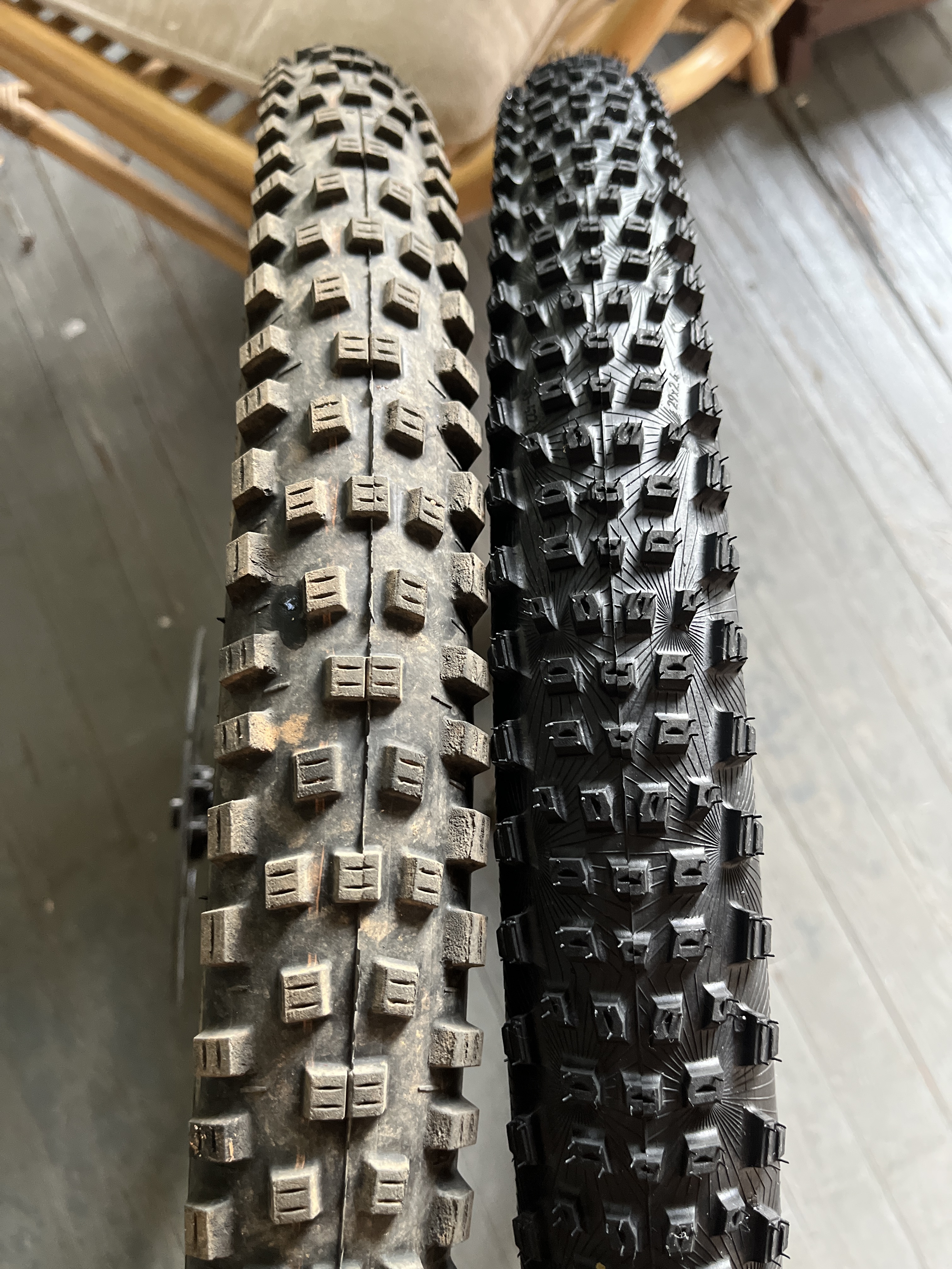

Installed a pair of 29 x 2.4 Continental Magnotals today. Installation was easy on Hunt Trail Wide wheels and they seated with a floor pump at 25psi.
I bought the “soft” compound for the front and a “grip” for the rear. Actual weights were Grip 797g and Soft 886g (published weights Grip 800g, Soft 840g). Both casings measured at 2.3" at 25psi.
I swear the “grip” compound is softer than the “soft” when it shouldn’t be, but the weights match up as far as which should be the heavier tire. I tried searching a bit for if Continental ever got their hot patches wrong but came up empty.
Here’s a comparison with a 2.4 Nobby Nic. I’m a little apprehensive about how this will do on the front.

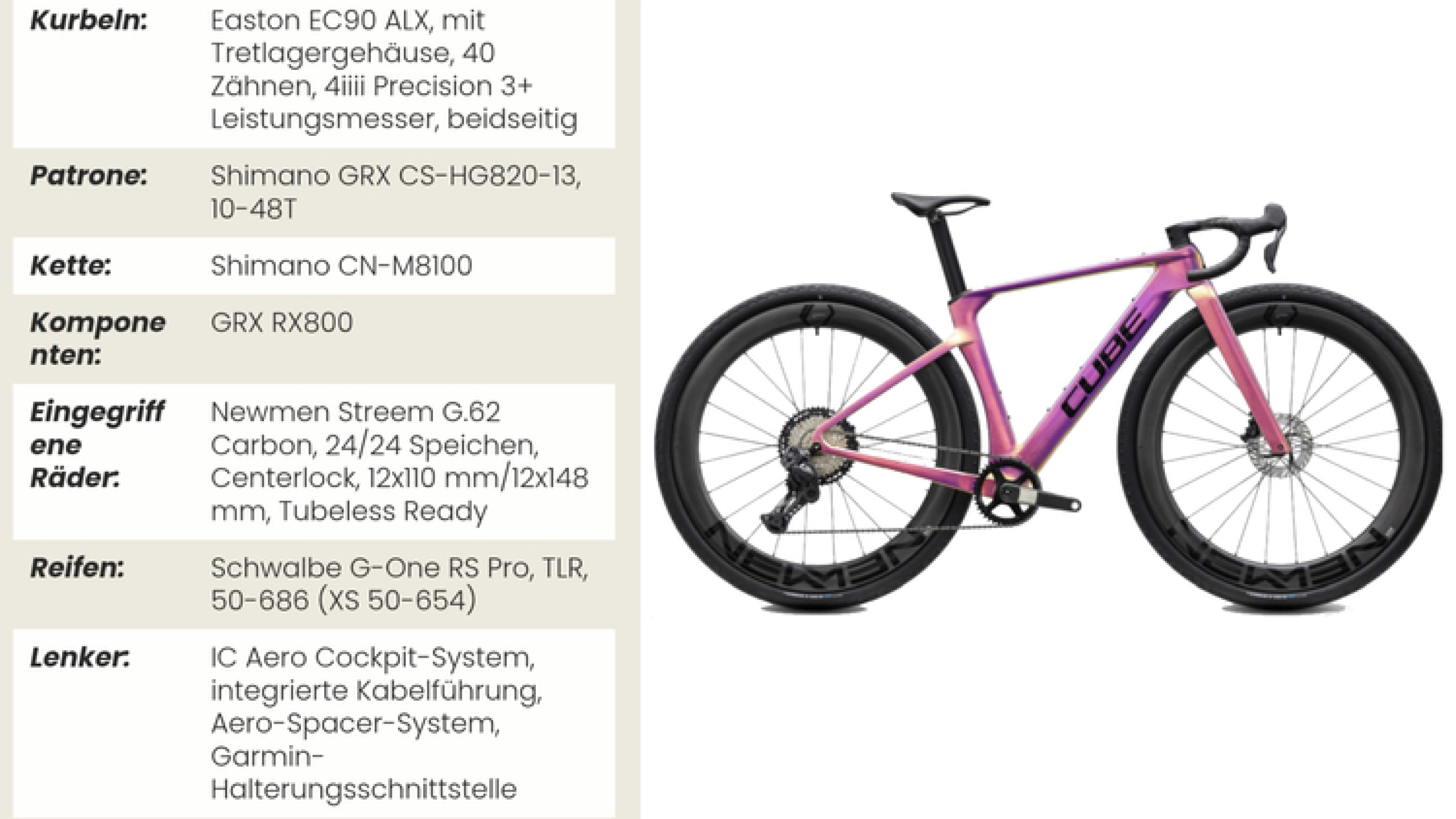

wth now the bike industry is trying to make 30.5" a thing, and it’s 654mm BSD. 750D - which people actually made real rims and tires for, that you can buy today - is 660mm BSD! cursed cursed cursed cursed cursed
do you think they realize that every time they do this, some percentage of the market says “meh I’ll just wait until it settles down” and doesn’t buy a bike?
because I haven’t bought a bike in 5 years
The bike industry thinking about long-term consequences? That’s unpossible!
I really hope that 654 is the intern guessing the bsd or asking an AI to finish the catalog page, since it’s exactly halfway between sizes.

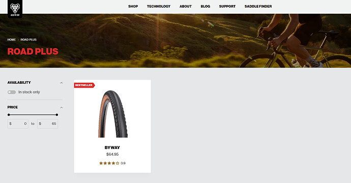

Also damn Road Plus really is dead. They even discontinued the best turdly tire ever - the Horizon. I had a lot of slow miles on those but they were pretty cush and lasted forever

If 30.5" = 654mm is correct and not a guess/mistake like drwelby hopes, it’s exactly splitting the middle betwen the BSDs of 29" and 32" (which yes, is close to the size step between 27.5" and 29".)
