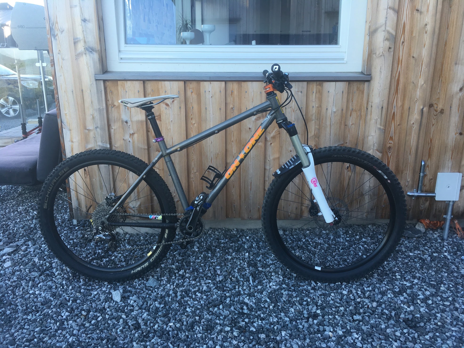

So tehschkott this is what a -2 degree angle set does with your front end, came from 65,7 down to 63,7. As I said in PYB: feels like I’ve gone from “pretty capable” to “full on party mode”. No ragrets!
Before:
After:

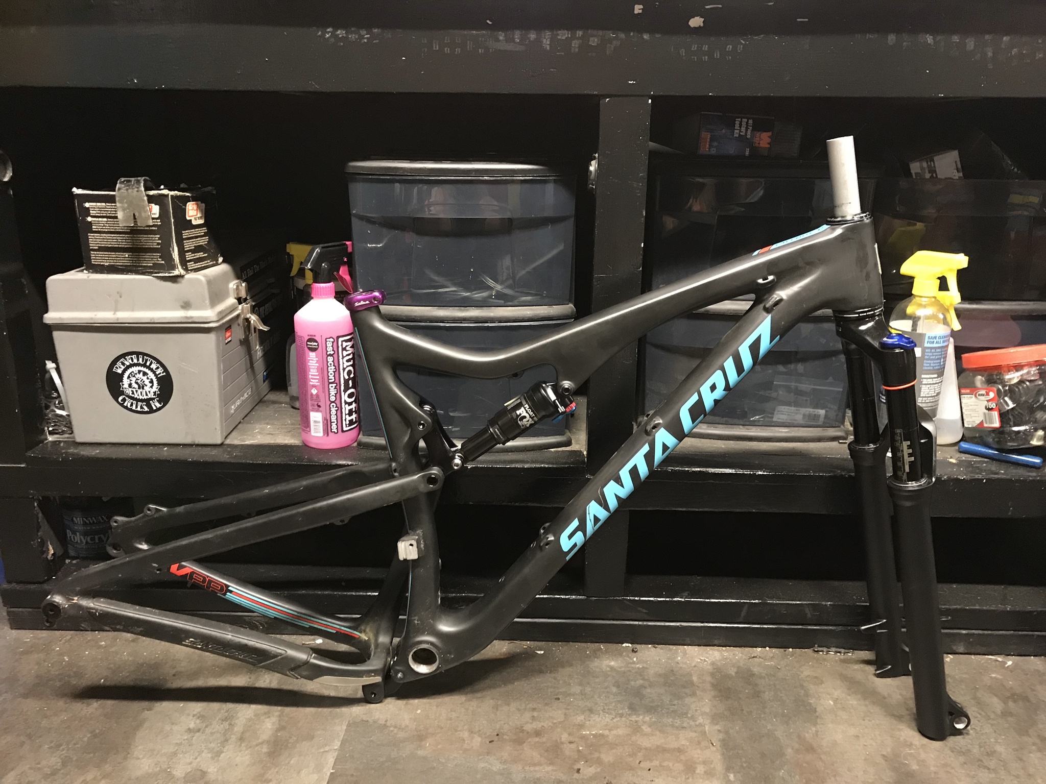

Switched from a RLT RDO a few years back to a hardtail and have been riding shop bikes when I need a FS, now that I’m leaving the shop I’m building up a parts Tallboy. Have some various bits laying around the shop that I’ll be able to make into a bike for like $400

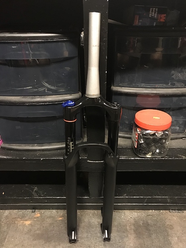

This 100mm Reba got all bended up:

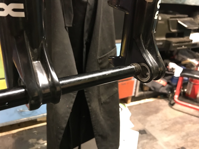

So I put on some new lowers and a 120mm air spring and now I have a fork:
Had separate front and rear triangles that are usable laying around, so got some linkages and a rebuilt a busted up rear shock. Rooted around the headset draw and came up with most of a CC 40, but I do wanna get an angleset for it soon.
fun. rat rodding together a full susser is something I’d love to do.

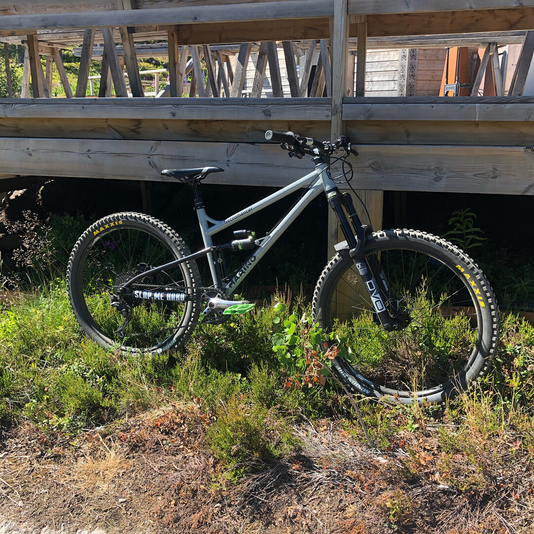

If any one is looking into ta rat-rodding a FS you should order a Marino from Peru. 500USD for a fully custom single pivot…
Some examples of their work ending up in Sweden:
[quote=Viggen]So tehschkott this is what a -2 degree angle set does with your front end, came from 65,7 down to 63,7. As I said in PYB: feels like I’ve gone from “pretty capable” to “full on party mode”. No ragrets!
Before:
After:
[/quote]
Aight, that’s pretty legit. Ima do it. Thanks for the follow up.
… blurp. NM
Vig, what headset did you use? Most of the ones I’ve seen are only 1 degree. I’ve been looking at doing something like this for a while.
I snatched one from Superstar Components, made in the UK and all that jazz. Felt and looked nice when installing and uses easily replaceable cartridge bearings. They have -20% off all their UK made stuff right now with code: SUNHOORAYFP
There’s also the ones from Works which looks almost identical. They offer -1, -1,5 and -2 degree options.
