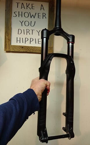

The stock 29er Recon RL (32mm steel stanchions, not much adjustability, never felt like it supported my weight well, weirdly harsh over small stuff) is the first thing to go, mostly because I found a good local deal on this:
2020 Pike RCT3 in 160mm 650b-way. $250 with 50hrs on it, recent seals, includes some oil, tokens, and an annual service kit.

does your stock 29" wheel fit in the 160mm Pike?
if not, would you dare pick up a takeoff 27.5+ front wheel as your next move?

Thanks y’all for reality checking this. Lots to think on. It’s gonna be a while until I can really try all this anyways. I do have a set of 27.5 i30mm wheels and 2.6 tires I might try first before swapping forks or anything else.
If you can try it, you should, because ultimately it has to work for you.
The MoCo damper in the Recon is crude, just a single circuit through an adjustable hole. It will overdamp on high speed hits, the only real solution is to drop the oil weight, run it relatively open, and add some tokens. (the Nico V “more ramp, less damp” strategy).
