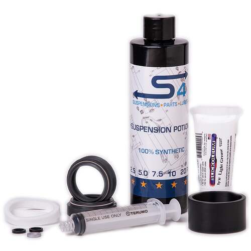

Does anyone offer (lower/seal) service kits for Marzocchi/Fox forks that include single-use packets of oil?
This might be what I need:
@Crustradamus Maybe try taking a token out and see if that does it. The deadness may be the rebound being too slow.
@Rent-to-own-Faxmachine The 250 mL ogold il bottles are good for a few service intervals. The Teflon stuff I’ve only found in quarts, though.
