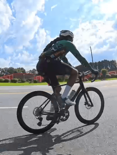

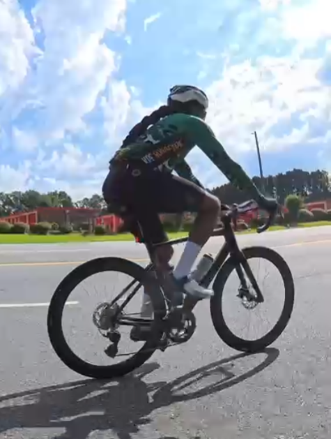

You have one right? How are you liking it
Love it
There’s not really any one thing that is amazing about it. Like, it isn’t crazy light or aero or stiff. But it just feels very nice to ride and very nice to look at. I love being back on a road bike after so many years on a gravel bike.
I wish the powder blue color had been out when I bought mine. Got the black one. A little monochrome with the black wheels and dark grey group. But it still looks nice.
I got it over things like the Ritchey because it has road-ish geometry and will take 32s with fenders. Another option I looked at was Chumba. Would have been a similar price after all the tarrifs.
This helps in deciding what i want to choose. At first I wanted the Blackheart Road AL but it can only take an electric groupset, I have a mechanical dura ace group that works fine so I don’t want to spend the extra $$$$ for electric gears. I cam across the Strael and really love the attention to detail.
The thing I am stuck on is if I buy the Strael to use as my main bike instead of the Chinese carbon frame I use now (too harsh and aggressive geometry for long term use aka I’m old) will I ā€œfeel slowā€? I like the feel of a snappy bike I just want a little more comfort which has me leaning towards the Ritchey.
I think it will ultimately come down to what colors are available when I’m ready to purchase.
I wish I could fit long and low bikes. I’ve yet to find anything that comes close to my Black Mountain Road+ and even that’s a bit long for me.
That said my body is weird I’m on a zero offset post with the saddle slammed all the way forward and it makes my pedal stroke so much nicer.
I’m all arms and legs lol
The strael will probably be heavier and slightly more laid back than your current frame. It’s right in between road geo and gravel, so for me it feels more snappy and quick than my old bike. I haven’t ridden my Giant TCR in years, but the strael feels close enough to what I remember that bike being.
