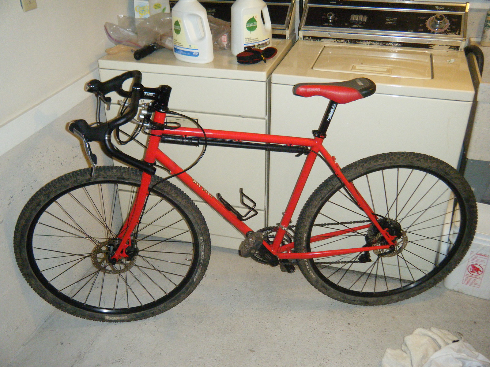

But I wanted some hydro drop bar disc brakes. Pickin’s were slim. There were no integrated-shifter hydro drop bar levers, only cable-actuated remote setups.
Top left is someone else’s hack of Hope mtb levers with homemade drilled cable pinch bolts and crosstop lever mounts hacked up to be housing stops at the edge of the bar tape.
Top right is (I think) an older Hope semi-factory system.
Bottom left and middle right is more recent hope.
Bottom right small pic is Santana tandem system which had the master cylinder mounted to a down tube shifter boss.
Bottom right corner is Magura.
Not pictured: older AMP cable-hydro caliper.
this was before the more recent Hope V-Twin, TRP Parabox, TRP Hylex, 324 Labs adapter for Formula, etc.
I REALLY wanted to get a set of Shimano hydraulic MTB dual-control levers and hack/adapt them to drop bars but at the time they weren’t yet castoff cheap.
Instead I experimented with a set of Hayes 9 brakes, mounted a stub tube in the nomal lever clamp, drilled for housing, and drilled/tapped the lever blade for a cable pinch bolt. Mounted it all to a canti housing stop hanging off the steerer on my Rawland. I did not shorten the hose.
It’s almost dumb how well it worked. Like really, really good. Way better than the BB7s that had been on there.

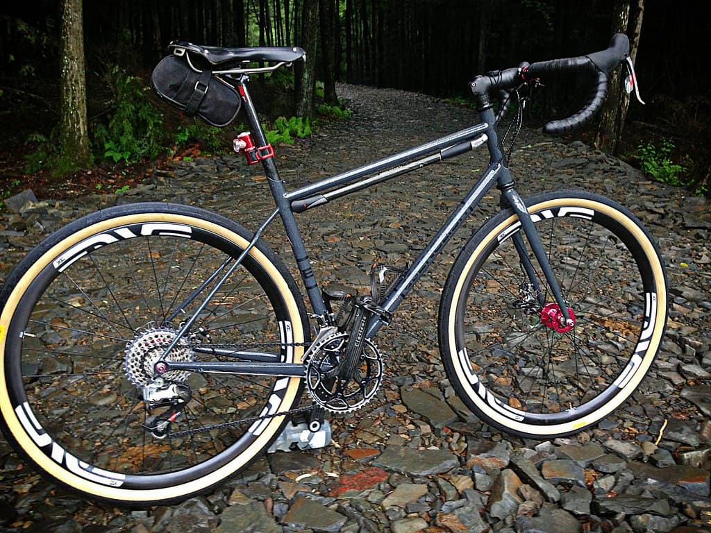

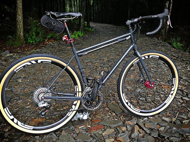

In 2010 I asked Rob for a race bike but with 650B tires and I got the 650B English in 2011.
I remember I was in a bike shop and the bike was in the stand and some dude came in, didn’t realize it was mine, and started to make fun of it. I HAVE THE LAST LAUGH NOW THOUGH DUDE

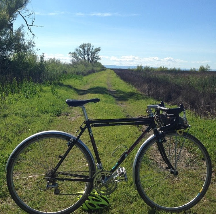

but i had this bike in 2013. still have it, more or less set up the same way. not sure what tires were on here at the time but I definitely ran some 700 x 35mm Schwalbe Kojaks that were all the rage thanks to @JUGE_FREDD and others. was looking for a bike that felt fastish on the road but could hit some dirt trails from time to time. this late 80’s bianchi volpe does it so, so well. geometry was decent too.
