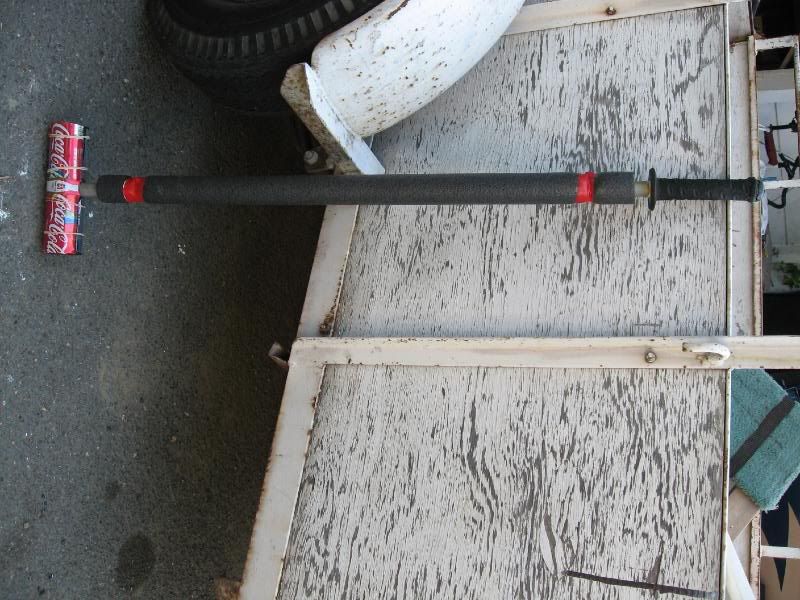

i decided i’m not really going to build a bike, but use my old mountain bike… but i did build my mallet today. it’s pretty sweet. its got a pad, and bmx grip, and cool colors, and a theme!
sweet jesus. thats quite the mallet you got there. have fun with that.
I wouldn’t let you use that mallet. Those can ends are gonna freaking cut someone’s leg or worse. Go get some ABS plumbing pipe.
[quote=“snails”]i decided i’m not really going to build a bike, but use my old mountain bike… but i did build my mallet today. it’s pretty sweet. its got a pad, and bmx grip, and cool colors, and a theme!
I can’t think of anyone who’d let you play with such a weapon. Also, to answer your previous question, freewheel are almost always better. The only exception is when you have one player on a team who plays defensively (goal tends) but even that is accomplished quite easily with a freewheel.

also is it easy to make a mallet?
Yes. linkey for making malletshttp://www.hardcourtbikepolo.com/?page_id=6
I run freewheel and like it for one main reason - I can gear it up for my ride back home. I would not want to run the same gear I do for polo to get back and forth to the park. I also play more defensive (because being a Lefty I can snake up on people.)
Mallets are easy enough to make without using a coke can. Cut a ski pole down. Get some black ABS plumbing pipe. Don’t use PVC it will shatter. and just drill a hole in the pipe for the pole then ram 2 drywall screws, one from each side in through the pipe and pole. Then grind down the excess screw coming out. Make sure you put the pole all the way through the pipe or you will break your head after a bit, too much strain on the screws.

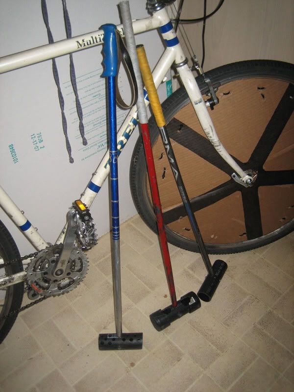

Here are my 3. Gonna make a 4th in a bit.
what is the best thing for the actual mallet part? and where do you find it without paying moneys?
also danger_scott maybe when/if i move to sf we could play
I just got some of that yellow gas pipe. looking forward to making a new mallet! Lots of people use hdpe (high density polyethylene) ordered from mcmaster.com something like part number 8705K231 HDPE is really similar if not the same stuff plastic cutting boards are made from. Rigid yet incredibly shatter/impact resistant. Yellow gas pipe is mdpe (medium density polyethylene) and it comes in big spools. You might be able to find some at a construction site, utility company, or new housing development.

[quote=“upthepunx”]what is the best thing for the actual mallet part? and where do you find it without paying moneys?
also danger_scott maybe when/if i move to sf we could play[/quote]
I use ABS plumbing pipe from my local hardware store. It was like 1.60 for a foot which is perfect bc I make 6in heads. Thats a perfect for a pair of poles, I also use 1.5" instead of 2" I know some of the Seattle and Portland ppl use 2.
