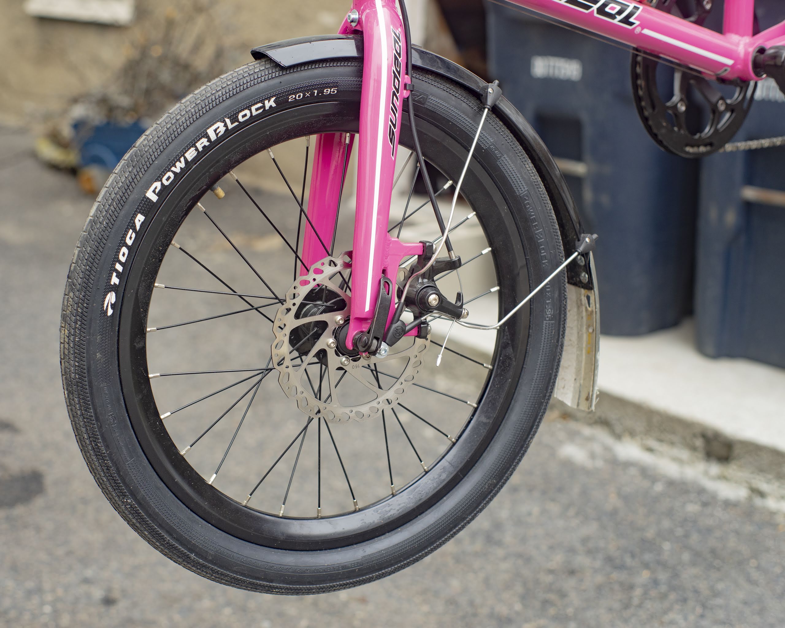

Nice! How crazy does the fork look with a teensy tire?
The front end looks weirdo. Chunky fork, 60mm fenders, chunky dyno hub, big ol’ bag. Well proportioned it’s not.

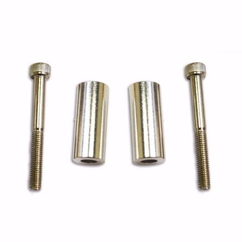

Pretty sure it’s either 1) long and wrong uggo spacer, or 2) a proper series of bends in the stay to clear the caliper and then come back into harmonious alignment with the drive side stay.

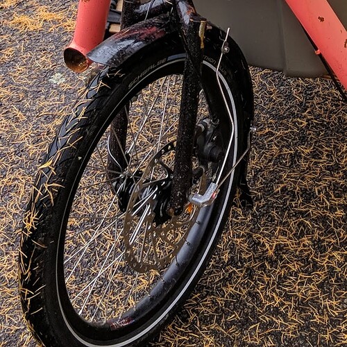

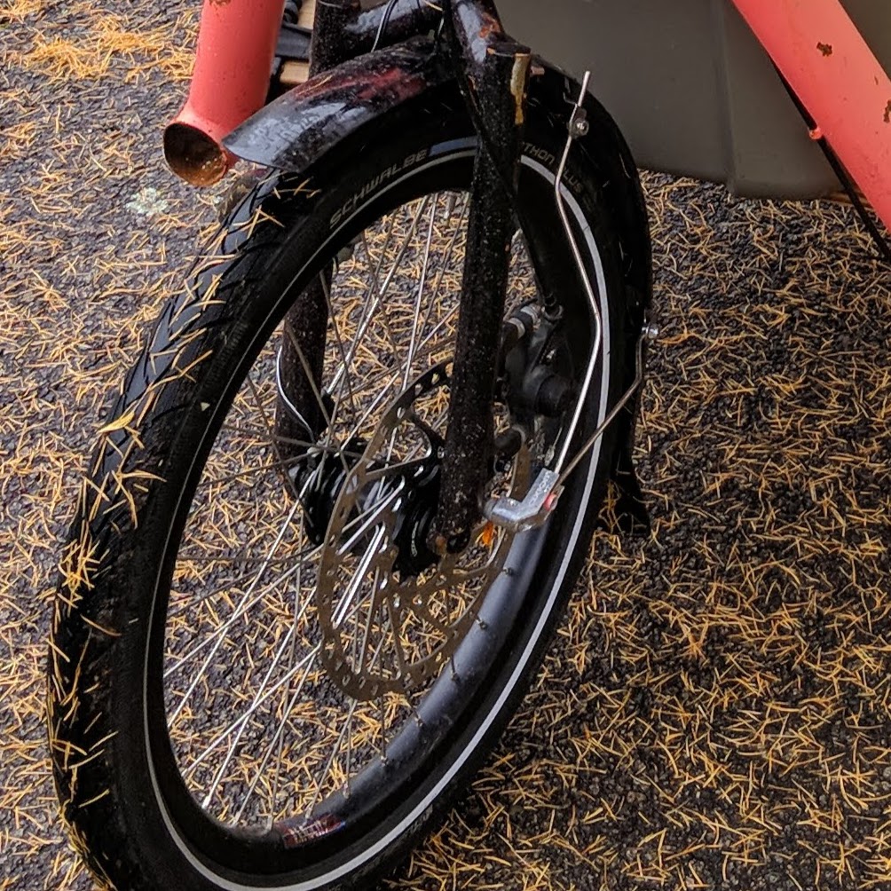

The two ways I’ve done it. Cannot for the life of me remember who makes this spacer thing I have on the cargo bike, can’t read the name in this photo but I can check tomorrow, but it works really well.

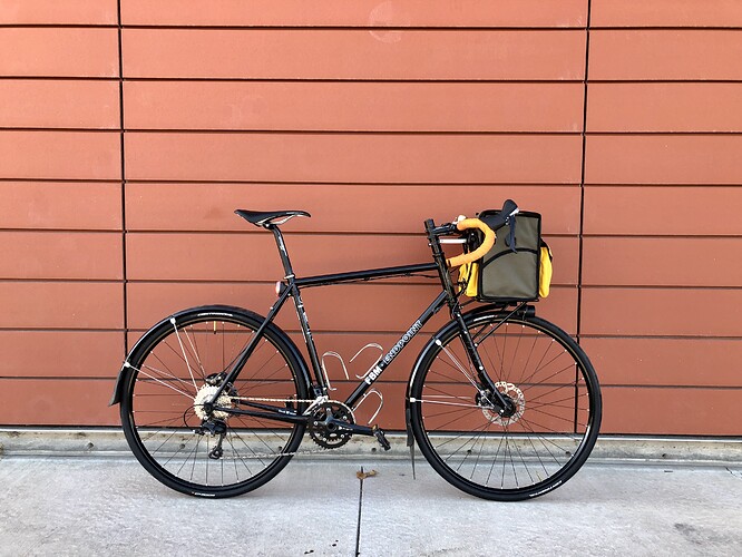

Saw this the other day, never used them.
