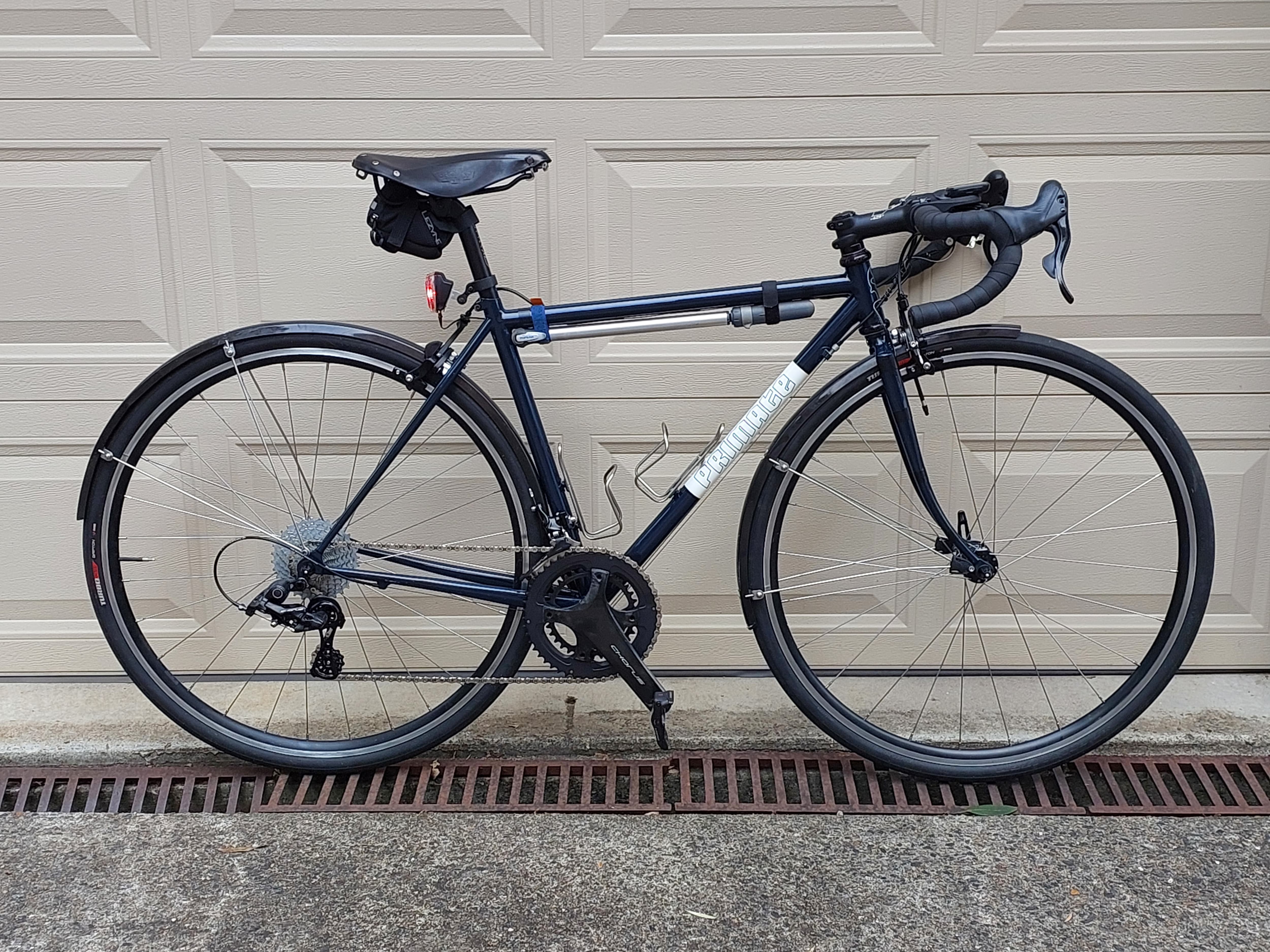

Had a big birthday recently, gave myself a Chorus 12speed groupset and a new Cyo premium. 165 cranks for my short legs, TRP 57mm drop brakes cos campagnolo doesn’t make them.
Have only ridden around the block but it feels great. We have a week’s worth of rain coming off the tail end of cyclone Alfred so won’t get it out for a decent ride for a bit. Patience is a virtue etc.
