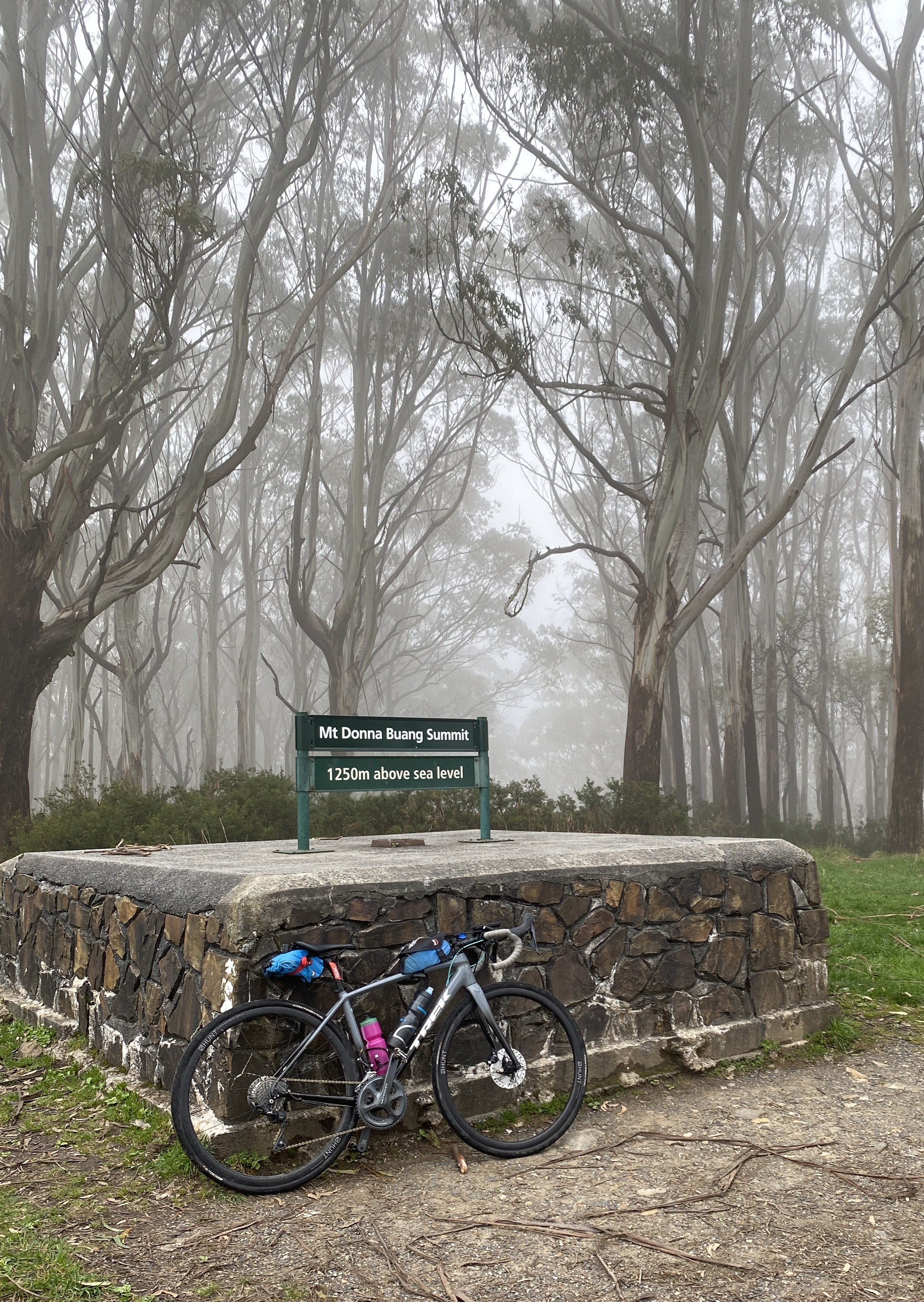

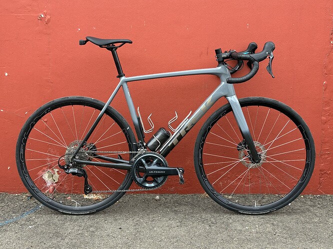

New Emonda ALR, slowly getting it in order. Stream of consciousness review:
  • Huge downtube hides my cage doubler perfectly. Just need to paint it black now
  • Swapped the 105 crank for the warranty Ultegra unit that King Braden processed for me :two_hearts:
  • Seatpost is mostly bad, two bolt yoke slips and needs extra torque. Ritchey 1 bolt incoming.
  • Bars are interesting, wider at the drops but not flared out, which I like a lot. Bontrager touch points constantly surprise me with how good they are for OEM stuff.
  • Fit is more aggro than the previous ALR I owned. Longer reach + big shifters + 80mm reach bars + long torso and not flexible = 70mm stem.
  • Geo is otherwise the same, nearly crit/track which is fun.
  • Quoted tire clearance is 28mm but measured is at least 35mm. 28s on there now, but I’d put 30/32s on in the future.
  • Shimano shifter bodies are the worst bike product but I’m trying to be content. I was ambivalent about 12s but its a lot better than I expected.
  • Hydro not giving me all of it. Modulation does nothing for my neanderthal self. I probably didn’t bed the pads properly since the bike shudders under certain braking pressures.
  • To do list still includes wiring up the IQ-X (which will hang under the K Edge), installing my old stages arm (just got replacement bolts), trimming cables and hoses so the internal entry is at the front of the head tube again, properly sized chain so I can big/big (oem crank was 50/34), and getting cleats fit (which will raise the fit prob 1cm)
All in all, a good bike.

Is that blinker stock ?
No, but it is a Bontrager light and mount situation. I really don’t like how far it stick out but it’s handy for walking the bike. 3d printing a tucked mount is something I keep thinking about
All in all it’s a good bike, I’m disappointed they made the new ALR models with headset cable tourism, even the internal cable routing for the RD is not the most elegant especially when changing housing.
I was Aethos 1 curious but a friend said it felt dull. Then they made the aethos 2 and fucked it up. I guess a x2 Crux is the only other S option.

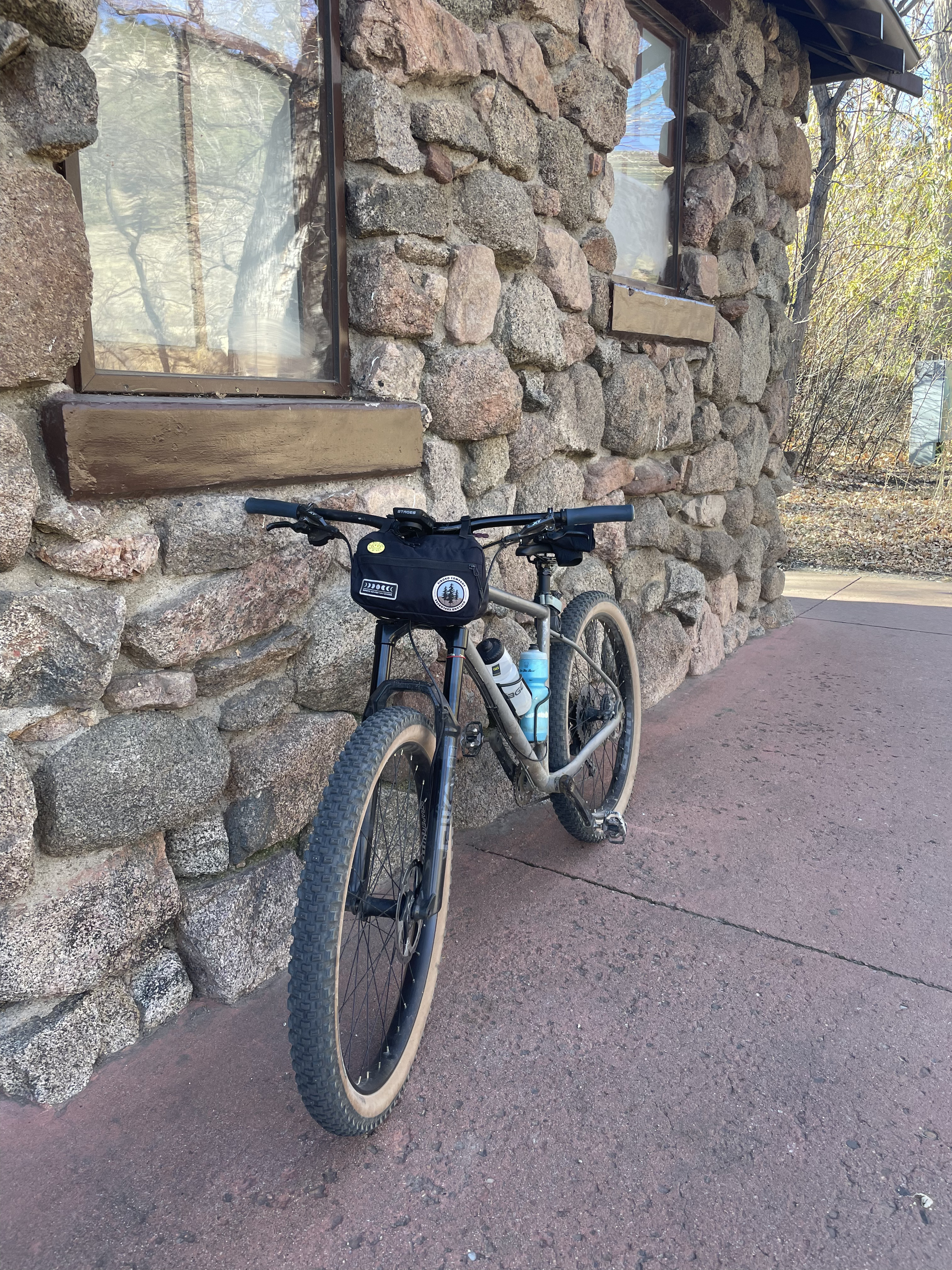

Been riding the pine mountain a bit more this fall
Still really need to swap to 29" wheels and some lighter tires
(My friend took this photo so you all cannot see my driveside).

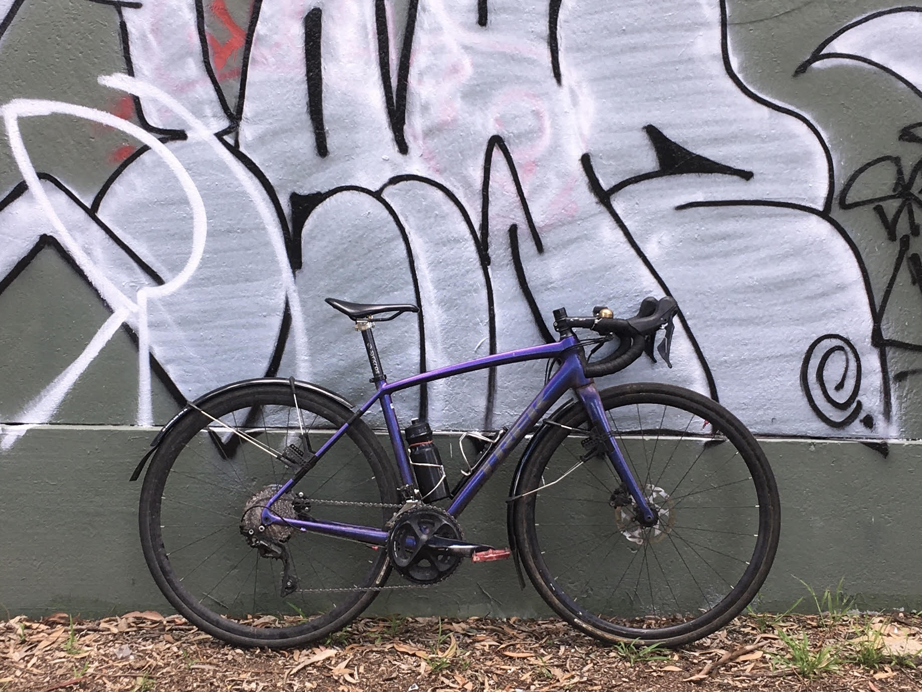

Also I’m not sure if they made improvements to the Emonda fork but it’s flexy under load especially out of the saddle side to side rocking. You might hear your rotors rub
So far so good. Legs on the new one are way deeper and straight.

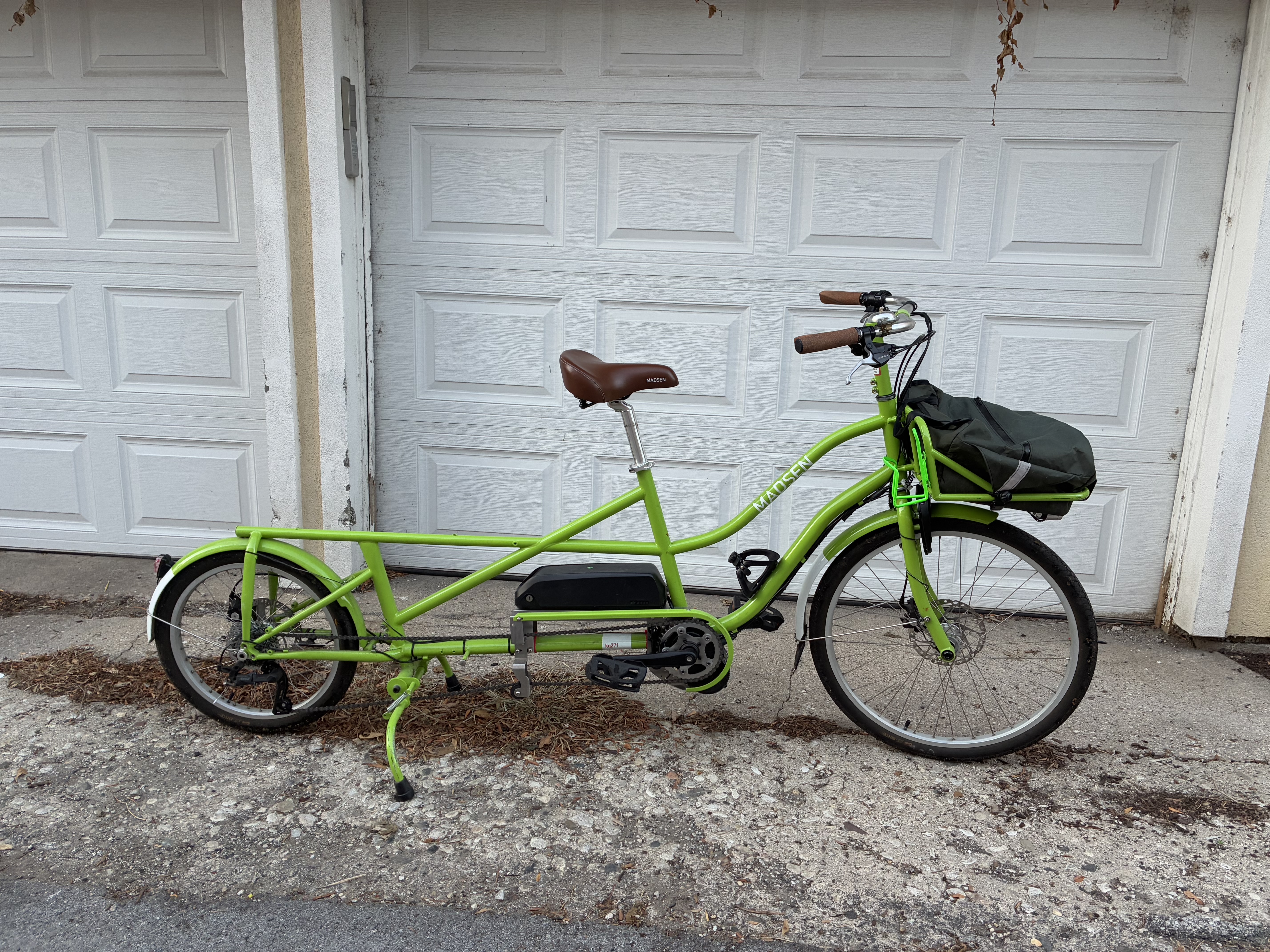

This thing will be a great platform for custom racks someday.(once the ebike stuff stops working and I strip it all off and turn it into a regular bike.)

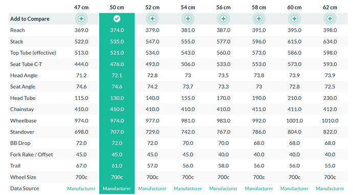

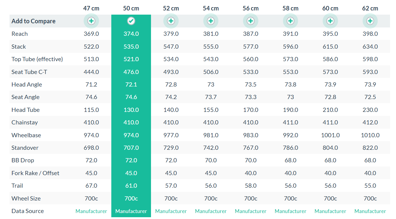

is this the smallest size they make?
if you’re talking about mine, it’s a 50cm so there’s one size smaller still
This is the previous model though. The new ones like chazzwazzer’s have a longer+lower fit across the board (H1.5 vs H2 geometry)
with that fit it just looks like a size down would be more appropriate
It’s possible, though the low and forward slammed saddle (if that’s what you’re seeing here) is the result of a midfoot position on thin flat pedals reducing leg reach and increasing effective setback by ~40mm compared to say, clipless with a more conventional cleat position. Looks very kooky, but not really anything to do with reducing my reach to the bars
