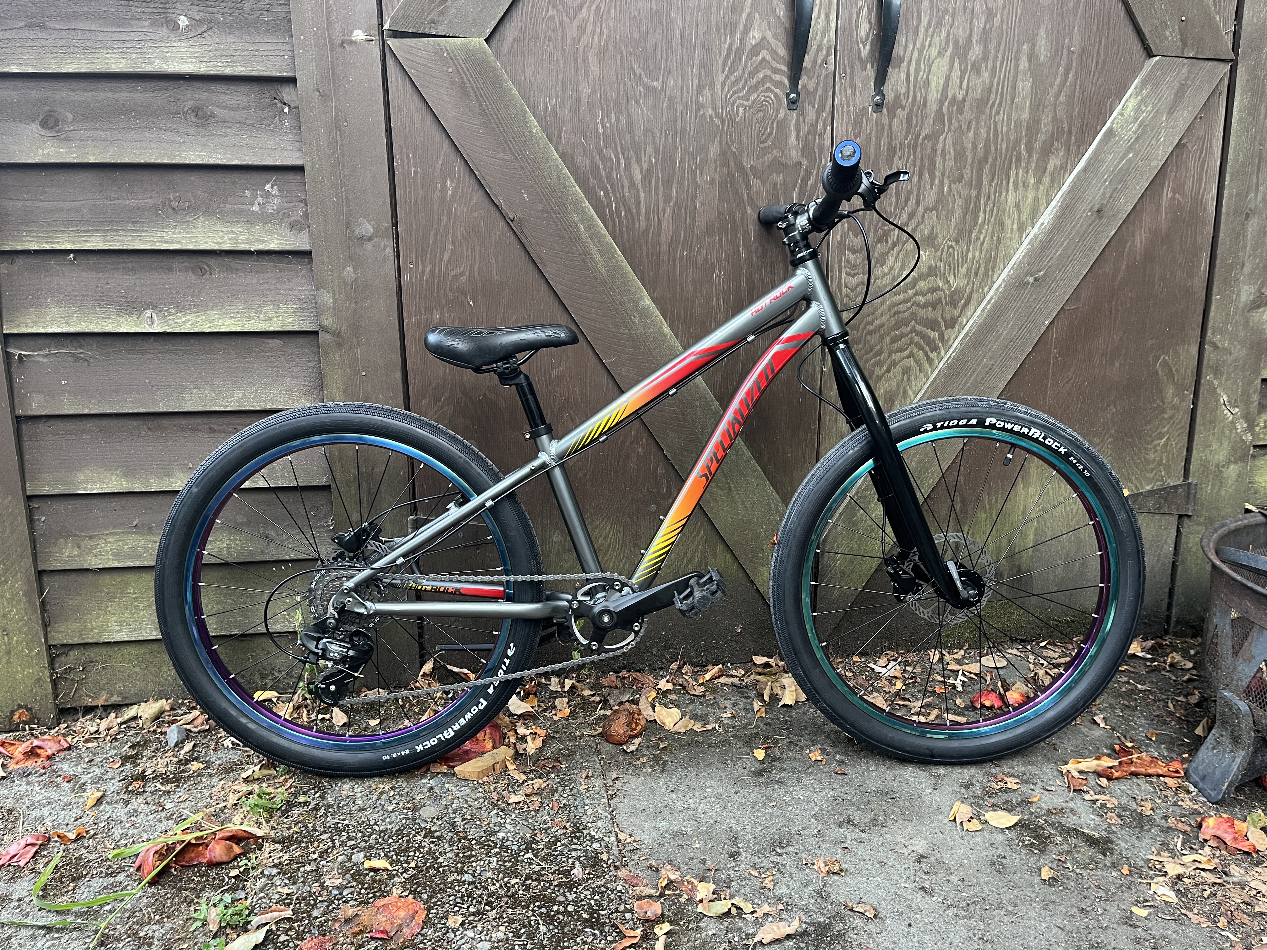

Mostly finished up the 8yo’s new bike (need to get some different grips) It was pretty fun as both kids helped put it all together.

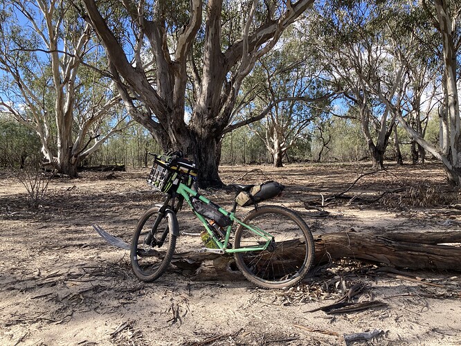

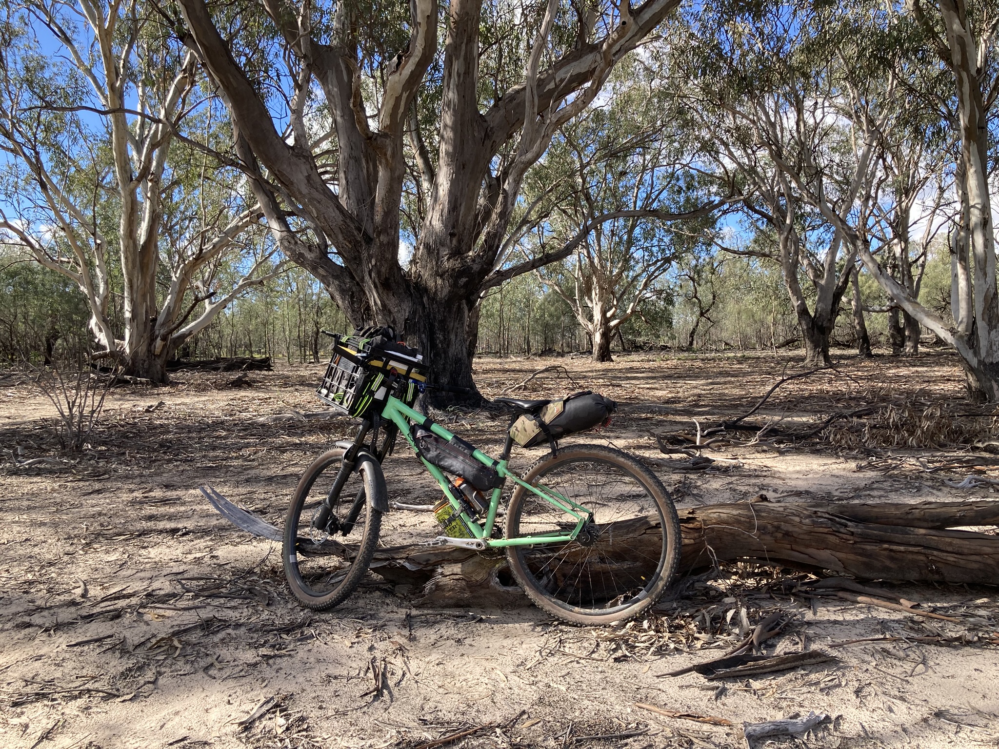

This is the aforementioned bike set up with a 6 bolt fixed cog in lieu of rear disc/brake for a recent week long semi-desert ride. I left the cassette side cogs on as a flip-flop bail out in case I really hated fixie mode, but didn’t end up bothering with it
Milk crate basket strapped to the handlebars/fork crown was rock solid and rode really well over bumpy 4wd tracks as sprung mass with 160mm of squish working below
