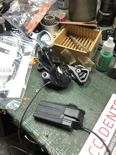

OK, I got all the di2 parts that should work, but when I push the shift buttons, nothing happens. I’ve got it wired up thusly:
Shifter
To A junction
To B junction
To battery and dangler
What am I doing wrong?

Are the cables securely clicked in
Serious q: do you have the dumb Shimano Di2 “wrench”?
You really need to click those dudes in there

Check your connections. God help me for saying so, but Mig is right about the Di2 tool.
First, is the battery charged?
Secondly, are all the wires clicked into the components? (They should make a little click when fully seated)
If you’re not even getting the a junction to light up, it’s possible that one of the above is not done.
You can also slowly assemble it; attach the battery mount to the a junction, then add the battery and see if the a junction lights up:
If this works, start adding components one at a time; first wire in the dangler, see if the a junction lights up, then do the same with the shifter. If all of this works, try to shift — if any of this fails, you may need to flash the firmware in the battery mount up to current versions (I’m 99% sure the firmware in the a junction & dangler is up to date, but not the battery mount and I know that a battery mount with original firmware just won’t work with anything else)
If your lbs is at all di2 literate, you may be able to get them to flash any out of date items to current spec (if you have a di2 programming interface you can use that + a windows pc to bring all the firmware up to date yourself). Failing that, you know my mailing address and l can flash them for you
Bro, external battery, external junction B, stem mount junction A, and a beat up 6870 RD is not current Di2 shit. No offense to Rudys issues, but Mig you might want to argue with someone else.

Have you downloaded etubes project and run diagnostics?
If something is amiss first thing is to confirm plugs are secure as mentioned. Then hook it up to the PC and etubes. If something is amiss you’ll probably know pretty fast. If you can’t “see” the whole system, it should be pretty evident if which wire or junction is the offender.
Good time to run a full firmware update.
My guess is it’s the battery or battery holder though. I’ve seen a lot of external ones shit the bed.
All of this stuff is technically still supported but a bit long in the tooth. So could be a few areas.

It’s probably cheaper to just run by the lbs and ask them to flash it. I’d guess that if anything has out of date firmware it’s the battery mount, because that’s one thing where if the firmware is old it will just sit there like a bump on a log.
What’s the part number on the battery mount? External battery mount contains the chipset. If said mount has outdated firmware, you’re in a bad spot.
Grab the charger. Get E tube from shimanos site. Plug it in. Update all the firmware on every component. I have seen where old battery mounts did not speak well with the newer A junction box. The A junction box that used that battery mount was the hardwired version without a charging port.
I agree with @Elliott - It’s all outdated di2 from different generations.
Yep. And make peace with possibility of replacing your battery mount and/or battery.
But none of those components are outdated. The only component that’s from a non-current group is the dangler (and maybe the battery mount if it’s a bmr1 or 2; the dn100 is, of course, current, but pointless if it’s on a 1x rig without the bluetooth interface wart) and it doesn’t matter because they all interoperate and can have current firmware installed.
