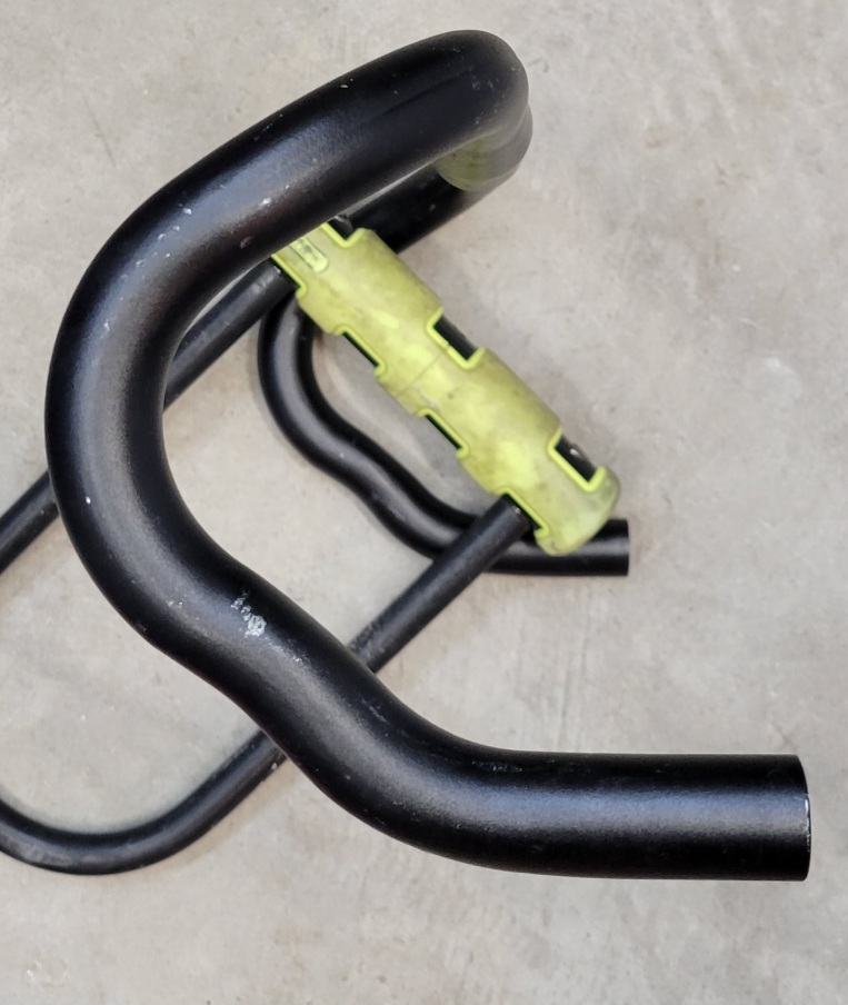

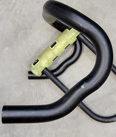

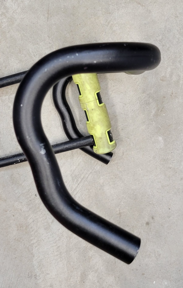

What are these weird bars made for and how are they supposed to be positioned? Are they for those bikes ridden by people who are afraid of derailleurs? I got them for free and they’ve been sitting amongst my bike junk for quite a while now. They either get used or get put in the donation pile today.
Fify
the garbage
The much maligned and well hated ergo bars. There’s honestly no good position. Trash em.
beat me to the most correct answer
Those are from the era of “ouch my wrists”

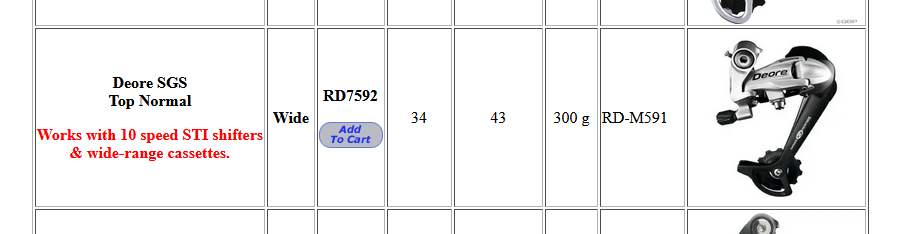

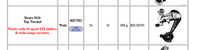

Solid as hell. No shadow nonsense. I like the eariler gen 9 speed ones, which work with 10 speed road shifters. Looks like these do too. Mine shifted into a 36. Not sure what the reference to wide range means there.

If you want to do the MTB derailleur setup, spend $4 more and get the RD-M8000-SGS instead. I’m running one of these on a 44/28 x 11-42 setup with that exact M11 Microshift shifter.
