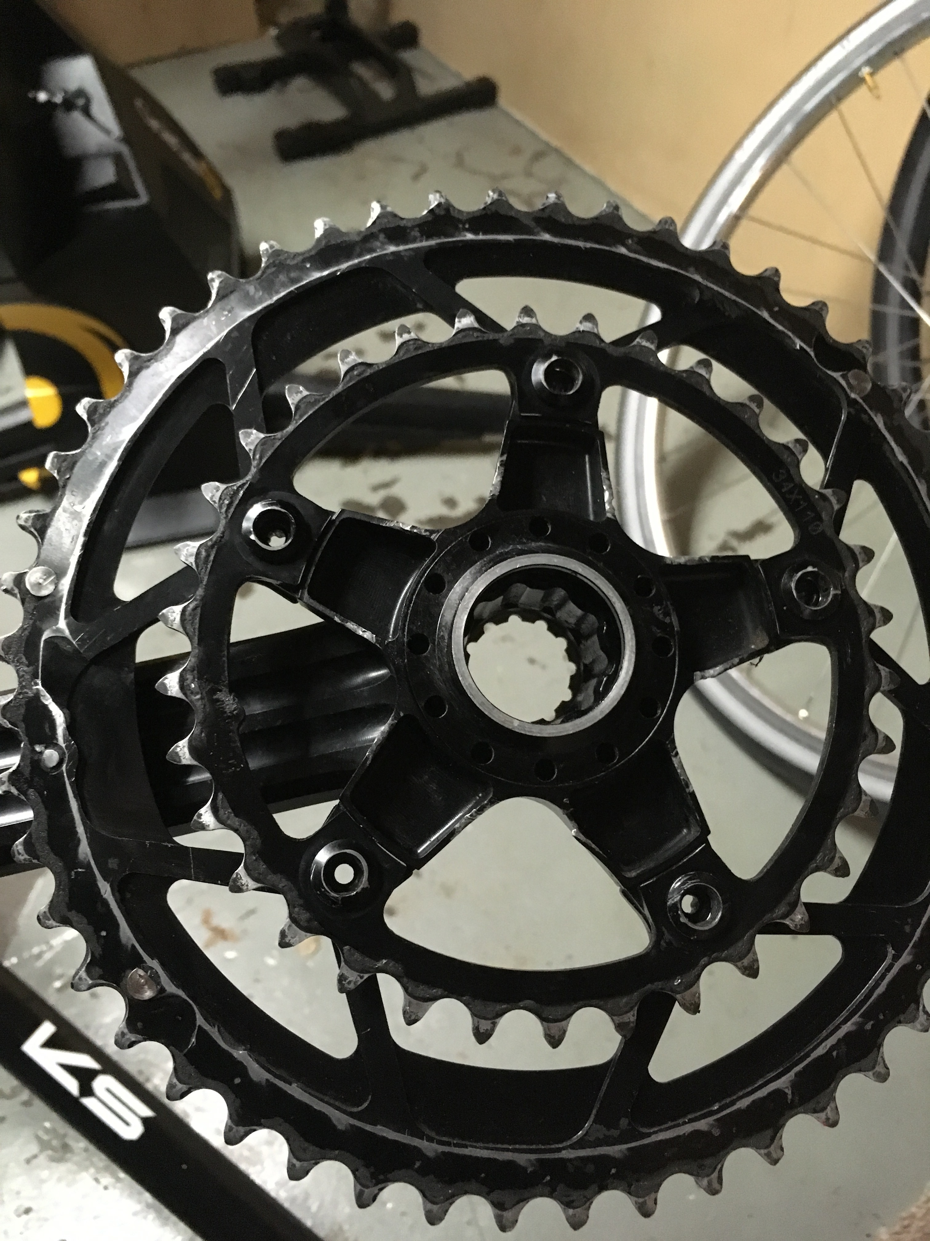

I’ve emailed the seller about a refund. Wouldn’t have bought this had I known it required a lockring and spider change, was told just need a bsa30 bb.
Or I could buy a plastic frame
@EndpointBraden thanks for the offer on checking parts. I’ll let you know tomorrow if I can’t get a refund
It’s not the spacing that’s the issue.
The bbright specific locking is the thickness of the standard lock ring and the drive side rotor spacer for BB/PF30 for their 30mm spindle cranks. Swapping them exposes enough spindle for use with the BSA cups.
The issue is that the bbright spider is shaped to sortof envelope the lockring to give a smoother looking transition to a BBRIGHT frame. Rotor is telling him the BSA30 cup can’t fit inside the bore of the spider because the cup is too large in diameter (not thickness).
I remember monkeying around with some bbright spiders a few years ago and thought the cup did fit inside the spider though.

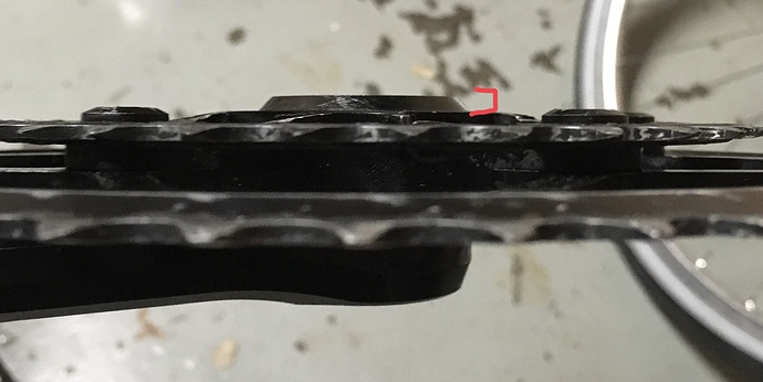

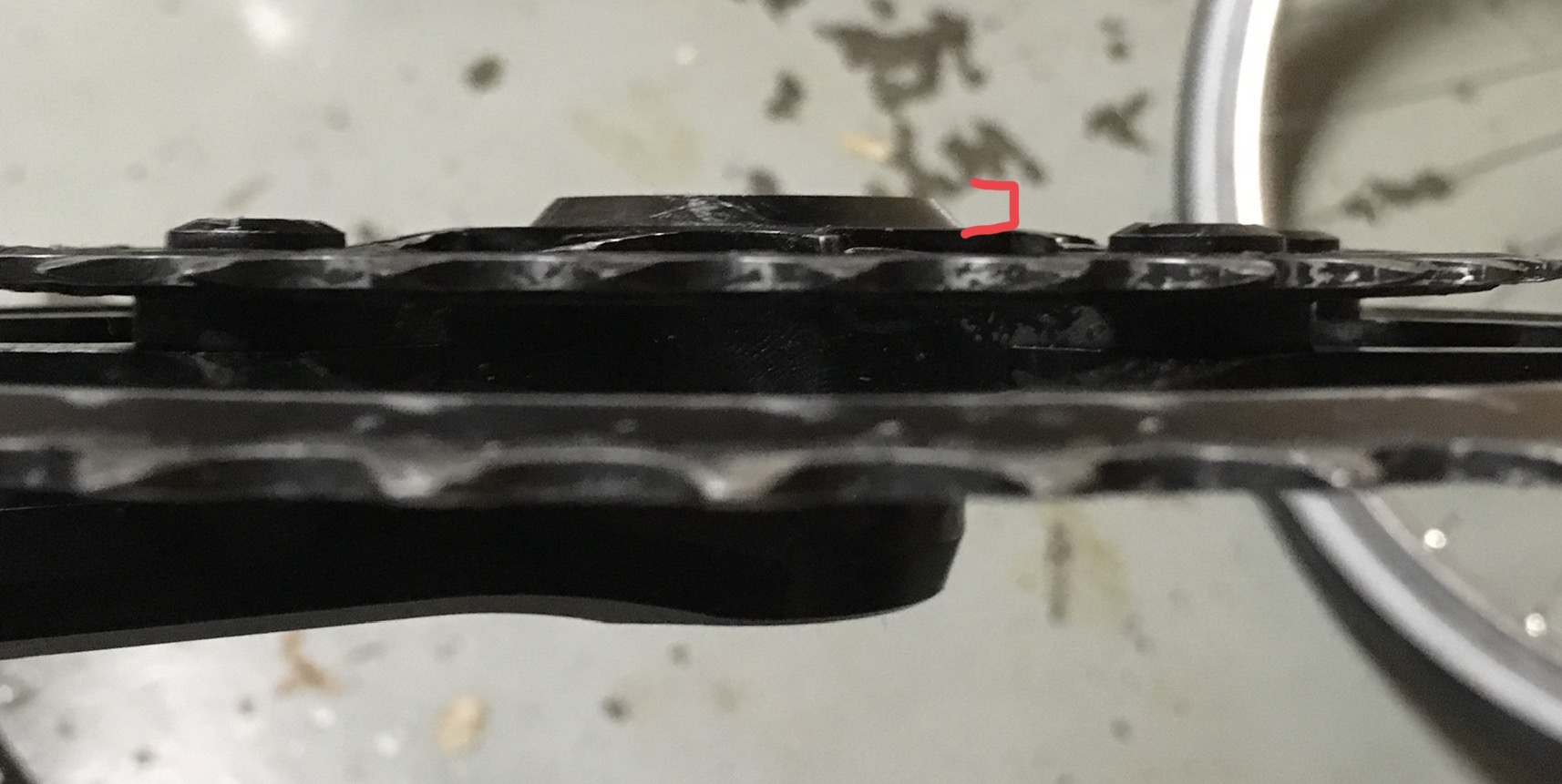

Yeah that’s what I figured is happening here as well. The lockring that’s present appears to be same diameter as the bsa30 cup. If I remove it there is still the issue that there may not be enough spindle.
Even if this is ground down (as would be the case with a standard lockring) I don’t think there’s enough lateral space for the spindle. This spider looks quite wide.

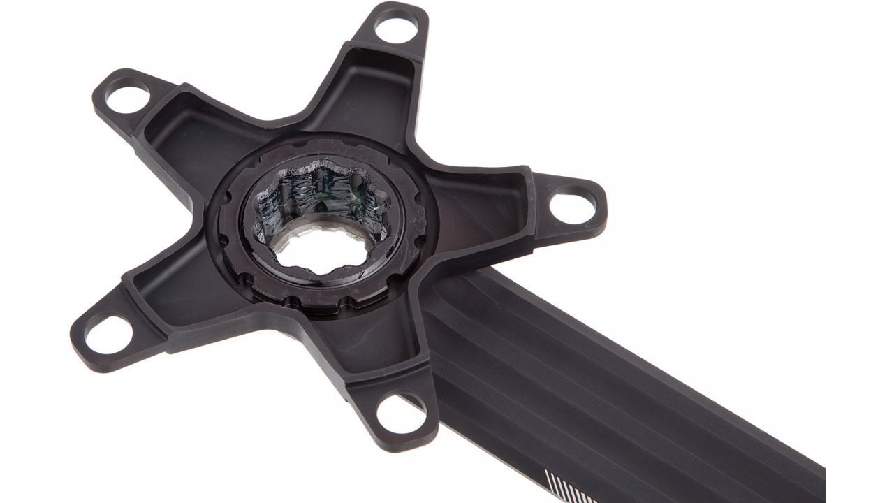

I found this photo
https://cdn.shopify.com/s/files/1/0716/7793/products/Rotor-3D-Compact-Kurbel-schwarz-rot-175-0-mm-39745-117146-1481264362_2048x.jpeg?v=1536056844
The BBRIGHT lockring itself is more than 11mm thick. The part of the BBRIGHT spider that sits between the crankarm and lockring is the same thickness as the normal spider. This is how one can remove the BBRIGHT spider and run something like an SRM or Power2Max power meter in place of the spider. The BBRIGHT lockring just act to integrate the standard lockring with the BB/PF30 spacer that is used on the drive side of ALL 30mm spindle frames EXCEPT BB386.
Once you get the lockring off it will all make sense.
Gotcha, thanks for that. It sounds like Rotor is saying this all won’t work because the BSA30 cups are bigger in diameter than the lockring, hence that spider doesn’t have enough, I’m going to call it, ID, for the BSA cup to fit…
Got my refund so back to my Shimano crank that seems fine I guess

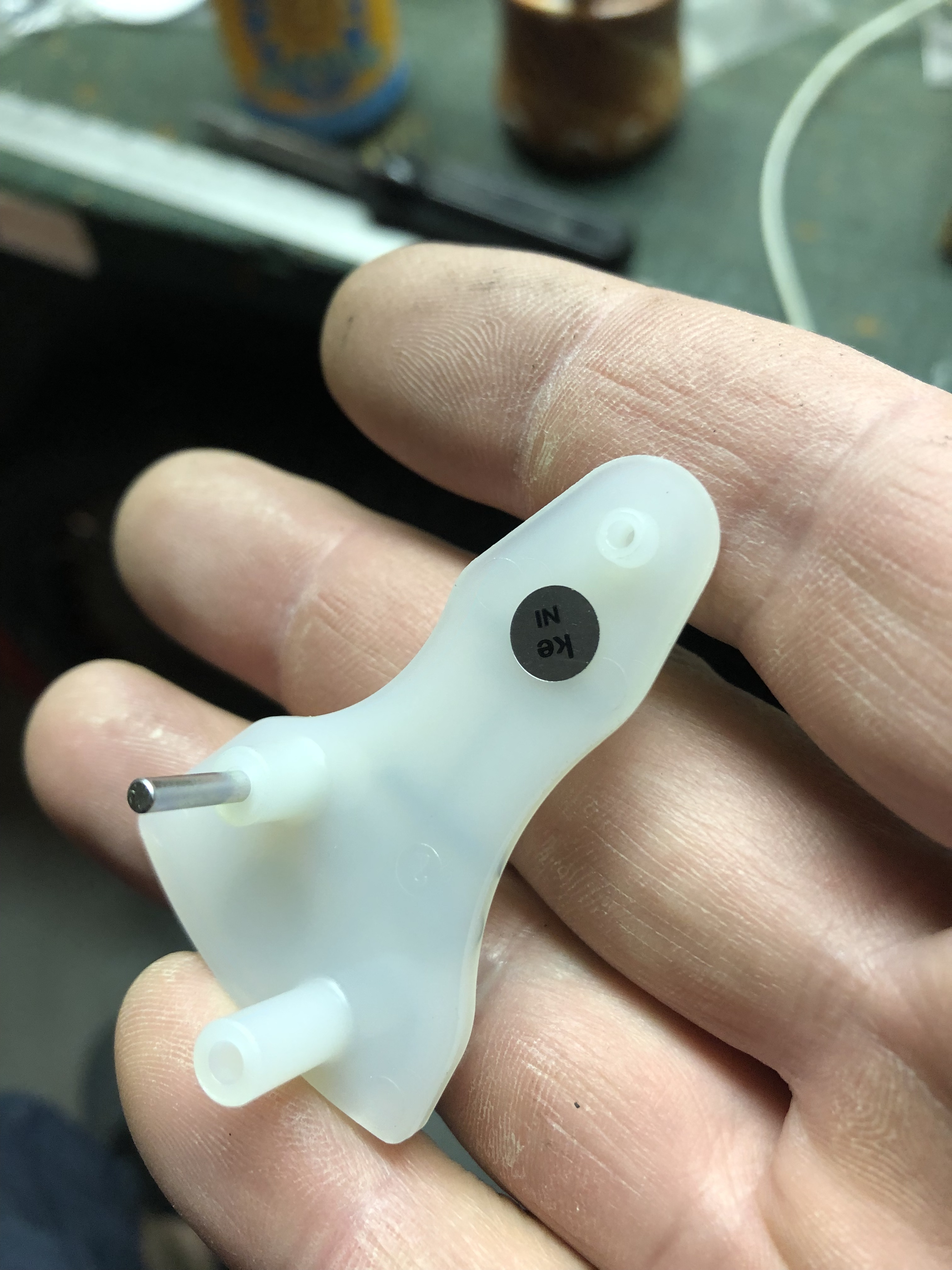

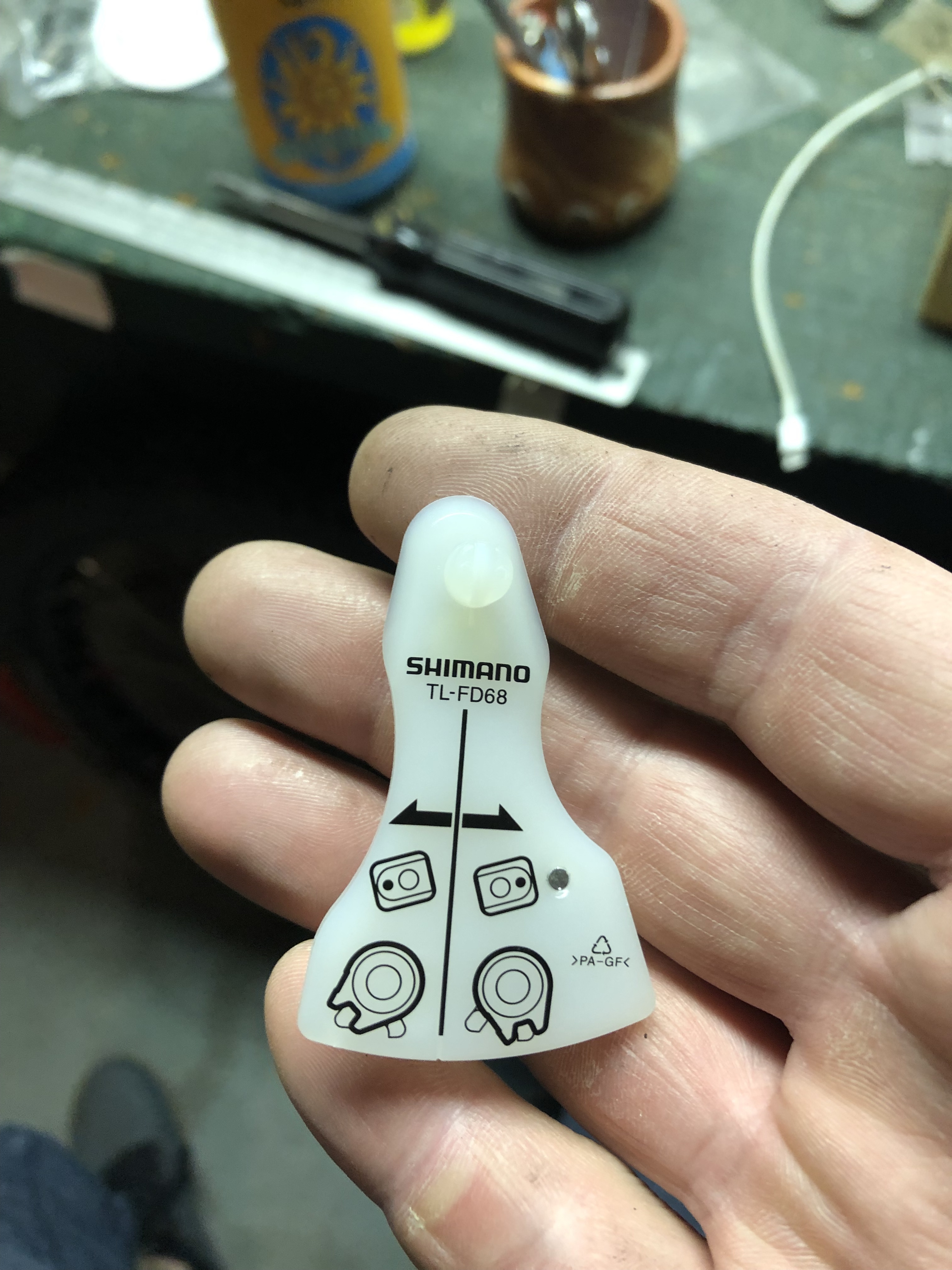

DQ: I found this while cleaning my workbench. What is it and should I keep it?
