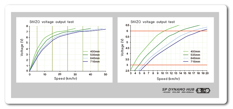

what makes it the 20" / 2.4W version is that it has fewer of the same magnets
ok I’m not a physics guy here, but: is using a 26"-28" dyno in a 20" wheel going to do anything bad to the wheel or lights? Capacitor?
I have a Kasai 20" on one bike and an Alfine s501 20" on another. Neither will ever go faster than like 15mph if that’s relevant.
Something something generators stators friction current
The hub will perceive you’re going faster than you are so you’ll generate more power at a given speed (hub overall efficiency should be same). But you’ll feel more friction at the hub so you’ll lose those precious watts
So to counterbalance I should occasionally take the pounds of accumulated garbage out of the cargo area of the bikes in question?
I was thinking about this because Shimano’s instructions specified that the s501 was for a larger wheel than I was using it on. I guess if the capacitor explodes on the cycletruck the cargo bucket will shield me, and on the longjohn my kid’s face will do the same. I’m invulnerable!
if the front light has a current limiter, won’t that equalize the drag? like if you turn the light off, it rolls smoother cuz the electrons aren’t being swizzled around right?
shorter lever though, so maybe you’d still feel it more despite the same amount of energy being moved to and fro
Not to the wheel. And most likely not to the light (if you can drop down a bluff at 50mph on a big wheel without your headlight exploding puttering around on a cargobike won’t kill it either) though the usual warnings about running just a taillight apply.
the StVZO labeled watts are at an arbitrary euro puttering speed
altering either the wheel size or the count of magnets will change the effective rpm, and thus the AC frequency for a fixed speed
the only result is that the output curve gets offset up and down:
Ah yeah that’s comforting.
