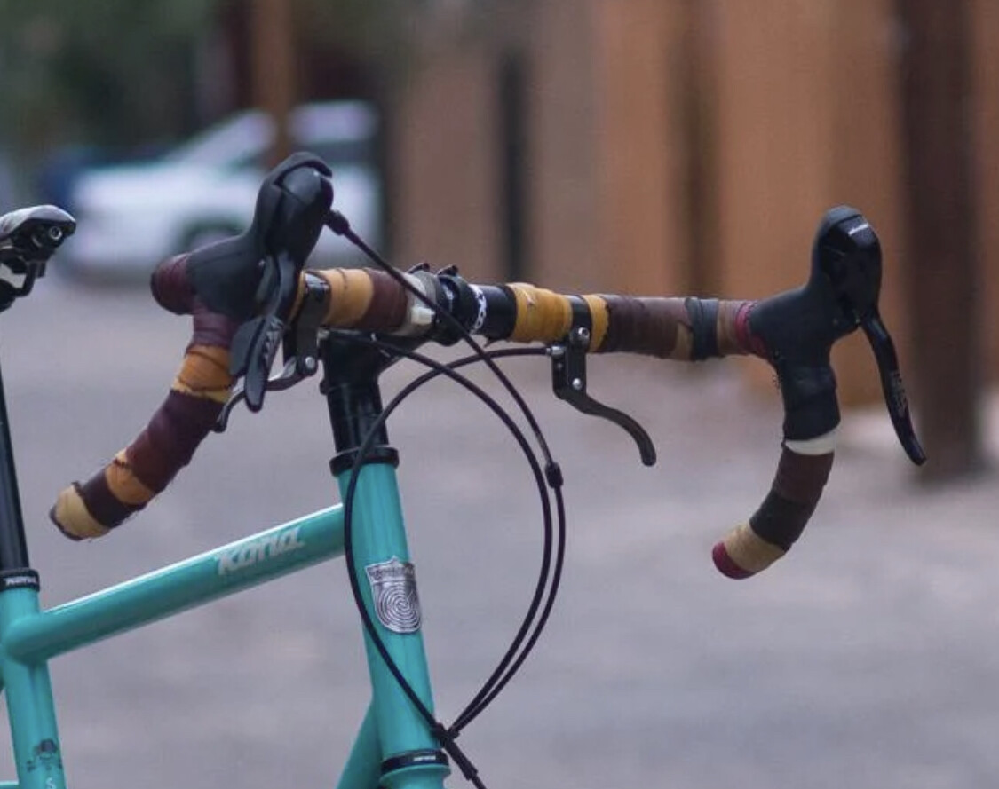

Also
Dafuk is going on here
Whats going on is that longhair romanceman was a mistake.
Maybe I overbelieved in tarckmajik.
