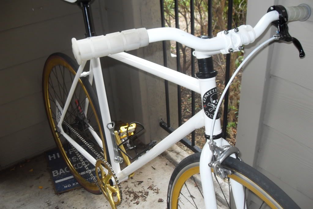

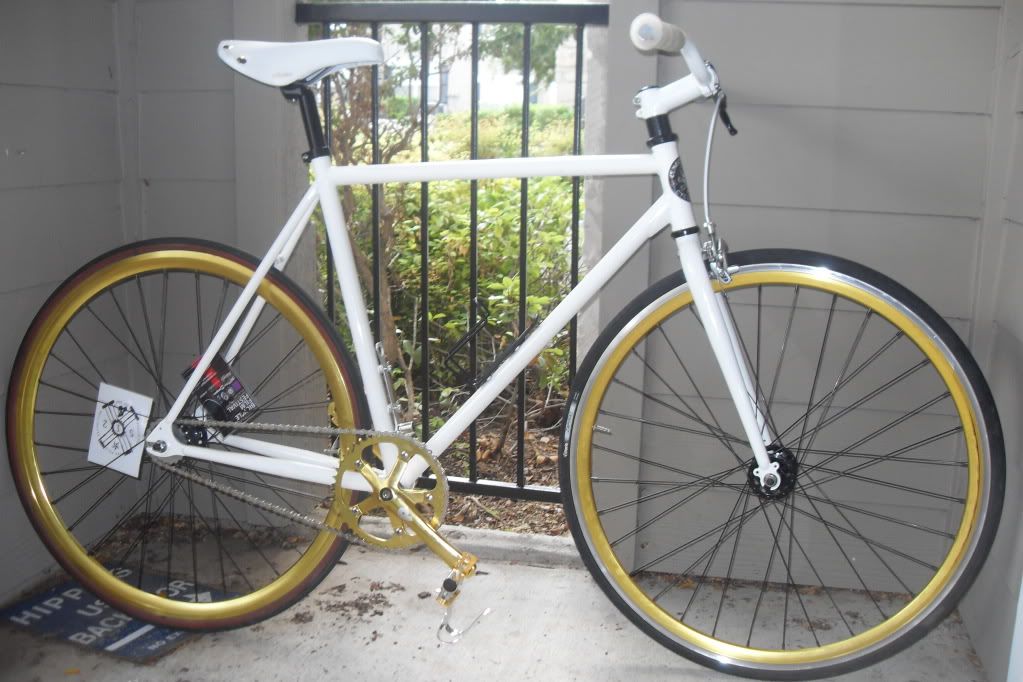

i wanted to make it a fun bike and i had the parts to do it, i think im gonna switch out the tires though, i dont think they’ll last, i even found a yellow computer i had on an older bike. :frowning:

So, these things take short reach calipers. Of which I have none. The new fork on my Angus as well, which means I’m riding brakeless with a bare cable sticking off to the side for a few days now. Of course I won’t be taking pics yet, but the bike turned out pretty good. Pretty, pretty good.
i clicked this thread hoping u had posted pics :frowning:
Pics or gtfo.
Finally built mine up! Best polo bike evar!
