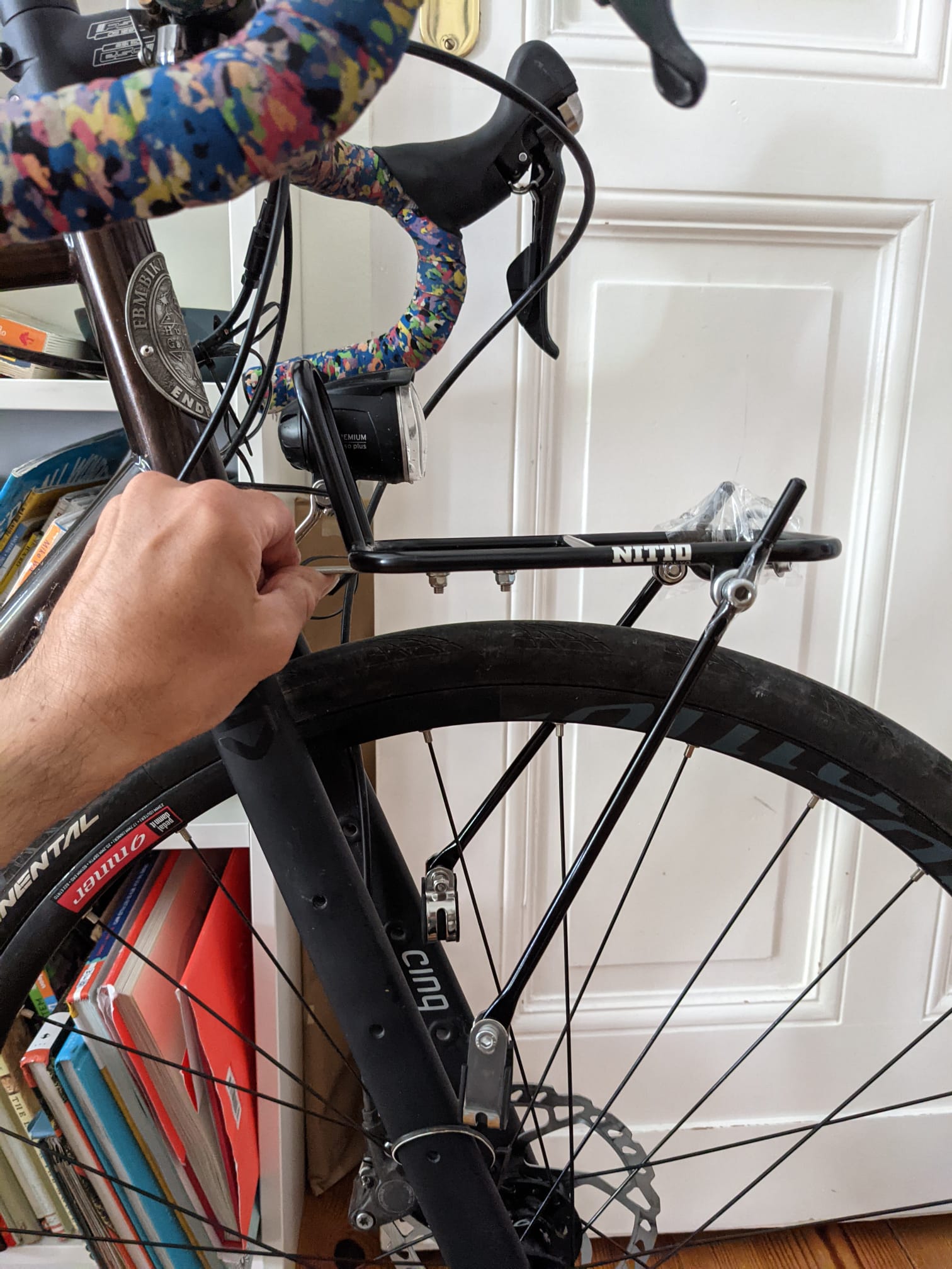

Can you mount a nitto m18 to Cinq fork?
@cheese CG from MD - XL HTA is 72.5, with Search Light fork (70mm offset) and 700x35 = Mechanical Trail 35mm (low trail), swap with Rodeo fork (40mm offset) 60mm trail. Issues with this dithering setup is Spork is internal hose routing. No.9 MCX Fork has external cable routing. Also I’m thinking out loud to myself
Yeah it looks like it could work.
but
there is no experience of loading the hole which is intended only for the lamp holder.
So any damages caused by using the fork like this is no warranty.

Ok, so the light is cantilevered out over the front of the wheel, so the forces are going to be twisting. The rack is cantilevered out over the front wheel, so the forces are going to be linear compression as it tries to rotate around the fork mounts. Unless you’re carrying bundles of firewood or cases of beer I can’t see how using a properly installed front rack is any worse than a crown mounted light.
you aren’t wrong. I’m sure would have been fine.
But I got pissy thinking I needed to babysit a fork on a steel adventure bike. Just something else to worry about. So I took it as a sign I was headed the wrong direction.

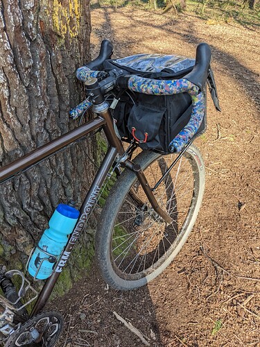

HY all this new DayRuiner chat inspired me to get back to the roots. Re-installed H/G fork and Milkcrate rack this morning and snuck outside for a quick afternoon underbike in the woods. Steel fork felt great!
