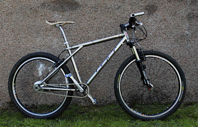

done by owner. originally meant for gears
single speed model made by gt, still appears to have vertical drops?
etc
