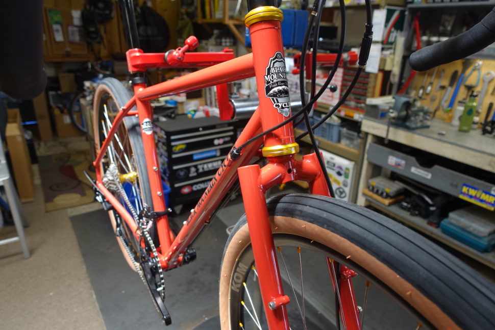

Adventures in carbon garage tinkering: http://www.regularcycles.biz/
http://forums.mtbr.com/frame-building/show-tell-monday-milestone-carbon-lugs-909417.html

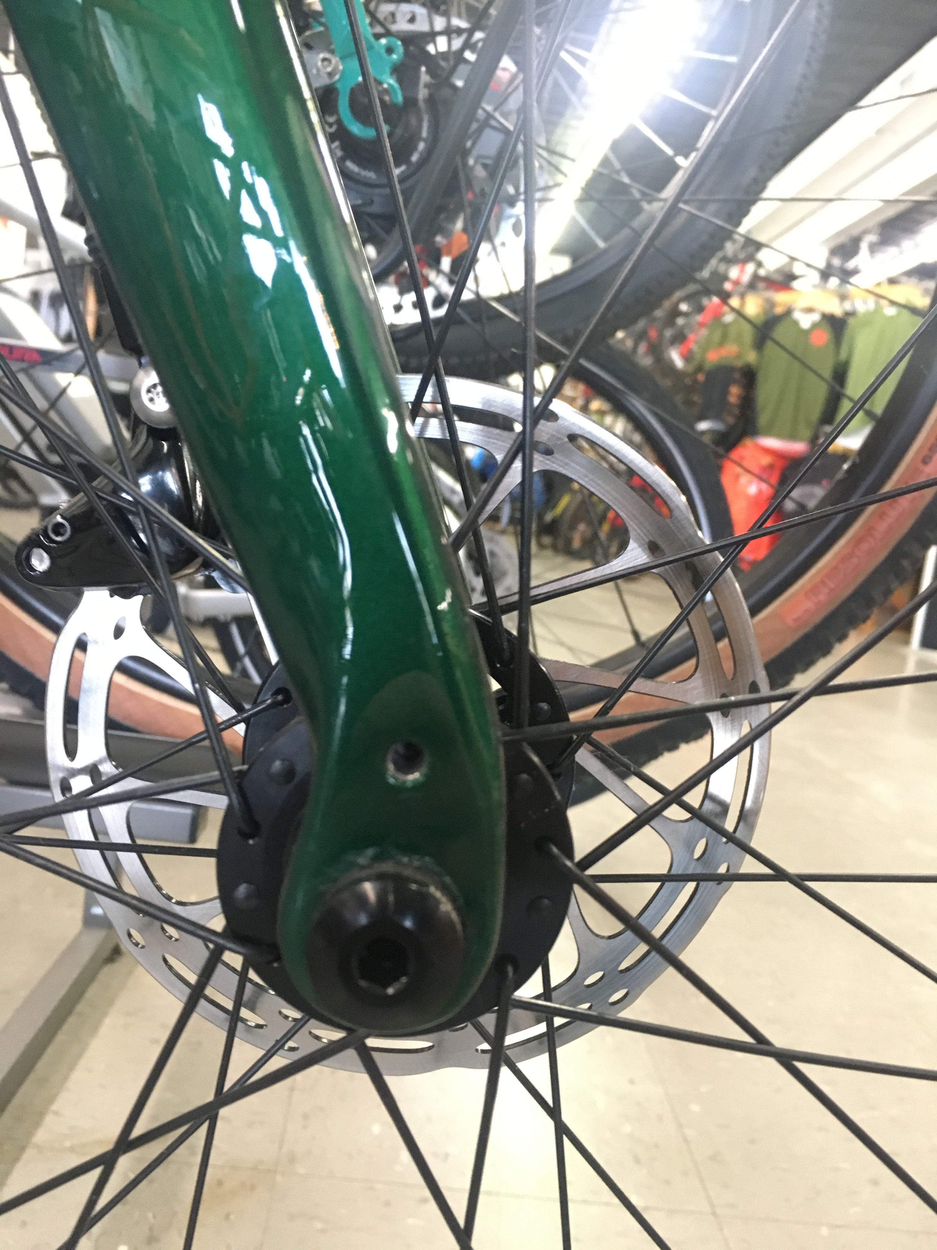

The BMC road plus is 60mm offset but I don’t know the A-C. Head angle is 72.

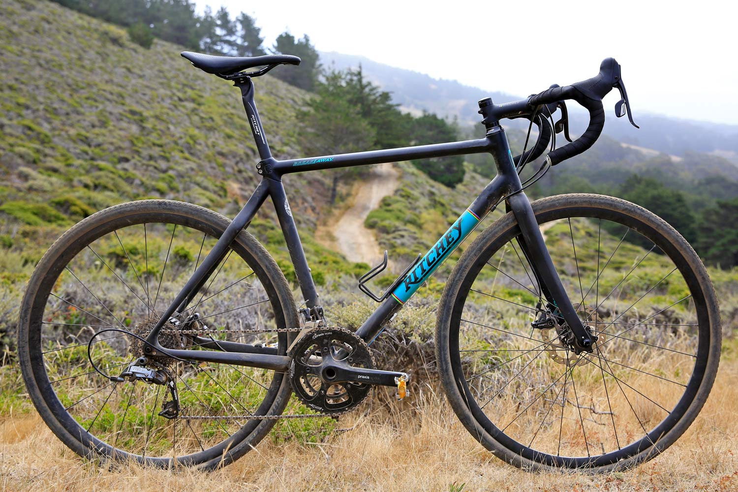

I’m gonna shoot for something not unlike this ritchey fork:

That BMC is 60mm offset and never a mention of low trail.

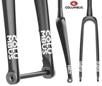

Something like hybrid between what Columbus is doing to offer two rakes on the same fork and what Norco does with their gravel fork?
Blades sweep forward enough to hit 65-70mm of rake but use a similar dropout shape to allow for a rearward position at 47-50?
And that puts a 72° HTA into a pretty nice spot where it gets a bit more nimble but has enough trail so it doesn’t start wandering after a long day riding your no-rack bicycle. (72° HTA + 47mm tire => 48mm trail, 73.5° HTA + 38mm tire => 36mm)
