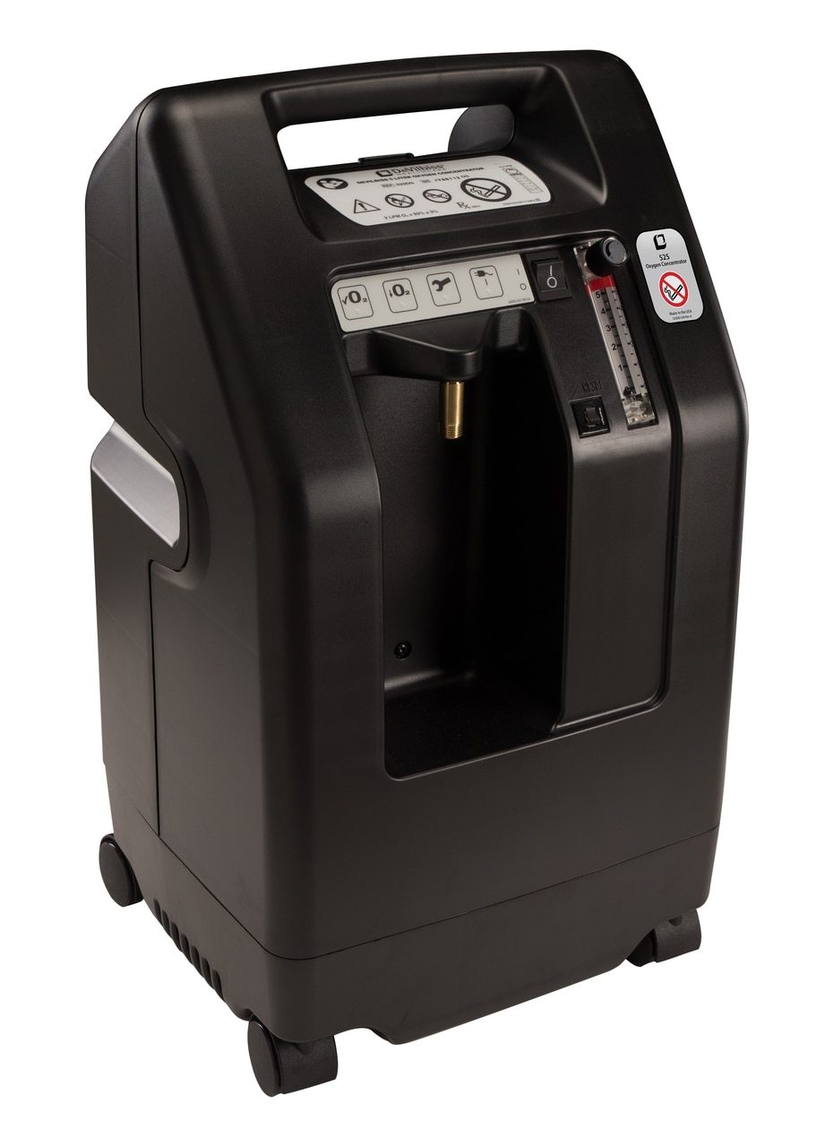

Looking at oxygen concentrators now, found a reconditioned one for like 500 which is gonna take some more time.

I got the rest of my gear on the way, found a reconditioned oxygen concentrator for $377
Edit: ok that wasn’t as easy as I thought. They want me to have a prescription to buy this machine. Ugh.

Got the oxygen concentrator too, I just had to fill out an affidavit saying that I’m replacing a broken or lost machine in lieu of a prescription.

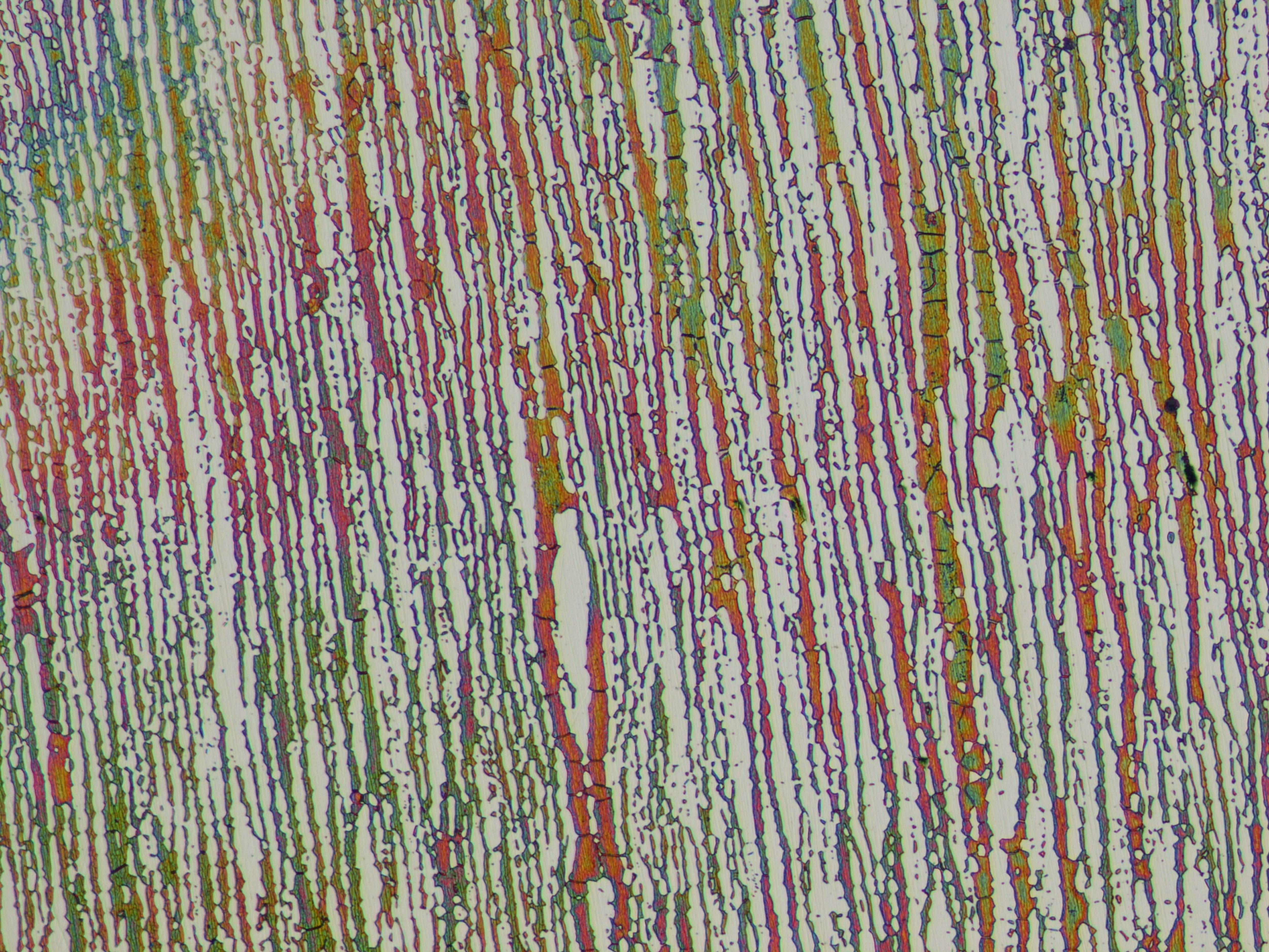

2205 duplex can be cold worked, but is not “built” to be heat treated for high strength, it’s optimized for corrosion resistance, with a butt tonne of chrome, but less nickel the austenitizing alloying addition) than 300 series, giving the “duplex” structure of Austenite (susceptible to SCC) and ferrite (not susceptible) meaning SCC can’t propagate.
It’s not really the kind of super high strength work hardening bicycle tubing (high strength to allow thinner wall tubes and hence lower weight, you’r stuck tig welding it and even then you’re probably gonna struggle to get the weld to pass a G48 (metalurgists inside joke and irrelevant to bike frames unless you really like riding through vats of boiling magnesiul chloride solution). side note my wedding ring passed a G48 test (i made it out of a left over passing test specimen) making it resistant to way more environments than i am).
is anyone actually making a hardtail out of 2205 or did some kind of offshore platform for ants wash ashore and you want to re-cycle the tubing?
and just because, here’s a nice duplex micrograph

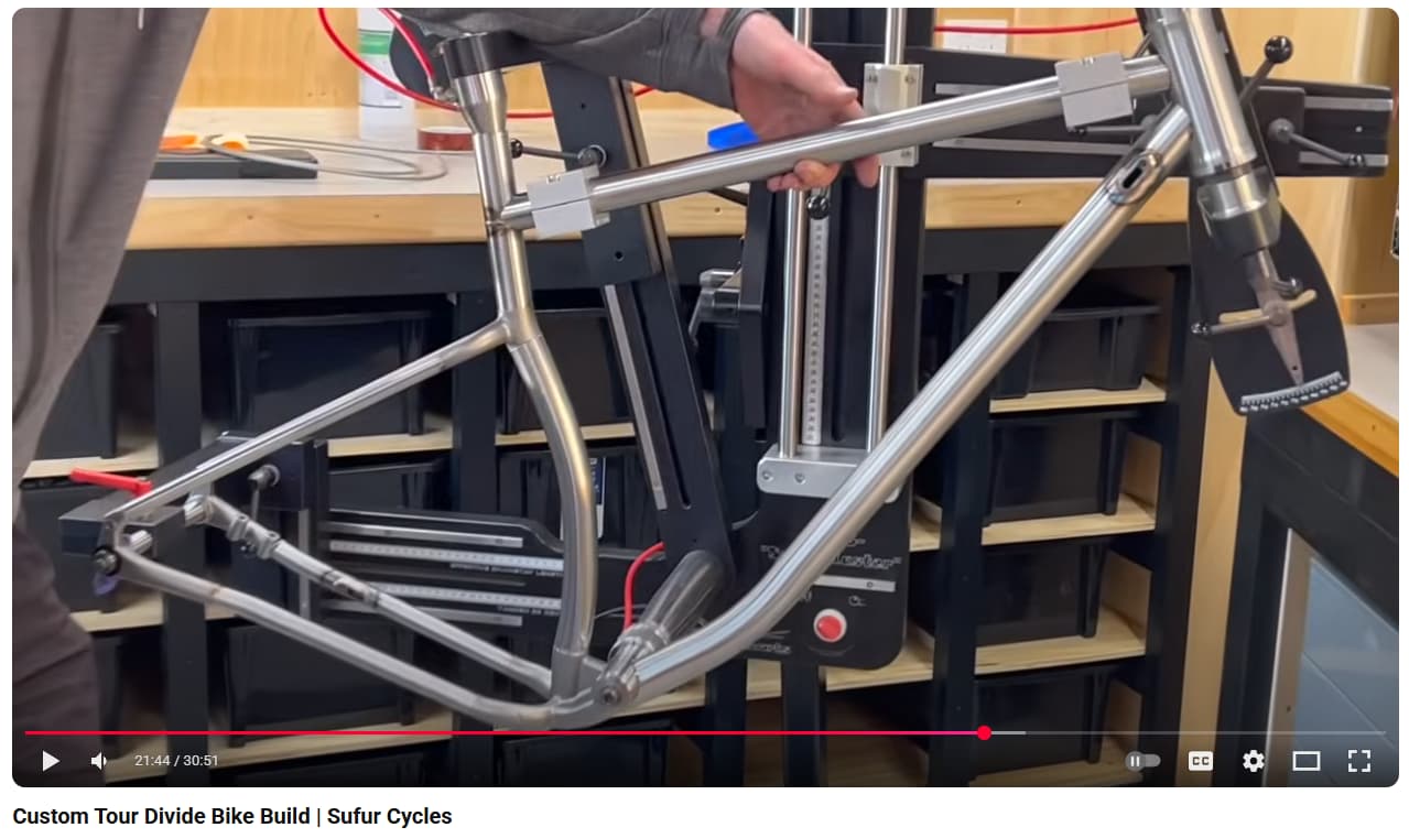

I’m doing a written interview with Rufus from Sufur cycles. If anyone has any questions about his ideas or build then let me know and I might be able to squirrel them in. I don’t know anything about frame building as such but its different enough to be interesting to nerdy bikepackers.
How did you get that bend in the seat tube
What is the weight of that frame
Are there bottle cages?
