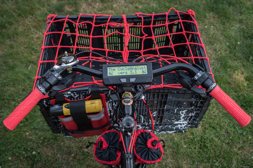

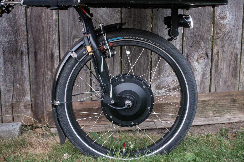

Like a Phoenix from the ashes the Cyclefab Cycletruck is born anew! Once cumbersome and sluggish the cycletruck cargo bike can now support its capacity with a 350RPM eZee geared motor powered by a 846 Watt/Hour Lithium Ion Battery. The Grin Tech Phaserunner Motor controller (cast in clear epoxy!) and Cycle Analyst heads up display were manufactured up in Vancouver Canada by some rad eBike nerds. I oped for a one of the latest torque sensing bottom brackets which directly translates your pedal strokes into acceleration which simulates the feeling of a super power. Looking forward to putting some commute miles and grocery runs on this new iteration of a bike that I picked up exactly 6 years ago today!
Did my first real 22 mile ride this morning and commuted to work on it. It was fantastic but still need to tweak some settings for the pedal assist, as of right now any pedal stroke ramps up to a set maximum regardless of how hard or fast I pedal. I can see some visual animation feedback on the Cycleanalyst that it is interpreting the speed and force just fine but not translating that to an assist ratio quite yet.
The Cycleanalyst has so many menus and options its a little overwhelming at first but I am excited to dig into it.
Currently have it set up right now with a + and - buttons controlling the max pedal assist allowed. I set it to 100-200W for cruising slow on bike trails but 10 different levels up to 500W max. I also have a throttle that is rarely used but can push the power up to 500-1000W for when I am on the road with medium speed traffic and approaching a steep hill. There were some long flat sections near the airport that used to be so boring but setting the bike at 500W I can still pedal along in the 48-11t and keep a constant speed of 23 mph / 37 kmh.
The one thing I noticed immediately is how un-aero this bike is at faster speeds.

Yeah, Iâm nowhere near the financially sound place to do this but I am definitely interested in juicing up the pink cargo at some point, specially if kids ever enter the picture. There doesnât seem to be any hub motors in the disc/thru axle flavorway though. A buddy of mine was selling his stokemonkey which would have been perfect, but I just couldnât swing it.

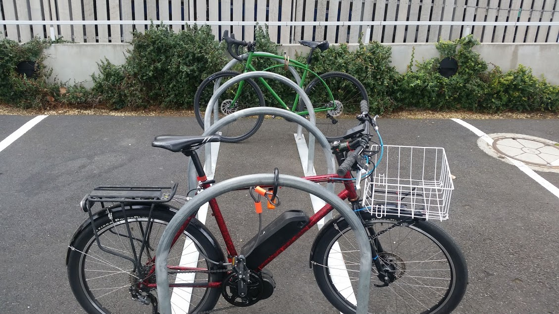

The one I built was red with Kona fork, fenders and flat bars with front rack /basket/bag plus rear rack/panniers. But it is mid drive, not hub.
Not the one?
that sounds like it! post a pic??

[quote=dorth]that sounds like it! post a pic??
and thanks John, Iâll check em out[/quote]
Away from home, donât have a good pic handy post phone rom flash⌠but here:
Thatâs more attractive than most purpose built e-bikes out there
