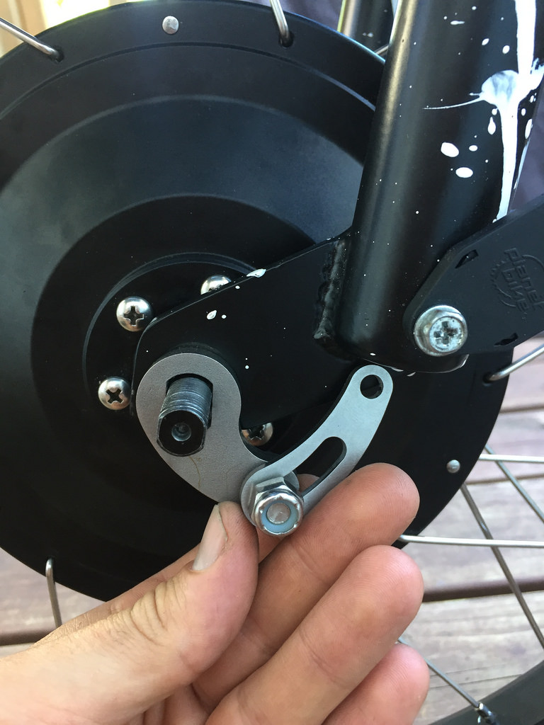

I got the thumbs up from Cyclefab to drill and tap the dropout plate for the torque arm.

I’m a little underwhelmed with how loose the Grin Tech torque arm is on the eZee axle but dropout is nice a snug so this will just be a security measure. Going for first option here, directly attached instead of using the fender eyelet as designed.

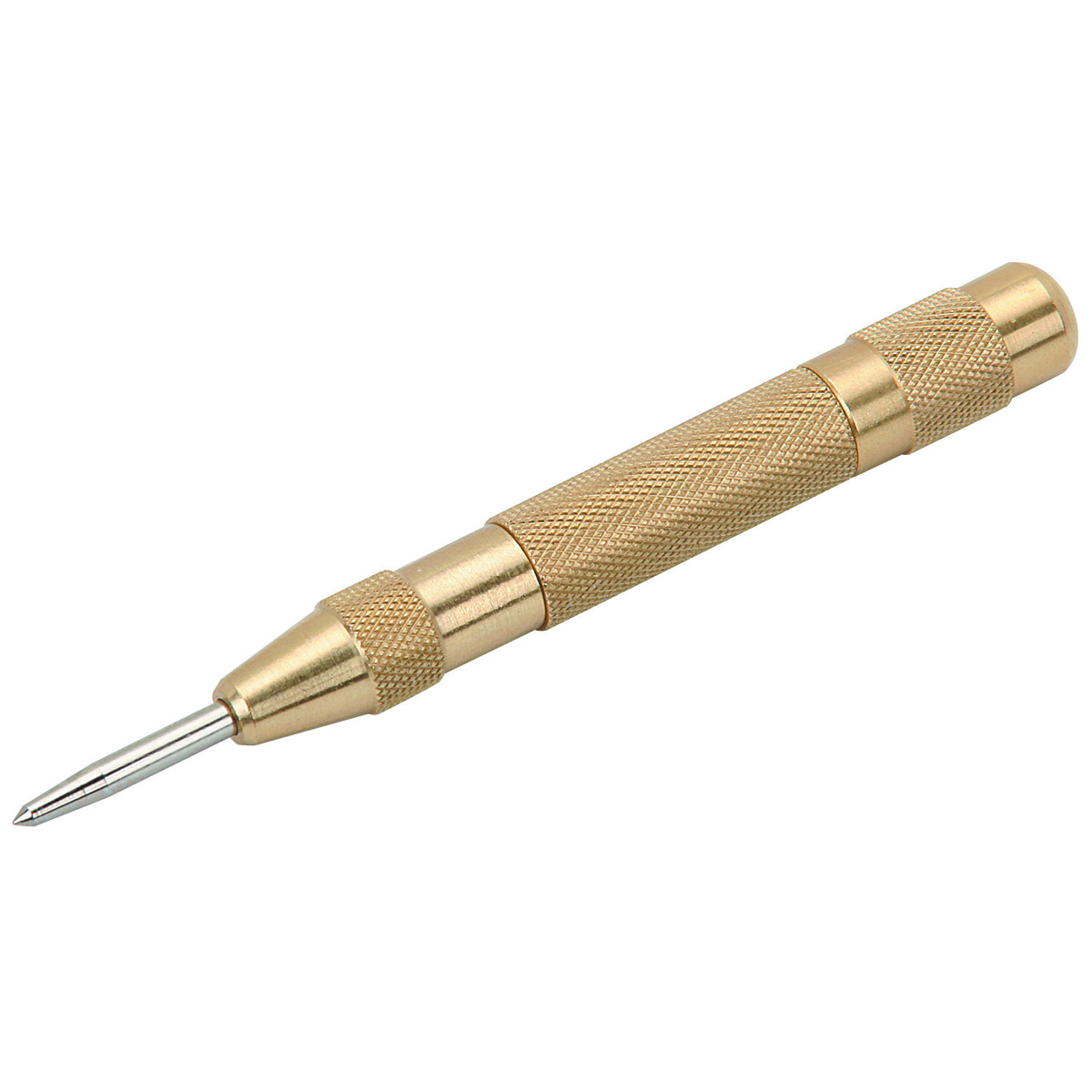

Any recommendations for the best way to punch the hole to get it started.
Have one of these but not sure how I would get it perfectly centered

that punch will get you close enough. If you wanna use that, I’d start by marking the center with a sharpie or something first, then punching. Eyeballing will be fine. It’s way easier to eyeball a punch than a spinning wandering drill.
The best way would really be to use a transfer punch, but I’m not gonna talk you into spending more money just to drill one hole in a dropout.
Oh neat, never heard of transfer punches before.
Looks like HF has imperial but no metric for 11 bucks: https://www.harborfreight.com/28-piece-transfer-punch-set-3577.html

[quote=Andrew_Squirrel]Any recommendations for the best way to punch the hole to get it started.
I also have a step bit that might be useful[/quote]
Come by I have a set of transfer.punches you can borrow
I’m missing something? What’s the point of all those different size punches? They all seem like they have the same size point?
