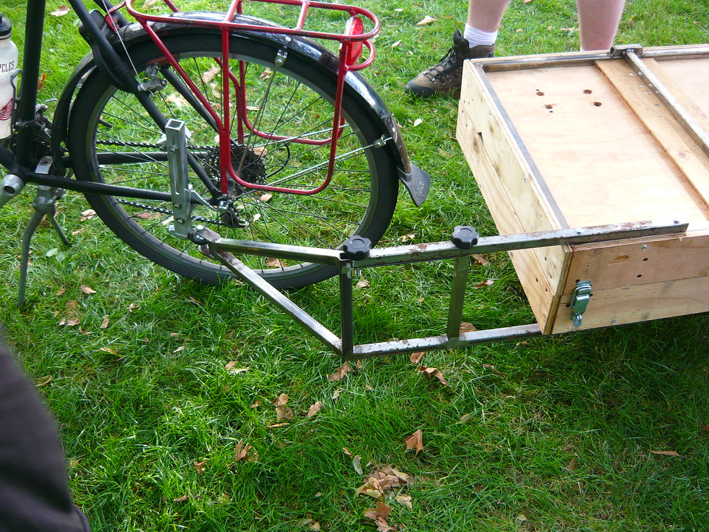

It’s much stronger than any other trailer on the market, which all tend to have dumb shit like frames made from 80/20 that flex till the bolts start backing out, 16" wheels that amplify bumps, single-sided axles that get bent out of true and leave the wheels vulnerable to bollards, and plastic skyway mag wheels that fold under cornering forces.
The hitch is ingenious too — it attaches to your chain and seatstays using specially-sized clamps for different tube sizes, and holds a shouldered spherical ball joint in an oversized brass bushing. No jackass turn sandwichery like seatpost mounts, special quick releases, hose clamps, caster wheels, pneumatic quick-disconnects, or for fucks sake lashed inner tubes.
I’ve pulled 400 pounds of cargo in it on dirt roads too rough for cars, and it was unfazed. When the weakest links in your design are the 36 spokes and the pressure limit of the tire sidewalls, you’re doin’ it right.
Fucking fuck. I want one.
any close-ups of the hitch area?

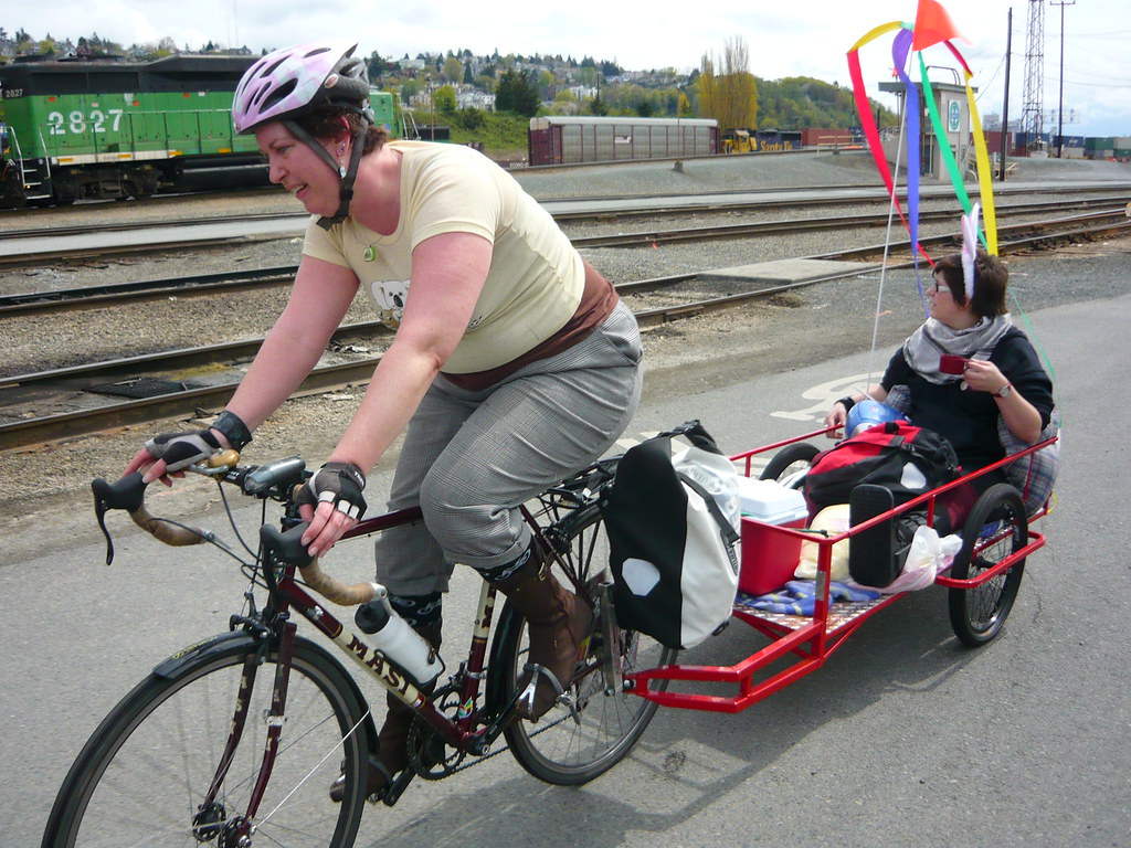

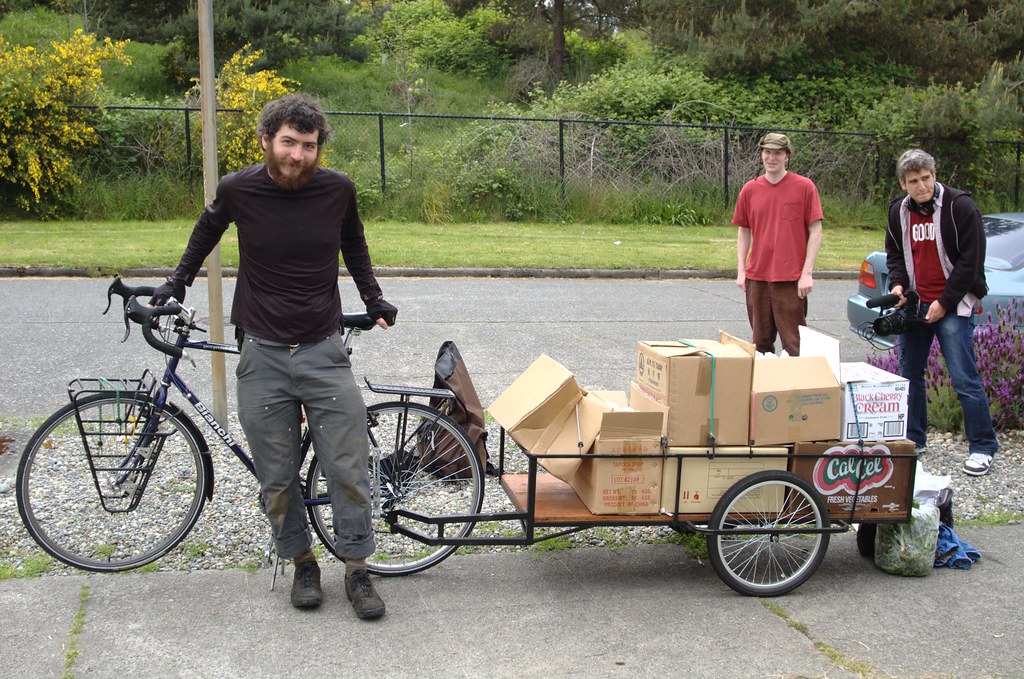

Found these, xlarge version might show you what you want.
Imgur
Imgur
Imgur

How does the elastomer tongue work out?
Seems like it uses it for the lateral travel that lets you lean the bike, sketches me out.
The production Colin trailer is 40-45 pounds empty and balanced well (with a few pounds of hitch pressure). Pulling it empty you don’t really feel the weight, the effect of articulation over bumps is much more noticeable.
