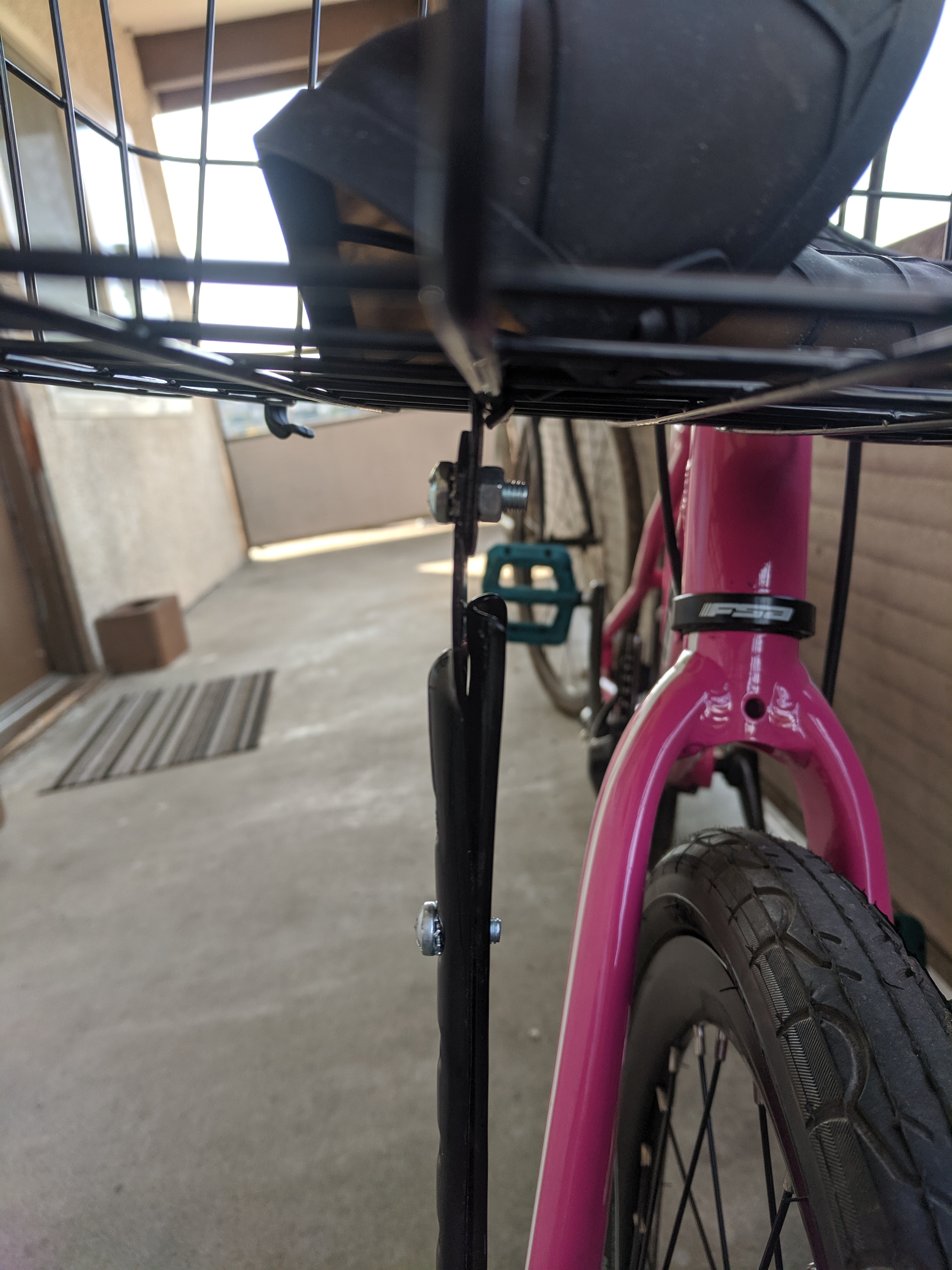

But the way this basket is connected to the bike is way more sketchy than any way this thing could possibly be designed in the first place.

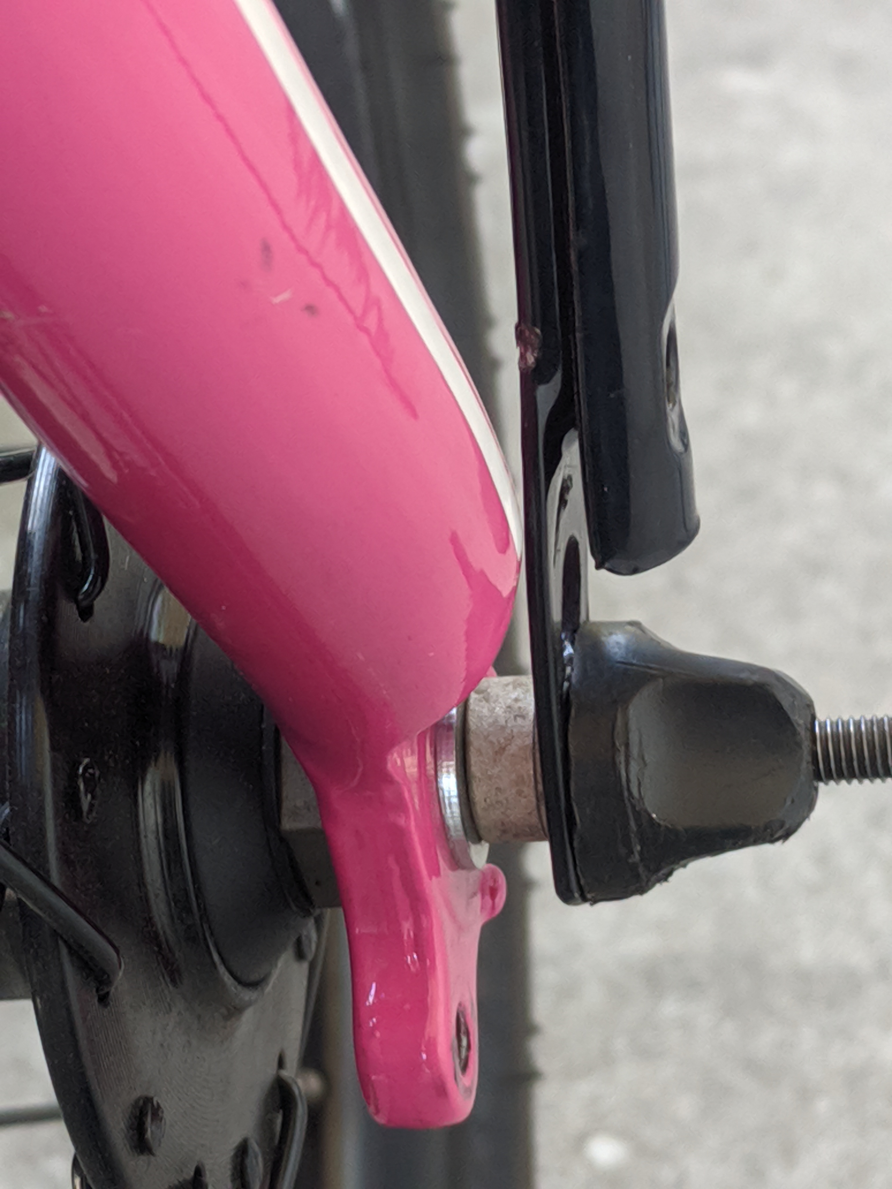

I noticed a fix for your super long eyelet bolts in single shear
use a 135mm rear QR on the front with spacers, and sandwich the struts in that
Wasn’t officially my kludge. I can blame that on Rob. But it’s worked so far.
Will look into the long QR bodge. Won’t there be an issue with the QR nuts not contacting the frame? Feels like that’s an important component.
That’s what the spacers would be for. It doesn’t matter if it’s the actual qr skewer as long as it’s flat and sits in the dropout properly, where a smashed in rack mount usually doesn’t.
Yeah. I felt bad handing it off that way, but for the life of me I cannot find the solid axle I bought for the front wheel.
What was the fender decision for these things? Cascadia?
The spacers that were being used were too small in diameter to get good purchase on the dropout. Found some washers that look to be the same diameter as the gnurled surface on the QR ends and used them with some thick washers I pulled off of some old canti brake pad holders. I only needed about a cm to get the rack stays away from the fork blades. I did have to lower the rack to beyond the lowest setting so the two parts of the stays aren’t sitting totally flush at the ends. Not sure I can fix that outside of cutting the stays.
just dremel that little bit of extra stay?

Would if I had a dremel.
