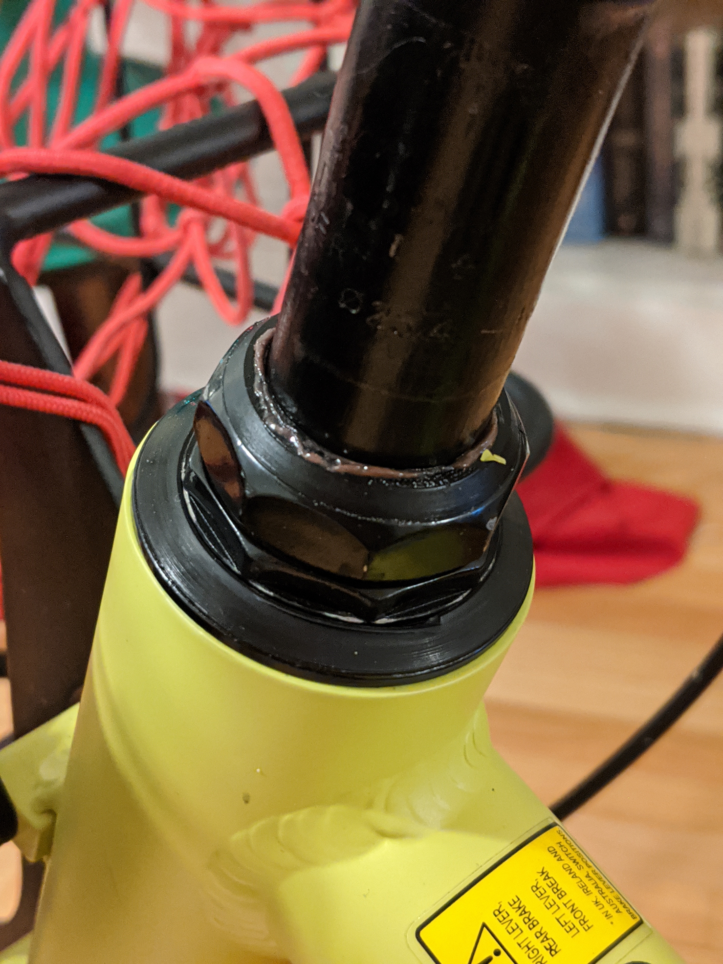

FYI it’s just a normal threaded headset and that cap is pretty loosely secured
but isn’t it a 1.125" threaded steerer with a 1" quill?
and the cups didn’t really look like EC34 either
It looks like something Giant was doing with front squish hybrids 10 years ago. 1-1/8” threaded with zs44 steel cups.
If this bike ever needs a new headset I’m throwing it in the trash.
I think you’re overlooking the possible dithering options…who’ll be first with a roller bearing?
Oh you’re def right but I’m not going any deeper than this photos for now
I might at some point tear the bike apart rebuild it all up dork proper. But not until I get a group for it at least.
How is this possible? Double thicc steerer walls?
Wait…is the quill itself actually 25.4mm diameter which is correct for a 1.125" threaded steerer?
Or are y’all saying it’s a 22.2mm dia quill that is typically compatible with a 1" threaded steerer?
Quill is actually 25.4mm, just measured it.

Is this stem like 2cm higher than the minimum insertion mark?
Was for the photo, I pulled the stem when swapping bars yesterday and took picher before setting it back right

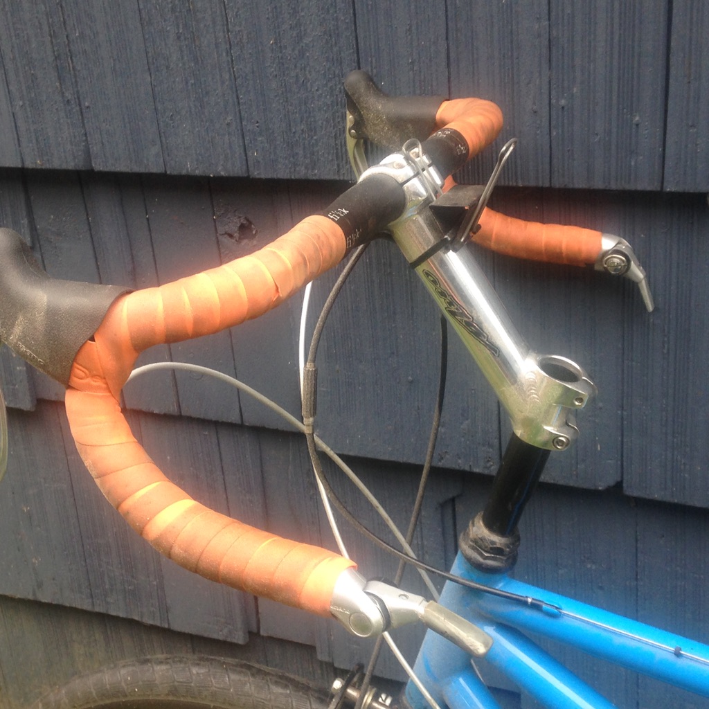

Are there any really long 1 1/8" threadless adapters out there?
adaptor, then extender
The vo adapter is long.
Need a CF threadless adapter
try rotating the high-rise bars in the clamp first, I had my grips in the stratosphere
if you want to mess around with modern nerd bars you could put a Threadless LD stem on top of one of these https://www.amazon.com/PARTS-CONVERTER-ADAPTER-REDUCER-SINGLESPEED/dp/B00I9EXHEU or https://www.chainreactioncycles.com/us/en/brand-x-quill-adaptor-alloy/rp-prod6254
There’s also this Zoom jawn. Looks like not very extendy tho.
My tandem also has a 9/8 threaded fork and is a bit deficient in headtube/reach–
I’m using this Sunlite steel extender, it’s longer than most and plenty stiff. Distinctive feature is it can take both a threadless stem and/or another quill, so you can get crazy
I have it paired with one of these, the bonerest stem I’m aware of
THIS is the dithering I crave
