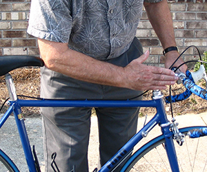

Is the mtb fitting thing where you put your elbow on the nose of your saddle and hope that your fingers land on the center of your stem an actually useful general guideline, or is it some KOPS bullshit? I’m assuming the latter, but hoping it’s the former, because I have no idea how an mtb is supposed to fit, reach-wise.
I really have no answer with “data” to back it up, but most fit guides feel very static were as mtb riding is much more dynamic and fluid. And so varying with what type of riding/fitness level you are at. Sure in the time of :sadgrant: and Hite-Rite’s that KOPS thing maybe worked but now when we are growing longer/lower/slacker in every discipline of mtb riding I’m not sure? Be it WC XC racing, regular ol trail riding to enduro the fit tends to differ from stretched out and low with max VO2 intake and W/Kg body output to more upright and stable for better view/handling/moving bodyweight around.
I haven’t really based my mtb fit on any data or school and rather more what feels good riding when I’m out doing the type of riding I want (and of course taking in consideration the geometry of my slack and long enduro rig sure as fuck wouldn’t handle good with a 150mm boner stem from the 90’s).
Maybe some one else more versed in the modern bike-fit world can throw some numbers at you.
