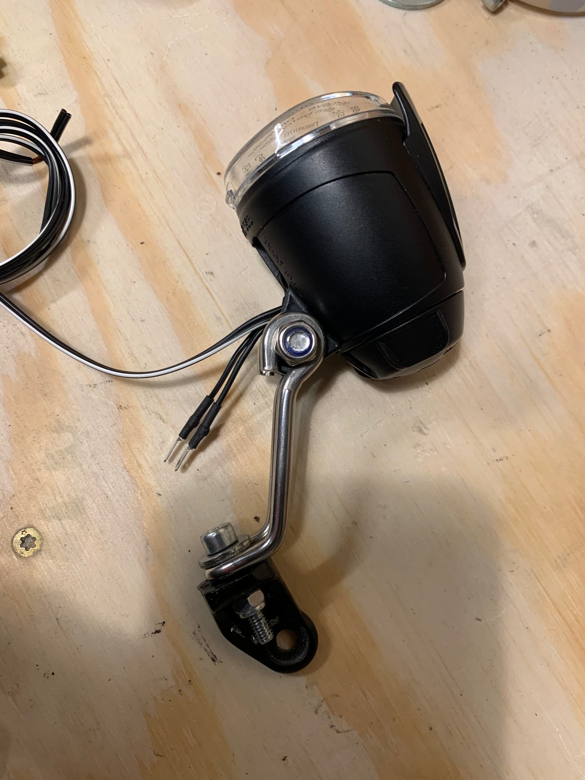

Old and full of junk LBS helped me out with this:
To go on the rack mount.
So that didn’t work.
Because it should go on the left side of the fork, it gradually loosens and I’m afraid to tighten it down any more than I did.

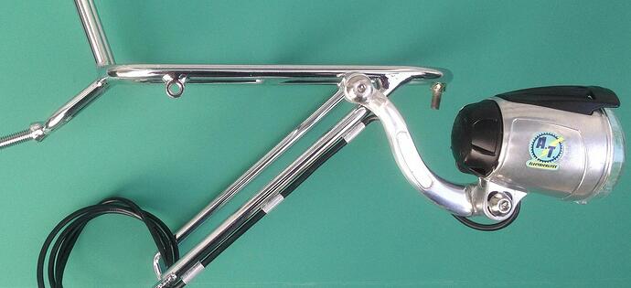

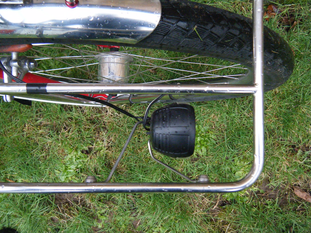

From that earlier conversation that @dotMR linked to:
That was using two old stainless fender struts (Zefal? maybe SKS?). Anyways they can be kind of a PITA to bend an eye on the end that doesn’t have one, definitely want a selection of pliers and a bench vise and small hammer really help.

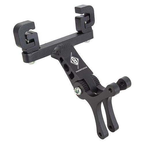

OK even more of a forehead-slap moment, but there are a zillion accessories and mounts and brackets already set up to mount to two bottle-cage boss spacing. Can one of those be modified to hold your light?

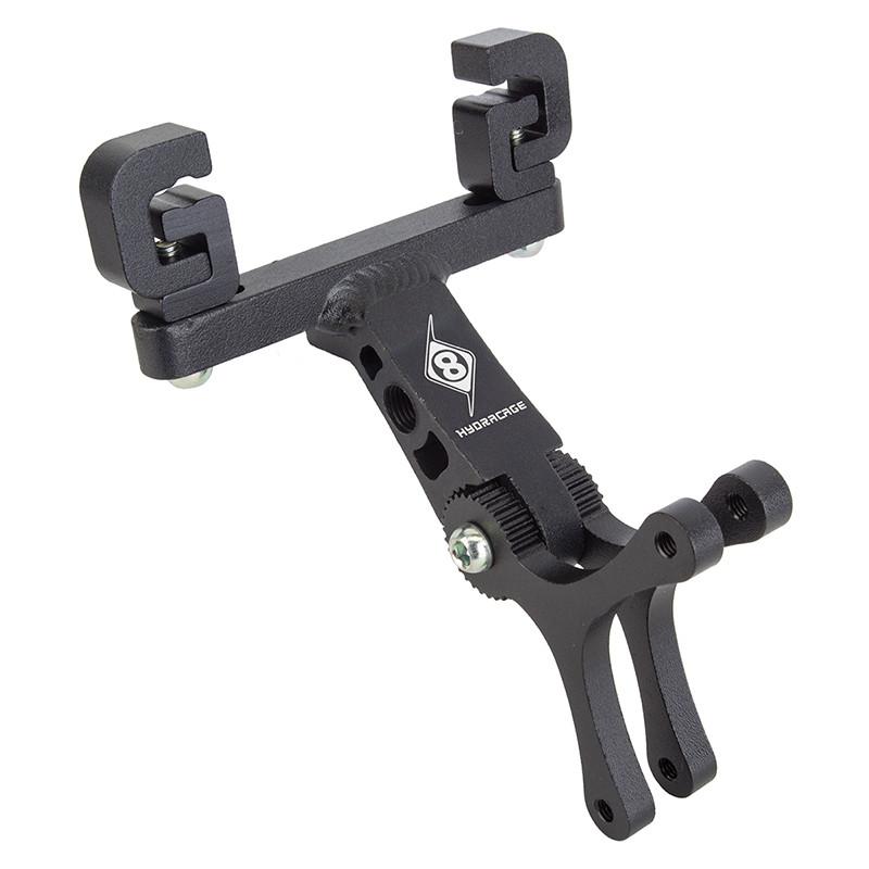

The three-lobed mounts on this Origin8 Hydracage thing look damn near perfect!
You’d just need to drill out the threads on the bottle-boss spaced holes.

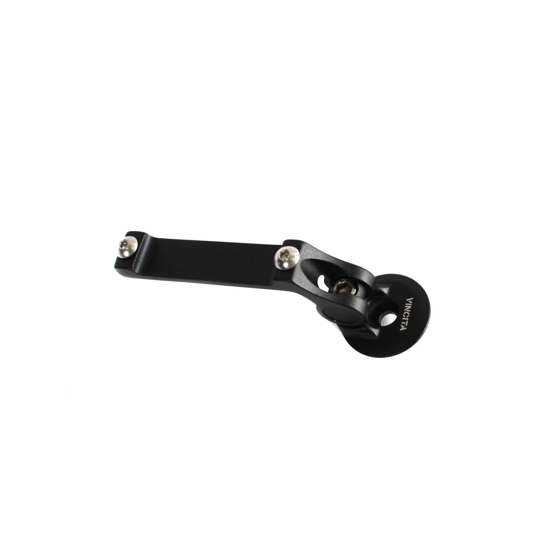

Or this stem cap mount adapter (among others).

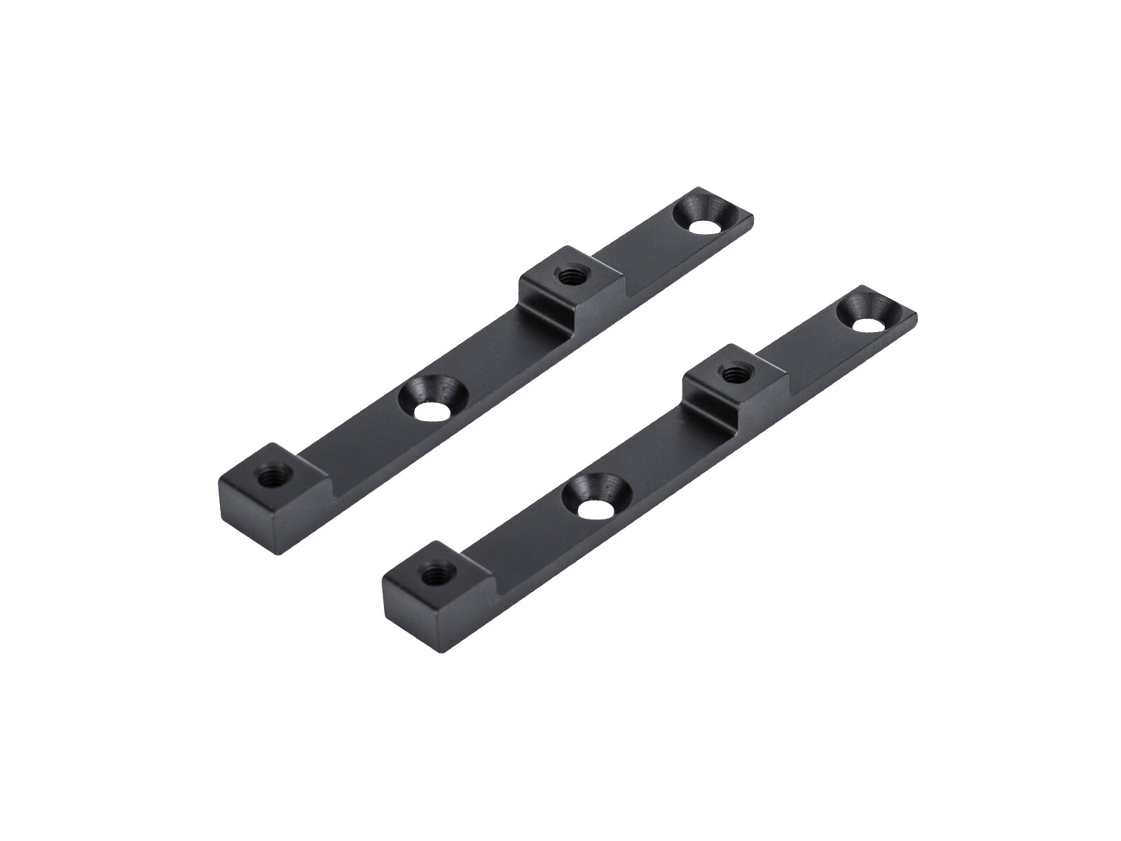

Or something like this Topeak “Alt Position Mounts” (of which other companies offer lots of versions).
I found a combination of reflector brackets that might work off the handlebars. And I was thinking about using the bottle spacing method on the fork and having a friend 3D print something like that bracket above, but with as little reach as possible and still mount the lamp.

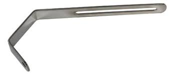

can you use the slotted section of something like this, with the light clamped by a bolt + nylock nut at the top?
The more I look at this the more I think you’re exacy right.
