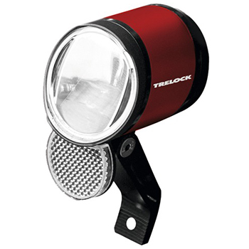

For adorbs you could also consider the Trelock LS905 since it comes in red and blue and doesn’t look too space-age. These are very bright lights with excellent optics. The beardo reflector comes off.

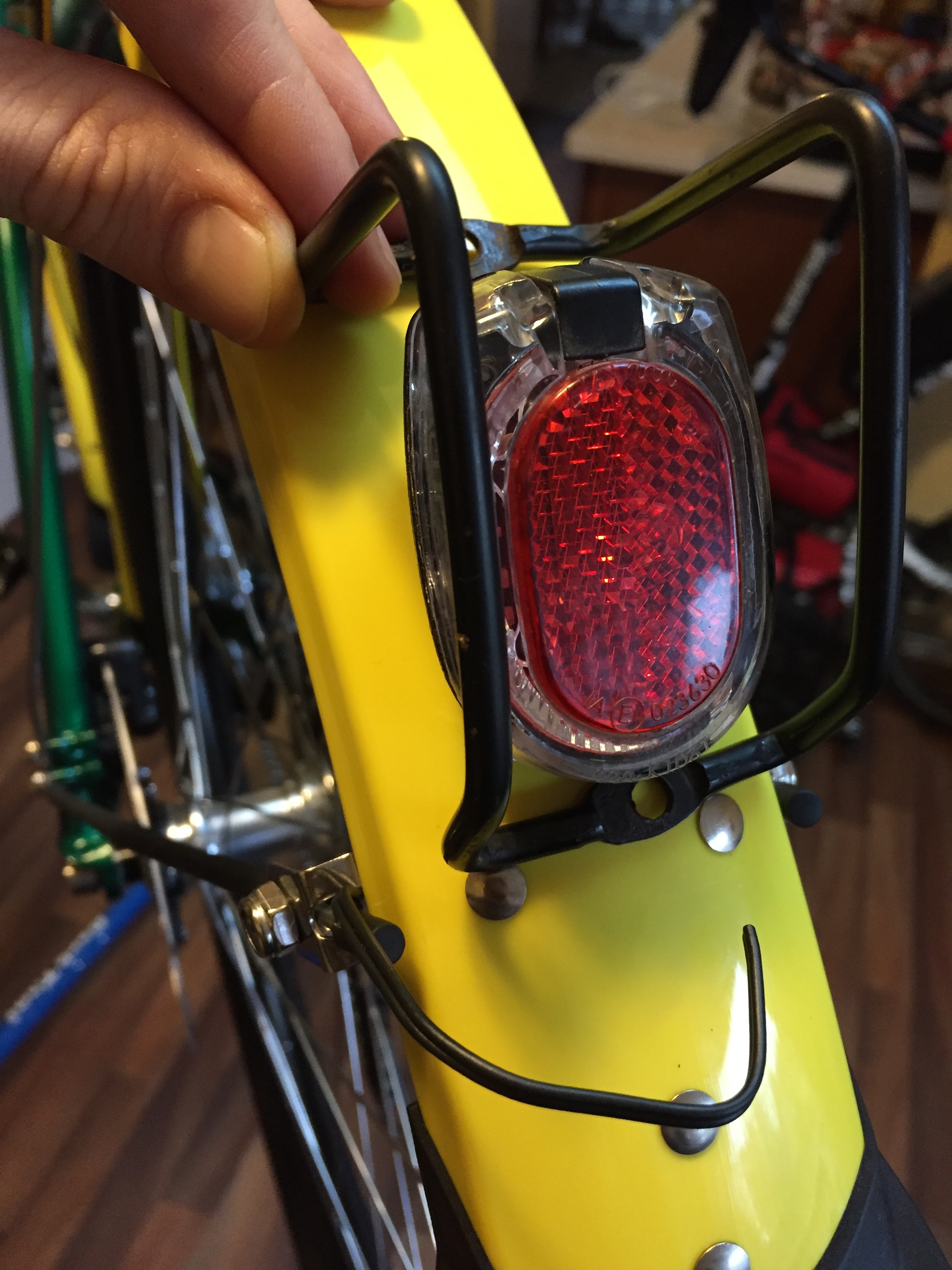

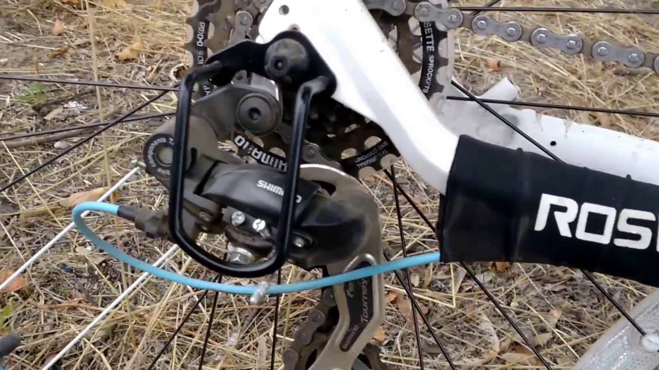

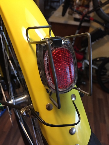

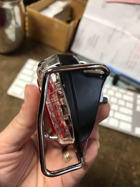

I “found” this dynamo lamp guard off a bike share, omg this bike is absurdly ugly and I love it.

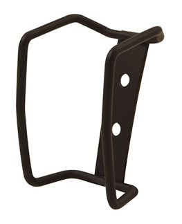

But I also have this thingy that came with a shower bottle rack. It is significantly lighter weight. No way to easily secure tho. Black one seems to match the overall aesthetic whereas this one might look better on a classic steel fop.

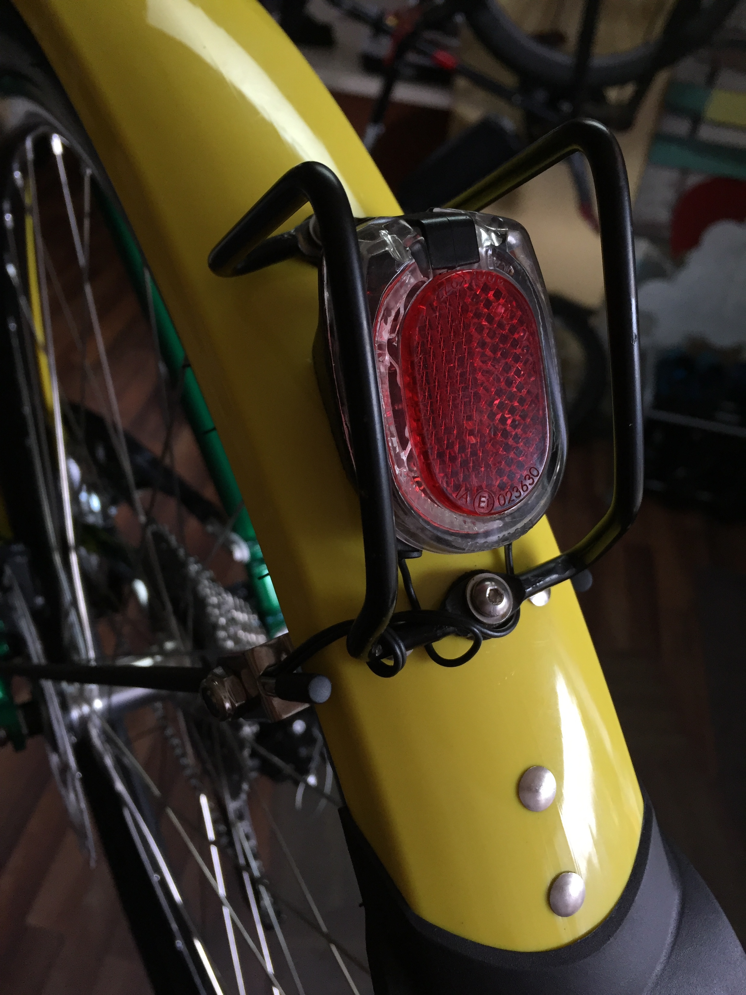

I’ve been wishing I had a pile of Velo Orange / Honjo style R-clips throughout this build. They’re really handy as dynamo guides with a frame that has an outbreak of warts.
I like this one more. You need one for the front now

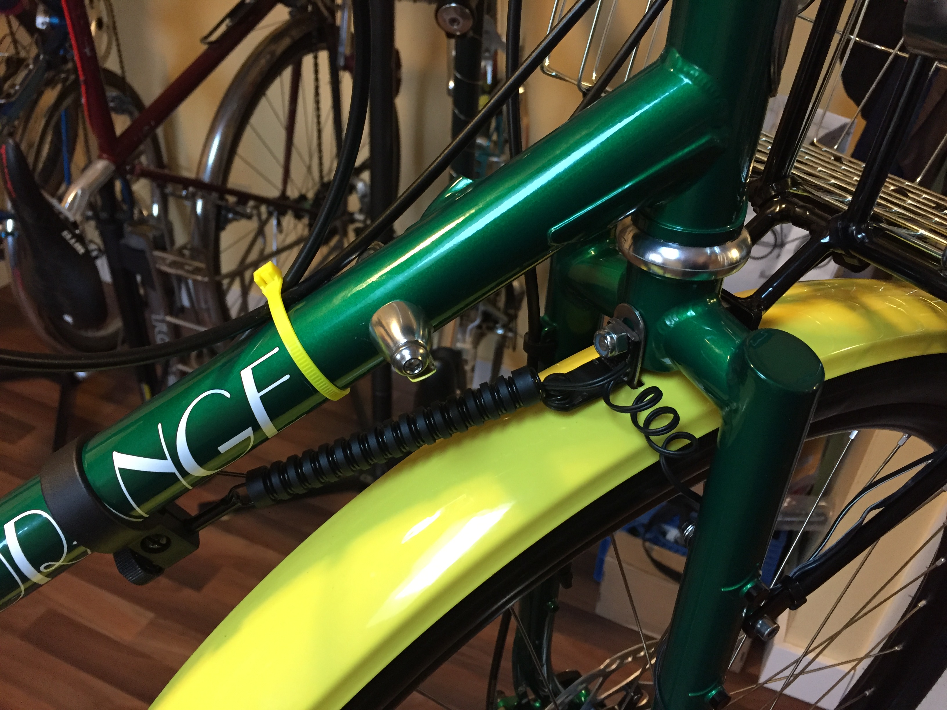

I’m loving this dynamo wire thru a VO spring stabilizer combo that I happen to have in the parts bin from a failed build I tried many years ago.

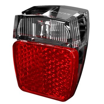

Also eyeing this Spanninga Pixeo Protector and wondering if its lighter weight than the incredibly heavy black one off the Bike Share. Bonus of no extra bolts or holes needed which means less weight wagging on the weak plastic fenders.

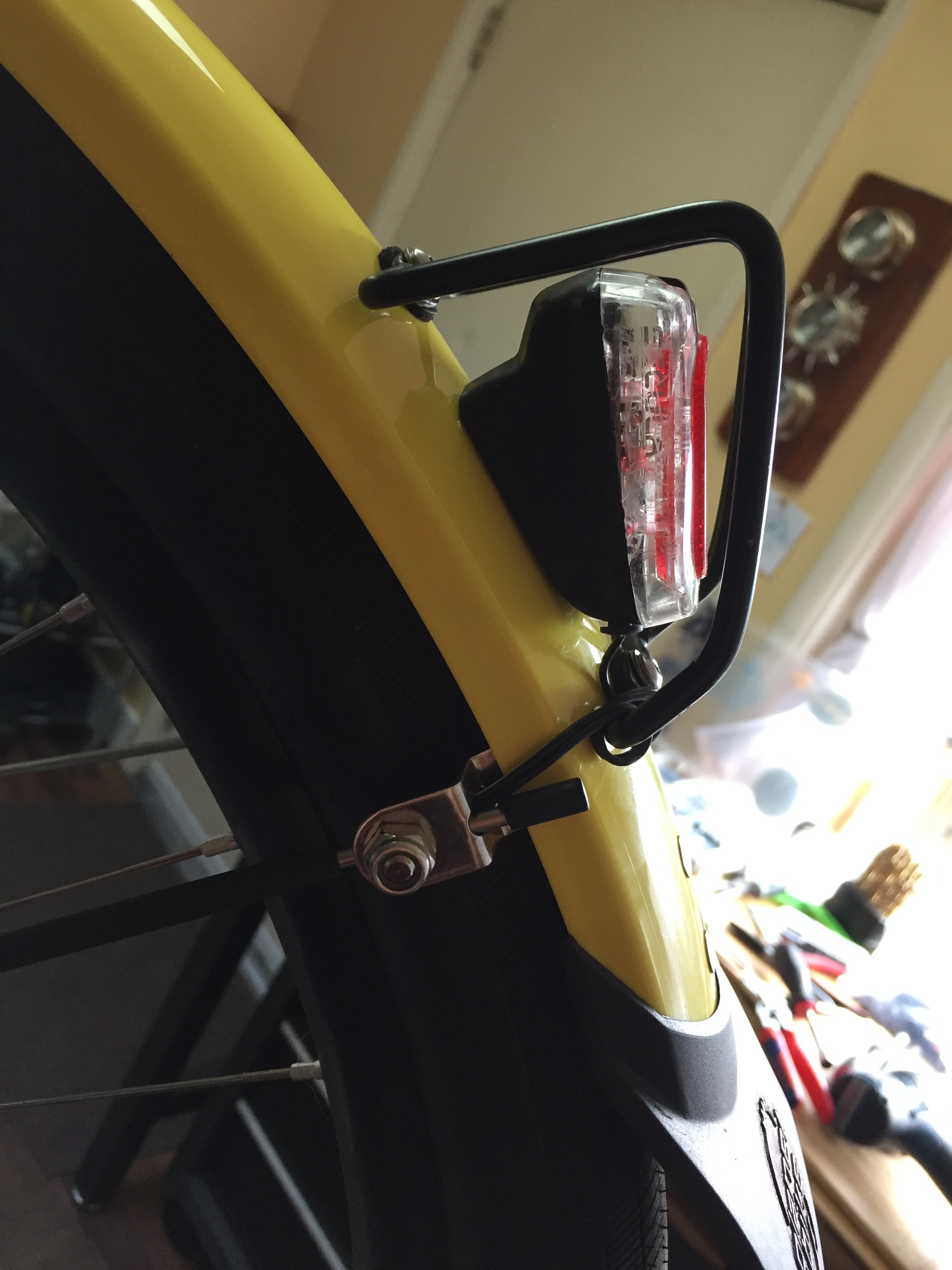

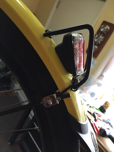

Update from Peter White on that Pixeo protector & B&M Secula.
Holes: ok
Shape: nope
Can you flip it over?

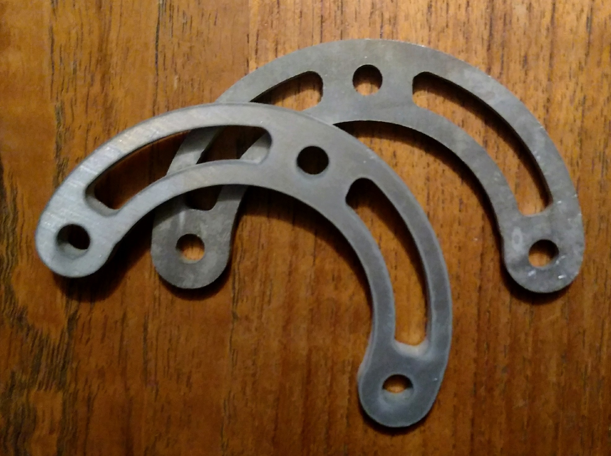

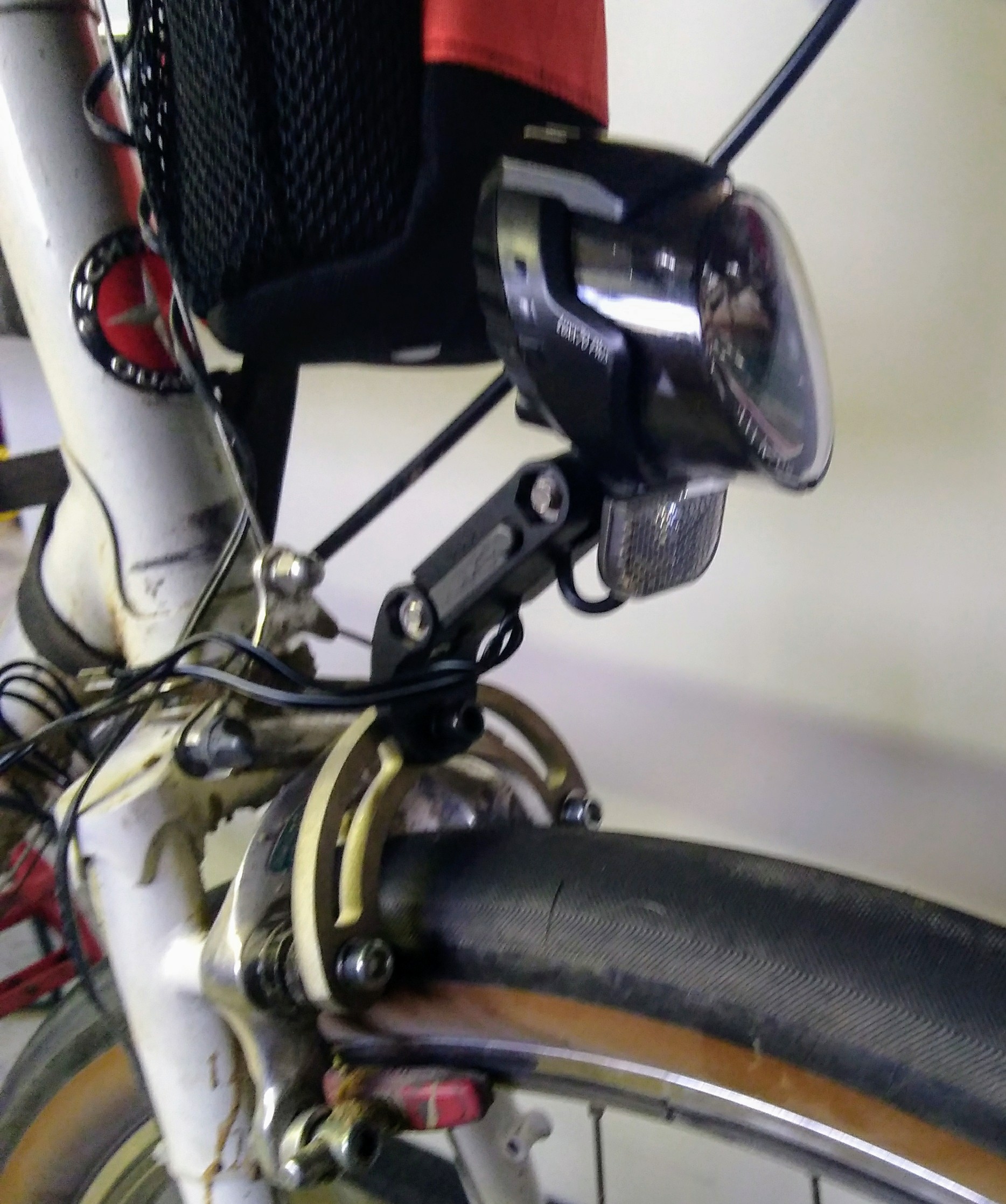

I wanted to mount a light to the fork crown of the tandem but it’s blocked by the U-brake. So I designed this little booster to take a light and had some water jet cut.
They said it looked weird upside down as well.
The thrilling conclusion:
I drilled a hole through the center of the stay brace to support the heavy protector on the bottom. Had a few M4 bolts & nylock nuts from an earlier project and they were the perfect length. Shoved some decrepit leather washers under the bracket, blacked them out with a sharpie.
It’s a little ridiculous with the chunky AXA Luxx 70 Plus but I want to test it out.
