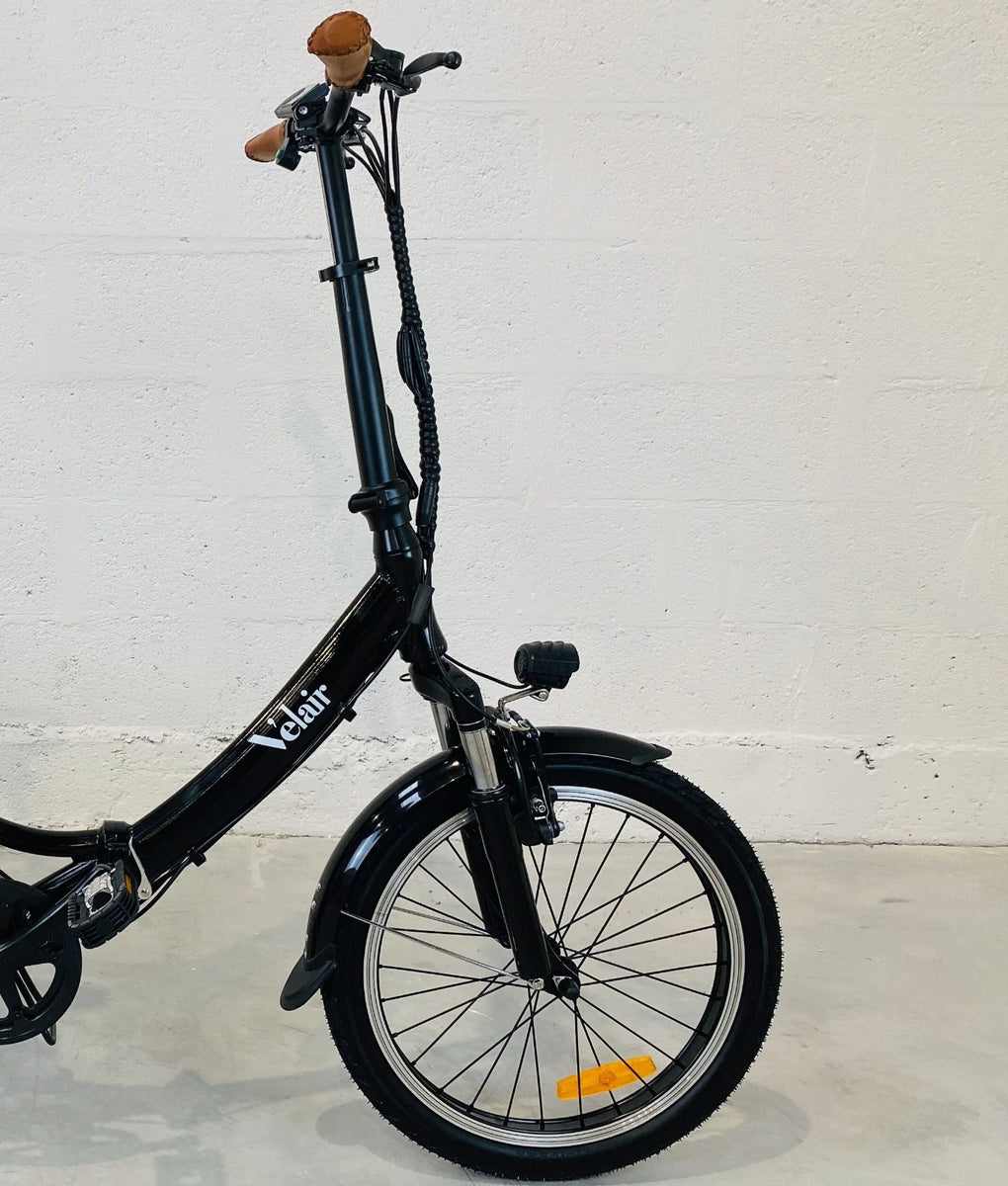

My dad wants to get a folding e bike. Didnât someone here work for some company that made those? I have no idea where to start in helping him. I feel like lectric is the folding one I see the most.
If youâre not too concerned with a test ride, Upway has a bunch of used/overstock options:
That Upway link is a good place to start to see whatâs out there. The Tern Vektron is another option if 3 bongs and up is in the budget.
p sure that was @motorbacon and i regret not buying one when it had the steep tarck discount.
