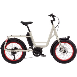

The Boost has been a good bike overall, just ended up being a larger bike than I want to deal with when 95% of my ebike use is just commuting to work. The reach has also felt very long even for me with long long arms. A shortie 32mm stem helped that but I never got around to doing other bar/stem experiments to see if that helped even more. I like the front utility tray and bag, but that has made it more difficult to lock up on the few terrible bike racks I’ve had to use. Taking the utility tray off has made it feel smaller and easier to move around inside, but it was always missed when it was off the bike. Even though it handles a bit weird when I’ve been switching back and forth between bikes, I’ve liked the RemiDemi more than the Boost.

GSD. I bought an Xtracycle edgerunner instead

the edgerunner is in one of the nicest riding bikes I’ve ridden

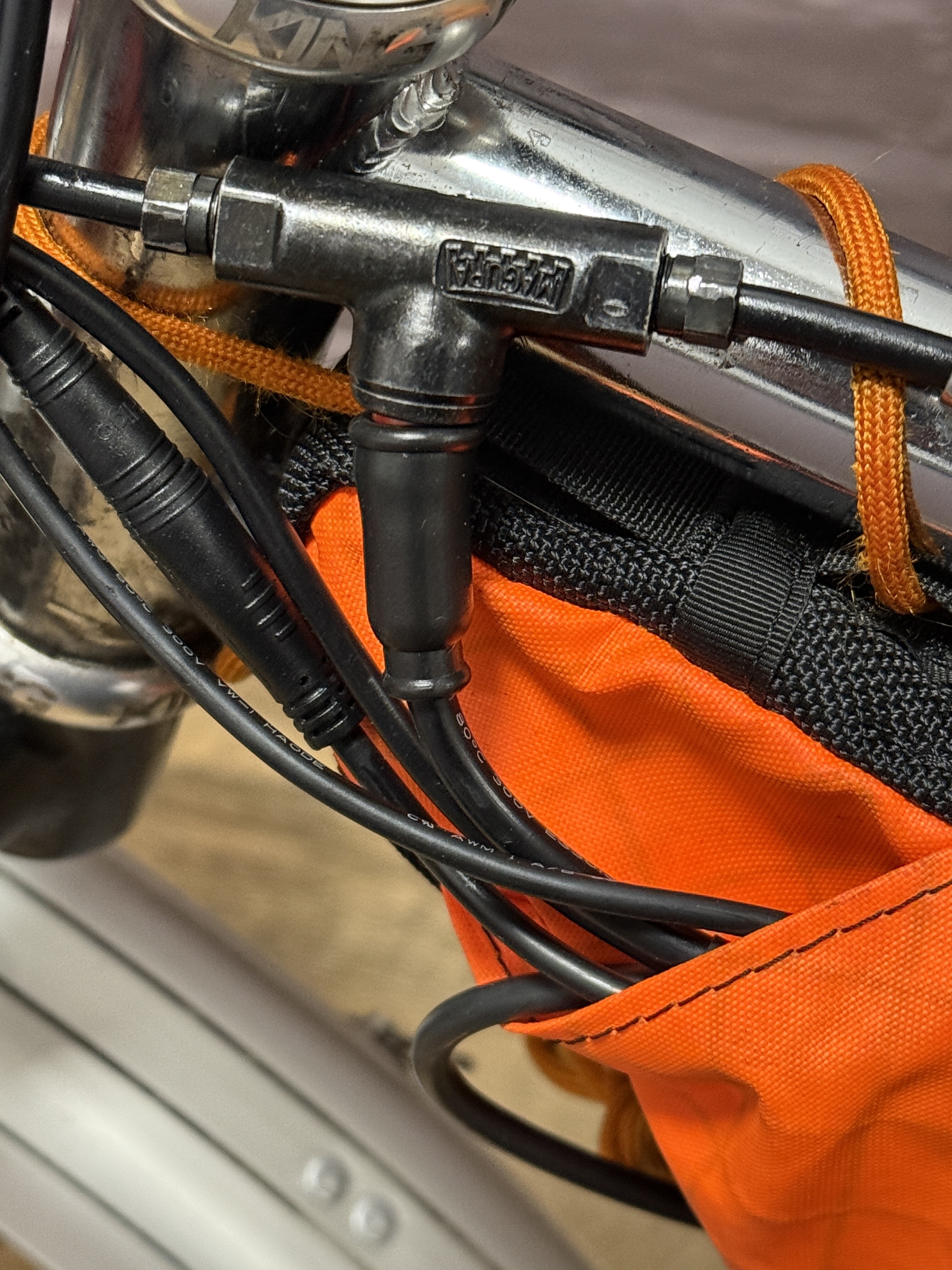

Spliced the correct plug onto the wire and cut this into my rear hydro line. Lever flipping the regen is nice.
Wanted to try that but ended up finding a whole Magura MT5e lever/hose/caliper kit on sale for just $100 so it seemed a no brainer
Never handled magura but all I hear is that the bar clamp is fragile because it is plastic and you should torque it to like finger tight.
at ā€œthe most maguraā€ the bolts are really torx wood screws into the plastic
I think the biggest weak point on those is the main lever pivot also being in plastic so the whole thing can explode if you drop your bike and tag the lever blade
