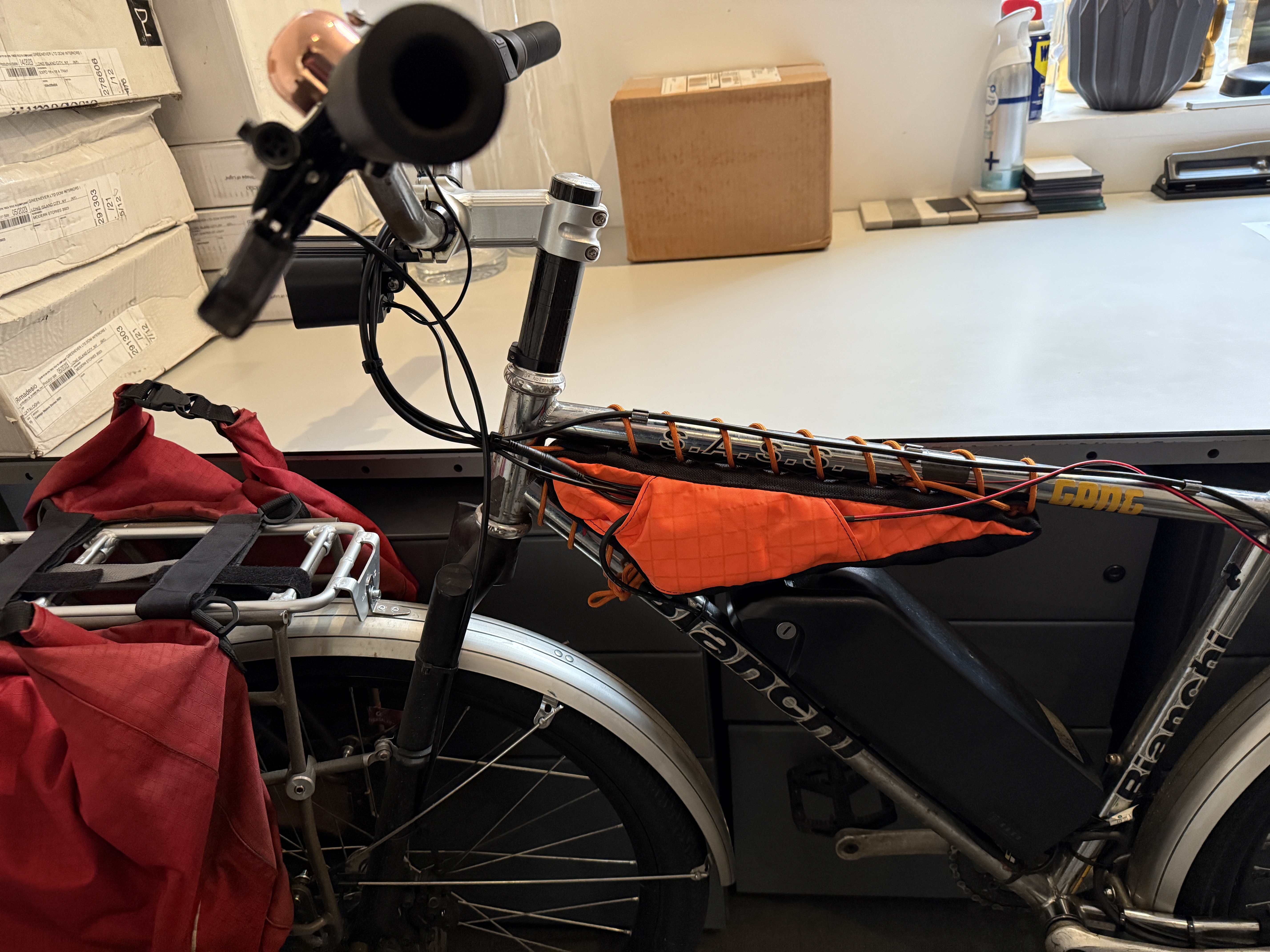

Gah the B&M IQ-Xe stopped working on my ebike this morning. It still passes power to the tail light, so I assume it’s an issue with the light itself. Anyone have success fixing one of these?

This is what I ended up with. Both plugged into super harness.

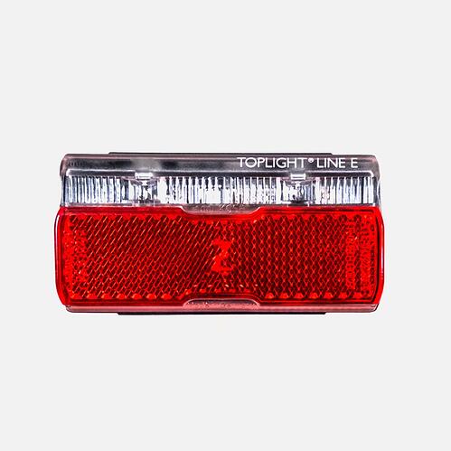

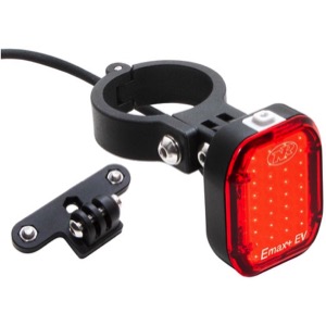

There’s also this option for the rear which I guess you don’t need.
Not sure you’ll find an ebike light that will pass a lower voltage to a non-ebike rear light.
Yeah I’m using the iq-xe now but it died
Actually I’m sitting here at work thinking I’m a dumbass. My tail light is plugged in separately so I bet my headlight just came unplugged.
Would be worth doing a continuity check between the light and the power source, might just be a break somewhere.
