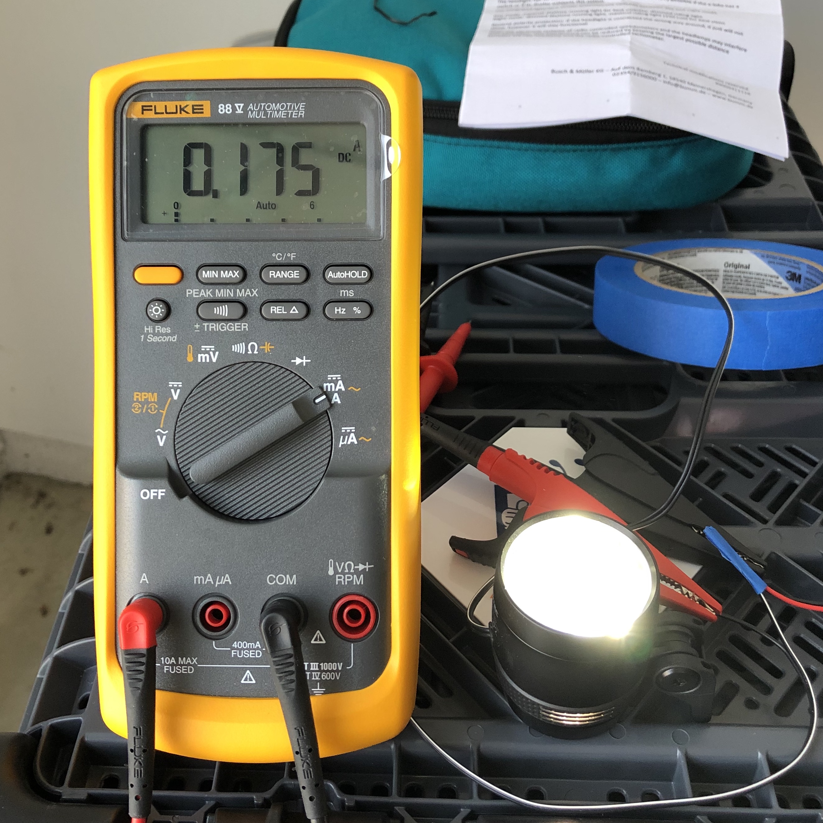

The Cycle Analyst has an output that provides 1A at battery voltage and that would be pretty convenient to use to power lights. It seems like that should be enough current, but it’s been too long since I messed with electrical stuff so I’m doubting whether or not this is right.
Headlight: IQ-X E, specs say 7.5W consumption nominal
Battery: 42.0V fully charged, programmed 32.0V cutoff
The headlight alone should only consume 0.18A at 42V, right?
If so, that should be plenty of headroom for a Topline rear light (no published power consumption specs, but it can’t be as much as the 150 lum headlight). There’s probably a higher start up current when the lights are turn on, but could it be high enough that the fused 1A output isn’t enough?

Realized I had the stuff to figure this out this without putting the tiny fuse at risk. This is at 40V. At 32V is should still only pull 0.23A. Should be just fine even with the tail light.
