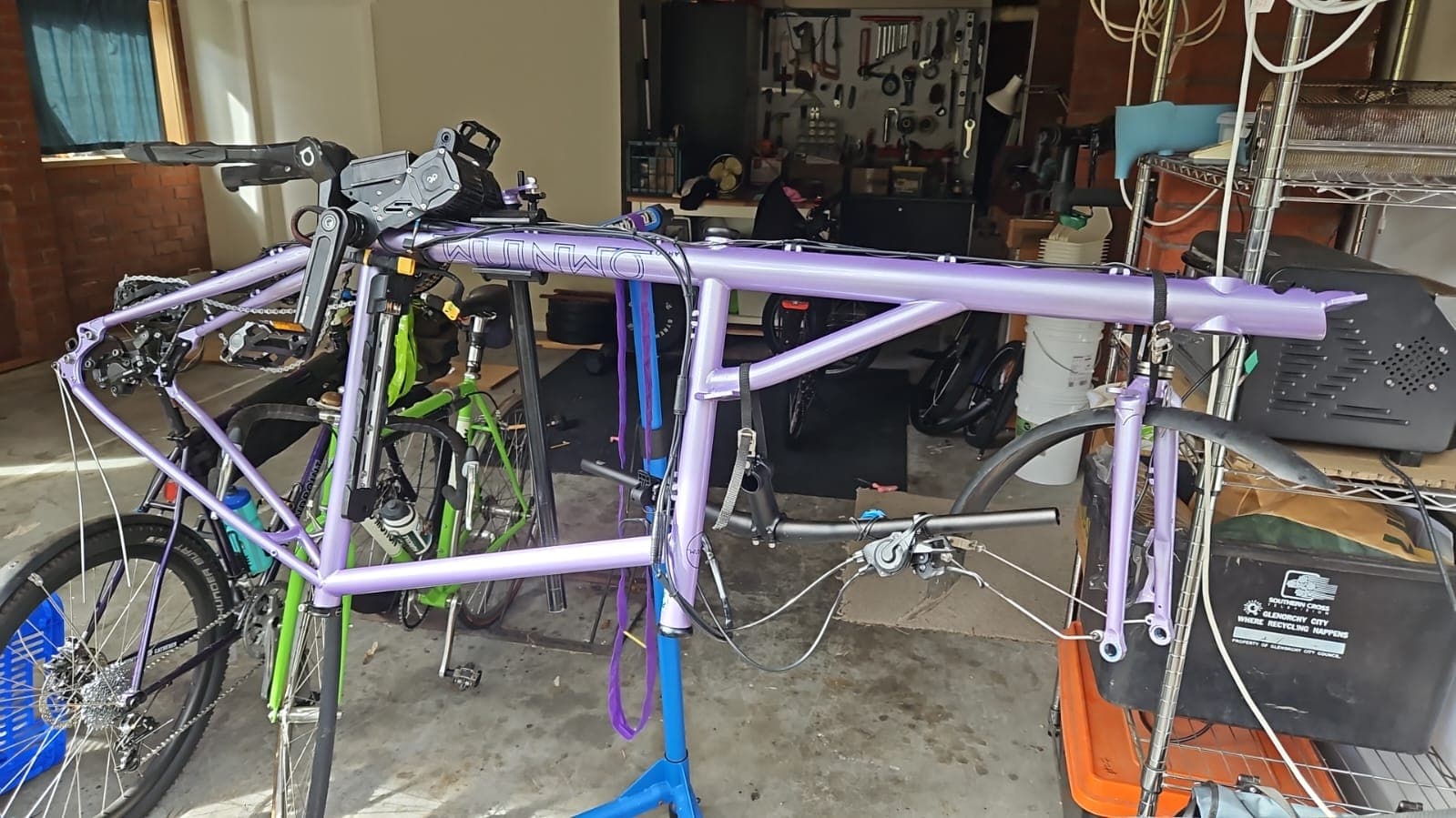

After spending hours on Grin’s website I think a front hub motor from them makes a lot of sense. They do a 135mm qr for the fatbike fork I have on there, a basic kit comes with PAS sensors and if I want torque sensing I can always add that later. Their V3 slow wind hub sounds like the right choice for my uses, from there it’s just picking a controller and trying to do the calculus on how much battery I can afford, how much range I reasonably would like, and where best to mount it. I added everything up and it was just shy of $1800 with a wheel built by them. So I know what to start saving towards!
If anyone thinks front motor is stupid please tell me now. Or in 6 months when I’ll still be dithering.
they are very good at answering questions by email. not so much on the phone. reach out and see if there is a way for you to run a rear motor in reverse on the front so you have options. then you can experiment and rearrange things if you change your mind

Well this really does give me pause. I love having a funky weird mish mash franken bike, but do I really like all the little problems that go along with it? I have never built any ebikes or wrenched on them, so it’s a bit daunting to DIY it.

Looks like $1900 gets you a class 1 Benno Boost right now off upway, that’s pretty solid
Yeah I was about to say, unless you are super duper in love with a bike you already have and/or got super cheap, it’s usually better to buy a complete bike since they are so cheap now. We got my wife’s REI bike during the super sale and that whole bike was cheaper than the kit I put on my Dummy.
Putting the free radical on a spesh turbo or something might actually be the best of both worlds. I just like the xtracycle cargo set up more than most other off the shelf cargo bikes.
I’ve spent the last two weeks in deep dither and decided to go with a Bafang bbs02 mid drive, I’ve got a good idea of how much everything will cost so now I’ve just saving up and watching a ton of videos on various installs and tips and tricks.
The big takeaway is my god do most ebike folks, even the ones who build custom ebikes for other people, not have a goddamn clue how to wrench on a bike. I’m watching a video on installing a shift sensor and the guy pulls the cable completely out of the shifter so he can trim the housing, then immediately puts it back into the shifter. And he does a shit job of cutting the housing.
