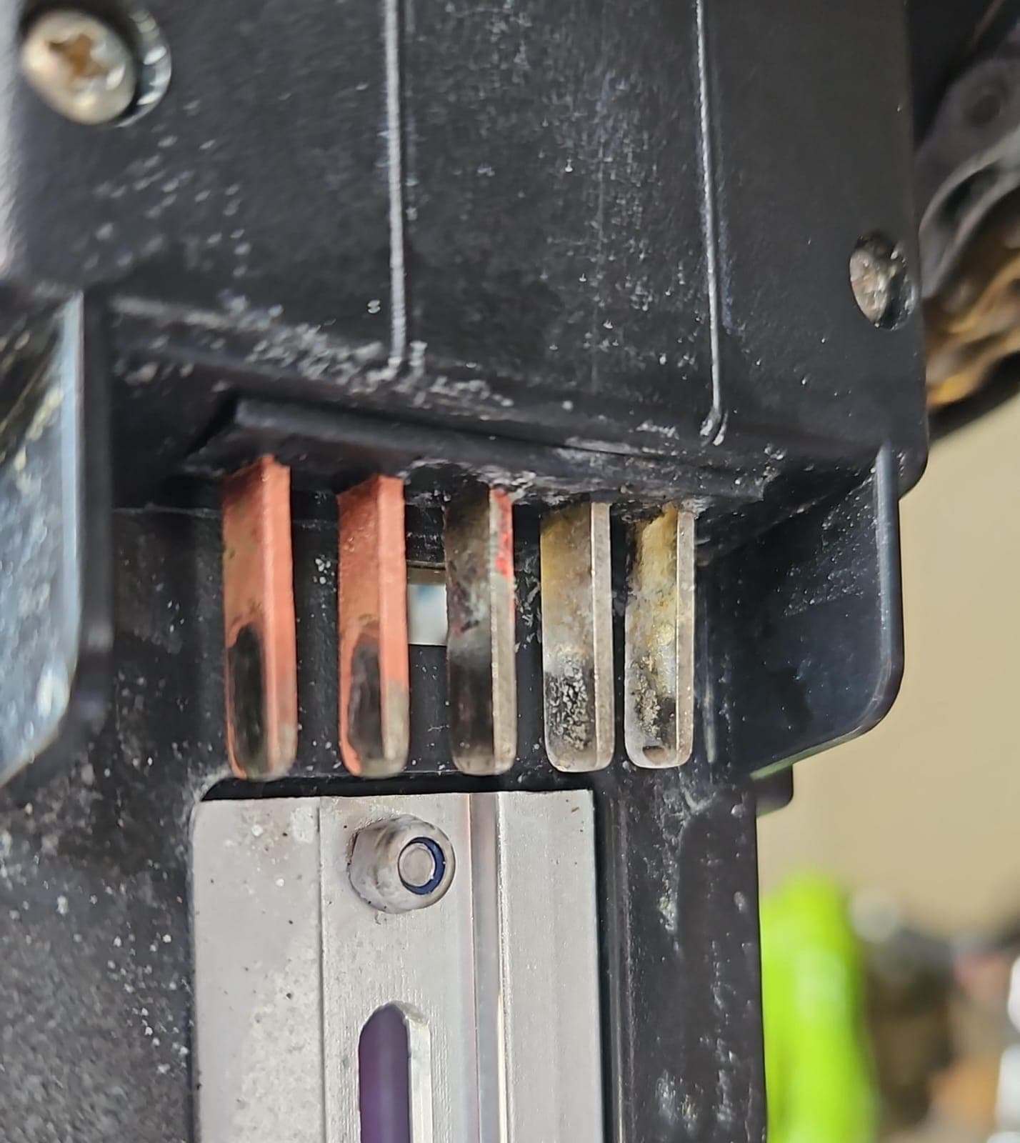

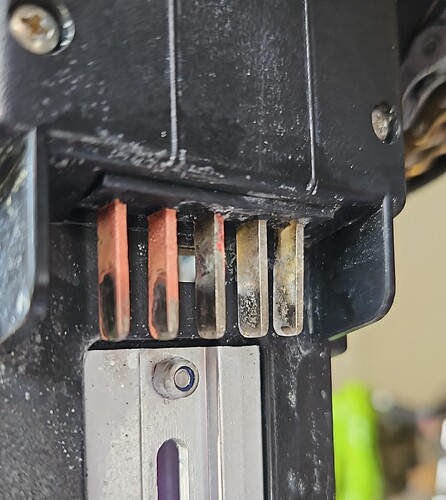

battery mount contacts looks corroded/plated too, have to have a closer look.
I’ll hit it with meths now, as it’s going to be 5-6hrs until I can knock off work and try to disassemble
The cyo headlight appears to have some corrosion on the PCB already. :crossed_fingers: the drive unit is better sealed.
The battery mount appears (assuming they were all silver before) to have lost the plating on two of the 5 pins, they’re bare copper and the others are silver coloured. corrosion/electrolysis perhaps.

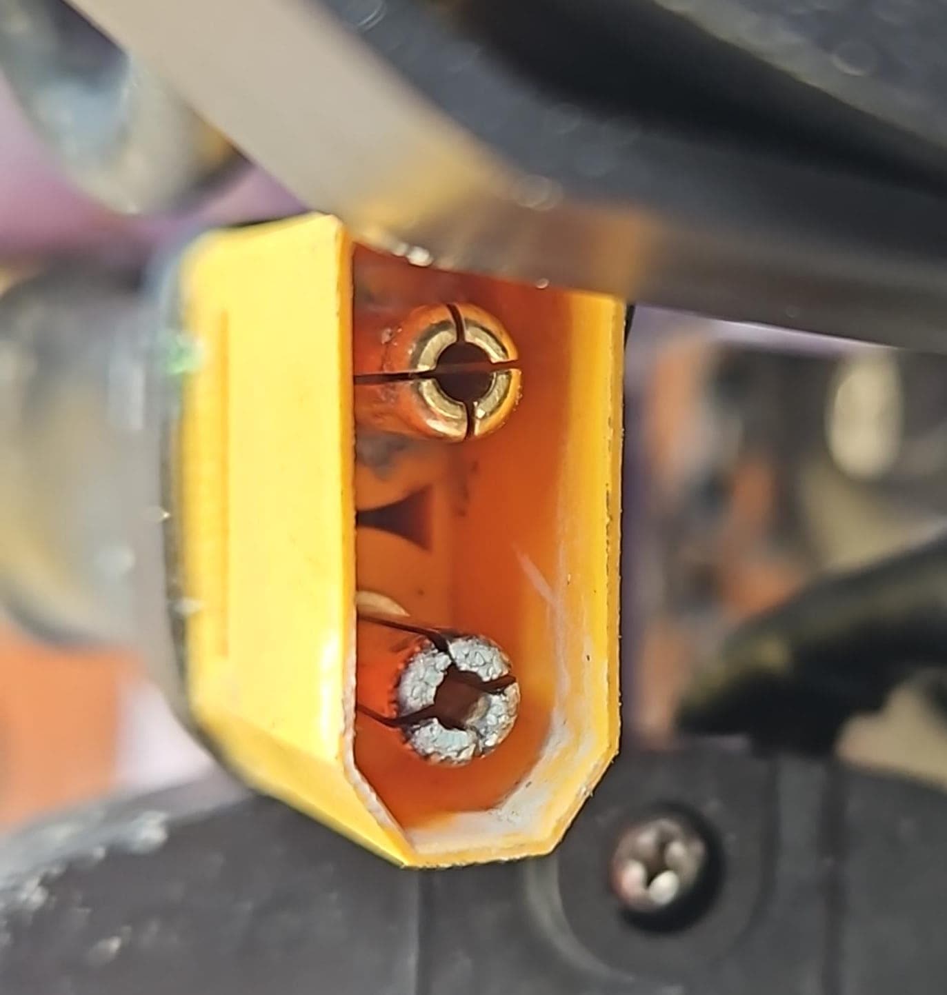

even the XT connector between battery mount and controller isn’t that pretty
Not super confident either of battery or motor-controller are ok.

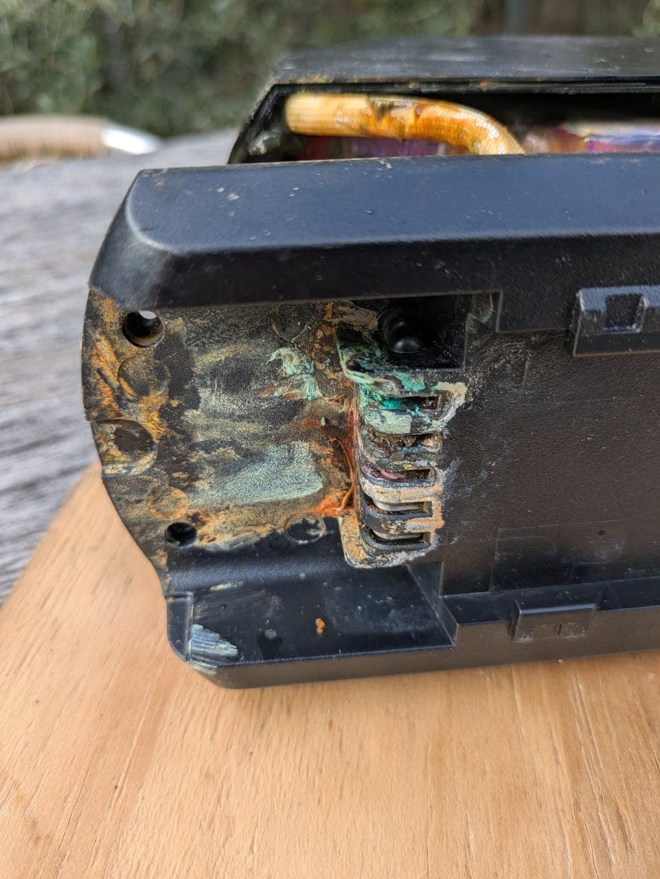

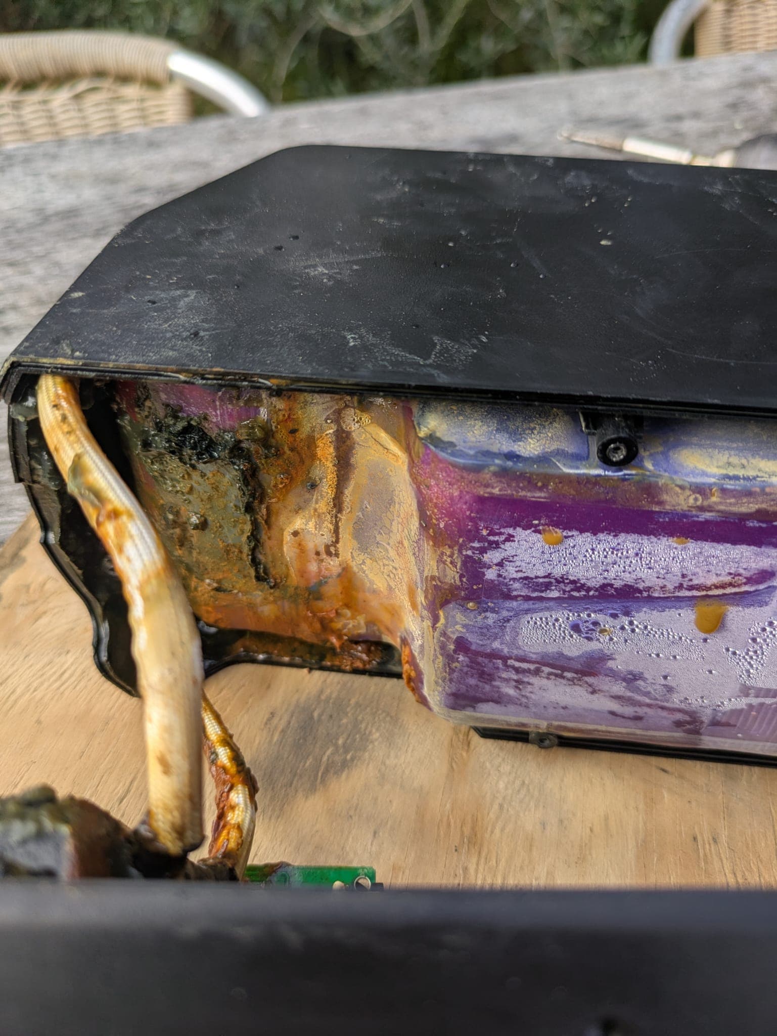

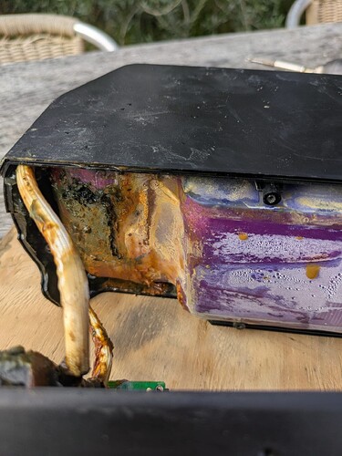

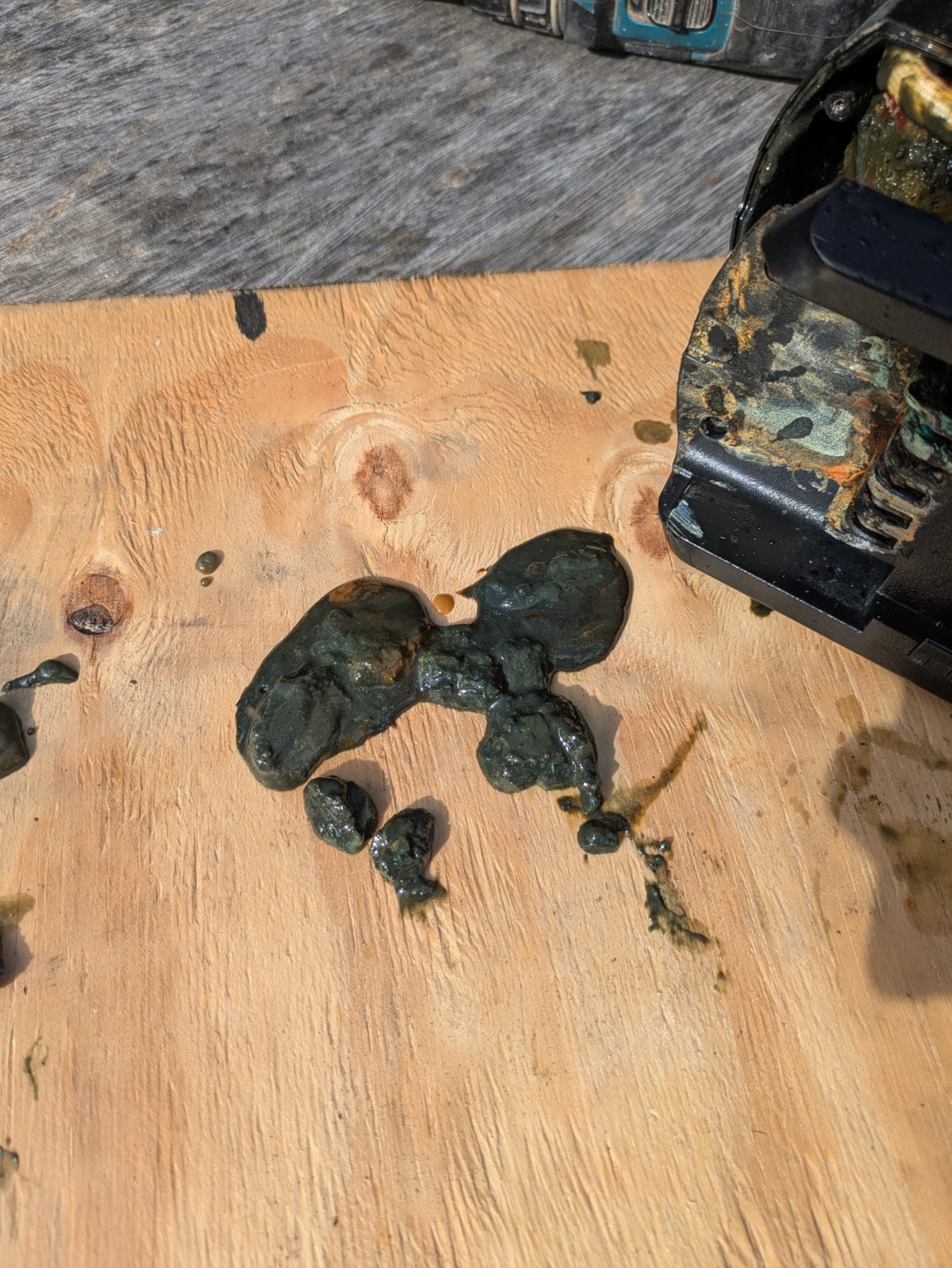

just received a few photos of the battery
not so much magic smoke, but the magic goo got out.
Jesus! How long was it in the water? Like just a moment then pulled back out or was it pushed in and submerged and wrestled back to dry land over the course of a half hour?
Cahnt’s fahked mate
Don’t know exactly, but would wager it was under for somewhere in the 30-60min zone

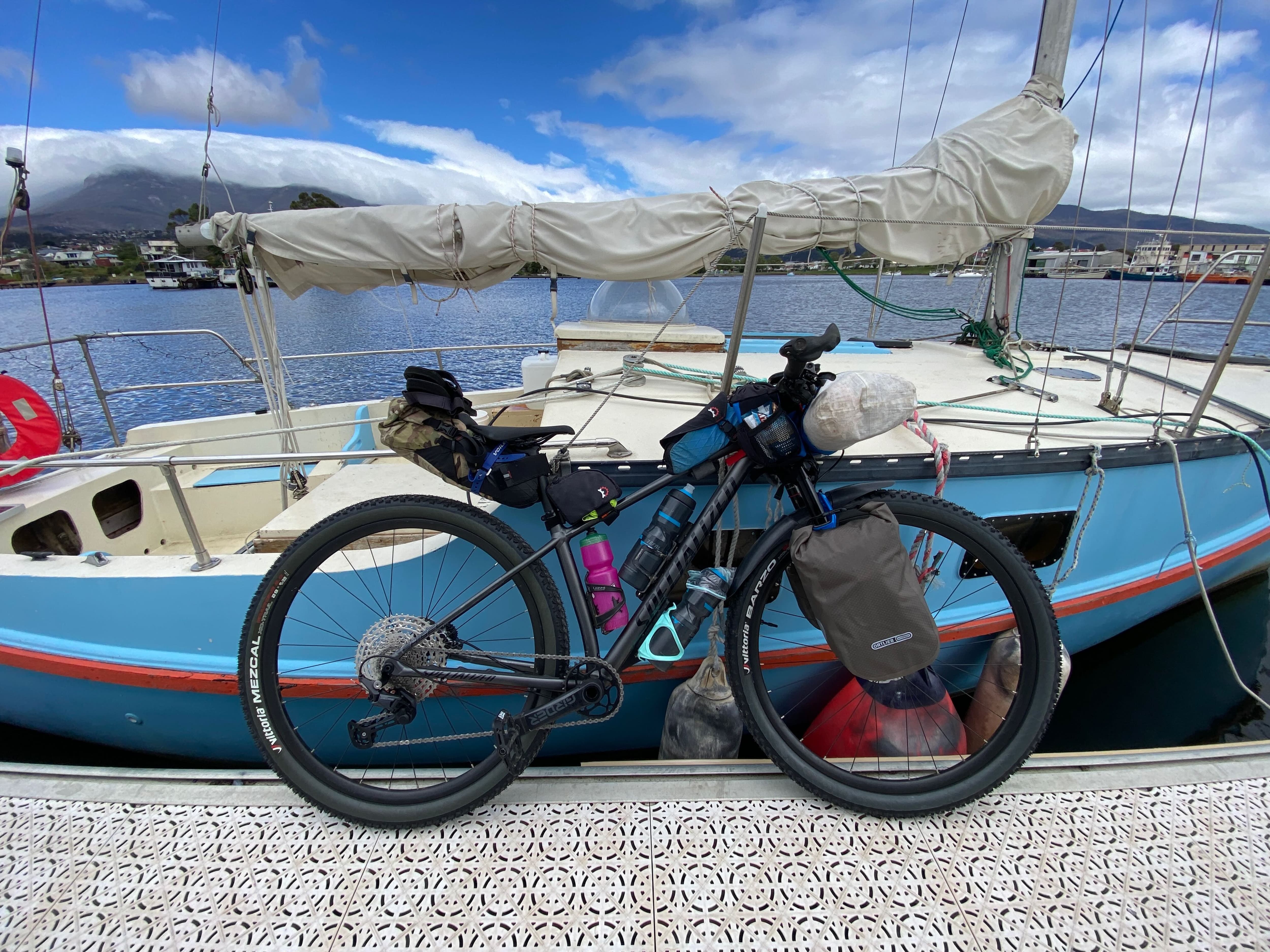

Here’s what happened…owner lives on a small yacht moored in a bay on the derwent estuary, bike parked on mooring/jetty/whatever you call it. High winds overnight, woke up to a strange noise, first thought THIEF, investigated and saw bike was in the drink, but luckily snagged on a pontoon and not down with spongebob. Couldn’t get it out themselves, called a friend to assist, fished it out, disconnected battery.
on a HY/WTH scale, this one’s got a lot of WTH, but a big HY that it doesn’t require a salvage diver to recover.

yeah, i’m sure they are v v annoyed at themselves for parking it that way (it’s been fine up until now, there’s been stronger gales recently… etc)

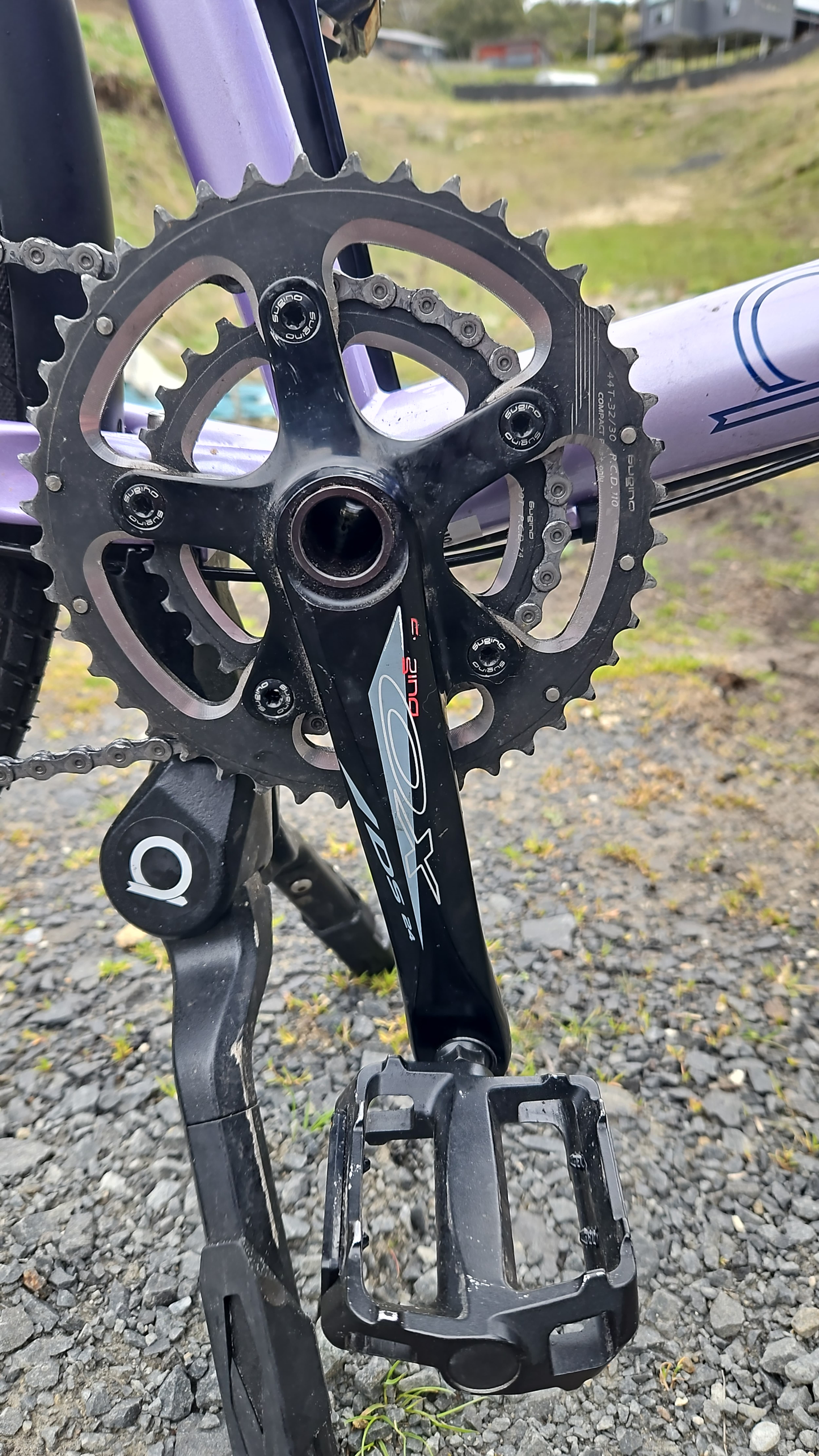

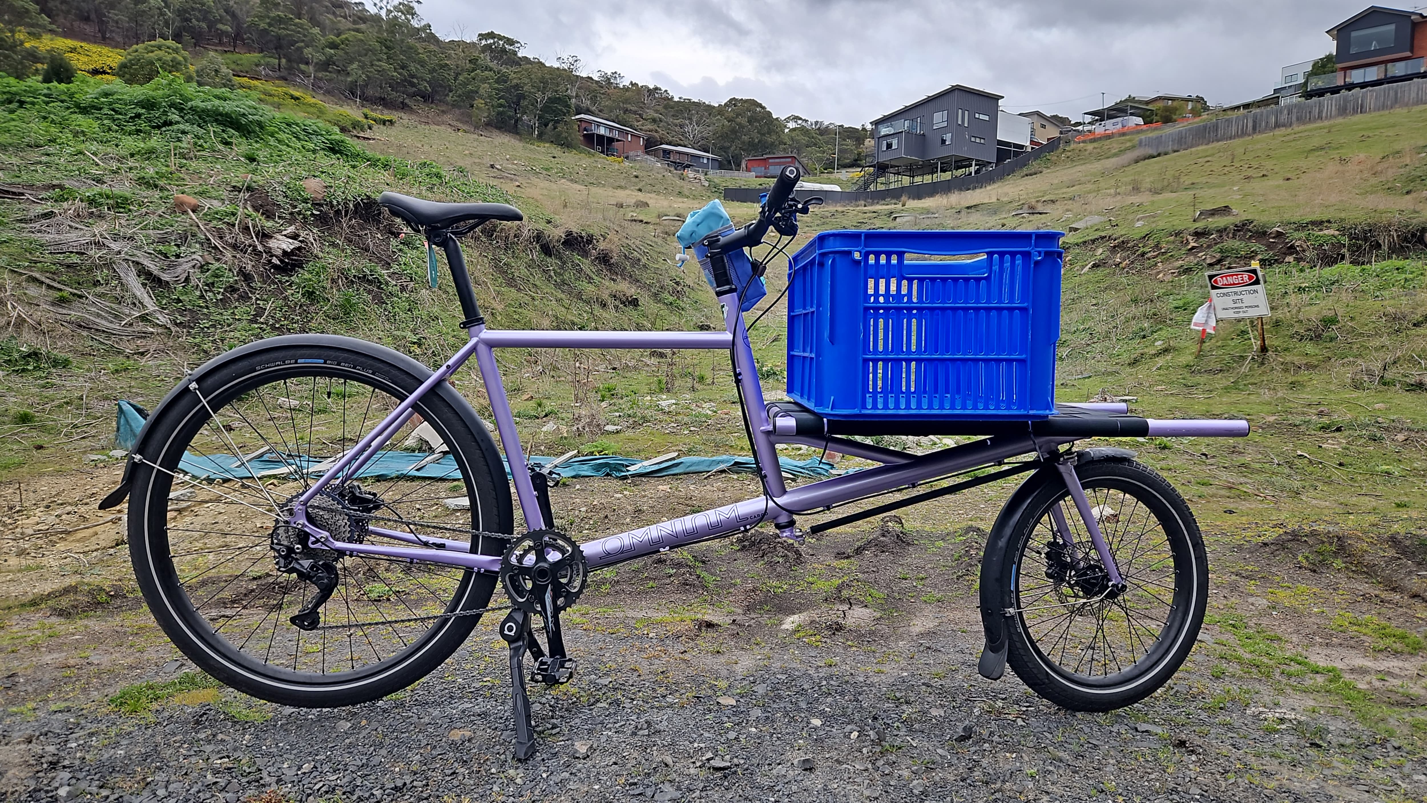

looks like omnium is BSA68, so I reckon I can swap out the motor unit for a crankset with a 30-something ring to allow it to run acoustic while they figure out what’s next (buy a new kit to match I guess and retire everything from existing one)

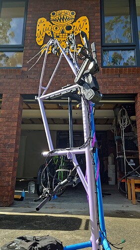

I’ll still rip the motor off and then douse the internals with lanolin spray

(analogue bike against said smoll yacht)

Current status: rotisserie bike in the sun spraying lanox down the various open tubes and vent holes, then rotate and go again.
Has a 68mm BB so swapping in a road crank with a 3xT ring would get it going acoustic in the short term.
It’s acoustic!
Now with a temporary sugino nerd crank.
Reassembled and repaired the broken guard, tightened up the steering linkage etc.

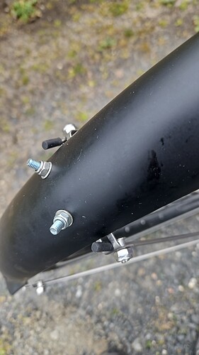

Feel like i should cut the fender bolts but CBF.
