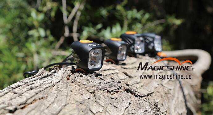

Picked up an Allty 2000 from Olight just coz. I’ve a RN1500 as well. Lessee
RN1500 is awesome. The one from Olight comes with what I presume is a Samsung 50e 21700 5000mah battery, which is the difference, I think between it and the MagicShine RN1200 which comes with a 3500mah 21700. I think Olight bumps the output a little as well.
RN1500 has a really nice soft cutoff lens and USB-C PD-style charging and discharging. I haven’t checked the current, but it charges fast relative to my other 21700 light.
IMHO, this is one of the best battery powered lights on the market. It’d be my main one, but I can’t get it mounted how I like. It’s got a the soft cutoff lens and a spill light that comes out the bottom that makes running it upside-down a bad idea.
Allty 2000. This is not as good as I’d hoped. Definitely more light, likely great for MTB use. There’s no soft cutoff and it would blind motorists if run on the highest setting. Comes with 2x3500mah 18650s, so runtime is very good. Has a DRL (yay?) and two Cree XM-L2 emitters one with a spot optic and the other with a flood optic.
There’s an OLED display which is okay, I guess. I want stuff to have an easy UI and not need a display to distract me. Runtimes are really good. There’s a million modes, but this is the only light I’m aware of that’ll put out 1000 lumens for 2 hours, which is about the length of my morning rides and will provide usable illumination on lower outputs for well over 8 hours.
RN1500 is fully submersible and the Allty 2000 is IPX5, resistant to water spray. RN1500 comes with USB-C charge and discharge. Allty 2000 comes with an older micro-usb charger. RN1500 has a nicer full aluminum housing. Allty 2000 is plastic and aluminum.
