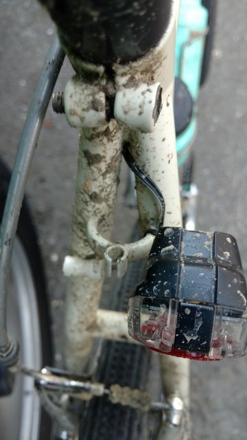

I just used the wire supplied with my B&M lights held in place with black electrical tape. I ran the wire to the rear light on the bottom of the downtube and then up the back of the seat tube which I’m not terribly happy with but I figured it was better than on the top tube because of how much I’m carrying this thing up and down stairs. I wondering if there might be some kind of peel and stick plastic sleeving I can use later on to move the wires to the top tube without risk of snagging or pinching them while on the train.
Since the hub grounds at the fork, can I just ground both of the ground leads from the headlamp to the fork and run a single wire from the hub to the headlamp and then back to the tail light?

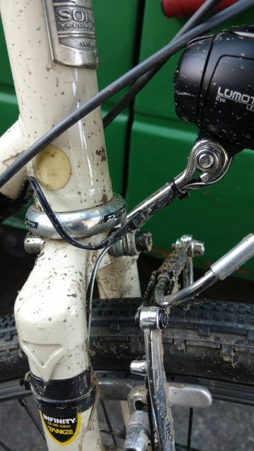

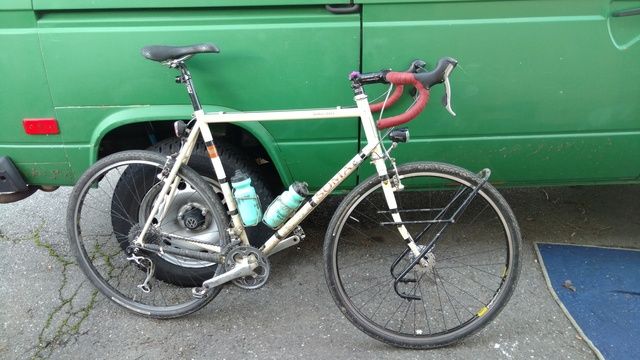

So, I took some pictures of the bike like I said I would but instead of cleaning up I decided to get it dirtier. I used the wire that came with the lights for now and it’s all held in place with electrical tape and a few zip ties. I’m not super pleased with how I did it but I fully plan on rewiring it with a single conductor wire and running the ground through the frame and fork at a later date. For now, it works and I don’t think it would have any problems if I left it as is.

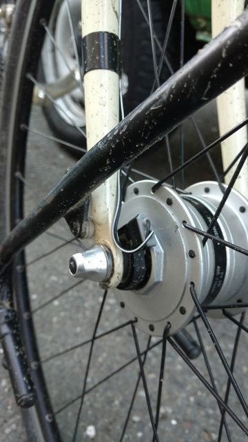

I ran the wires from the hub with a little loop up the inside of the fork leg, not sure if I want to keep it there or run it on the back of the leg later on. Another idea was to drill a hole on the inside of the crown lug and feed it in through the vent hole on the bottom of the leg but I’m not sure if that’ll come back to bite me some day. I plan on moving the light up to the bars eventually, I don’t like how much light hits the top of the tire. Another thought is to mount it to the rack but I’d really like to be able to remove the rack without touching the light and having the switch on the rear of the light closer to me will be pretty convenient.
It’s got a decent loop from where it’s zip tied to the light mount to the first wrap of tape on the down tube, I can fully rotate the bars till they touch the frame and there’s still a little slack in the cable. I don’t like how it looks, but it functions and I’m moving the light to the bars so I’ll probably just heat shrink it to a piece of housing for this run. I kept the connectors that were crimped to the wires and used heat shrink to insulate and hold them together.

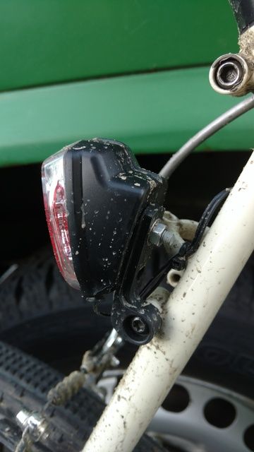

I zip tied the wire to the unused cable stop to keep the wires from getting pulled from the light if the wire gets snagged. I also ended up using the plastic push in connector things and I’m not sure how I feel about them quite yet. They didn’t feel secure when pressing them in but they won’t pull right out when I yank on the wire. I’ve thought about soldering a wire directly to the board and using a dean’s connector or something non locking but that can wait.
