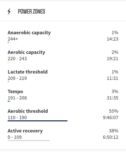

Reminded me to look at the data from my 400 the weekend-before-last.
My main focus was to just ride consistently in Z2, targeting 150-170. Looks like I still sandbagged quite a bit in Z1 :person_shrugging: (was a social ride too, I stuck with a friend the whole time)

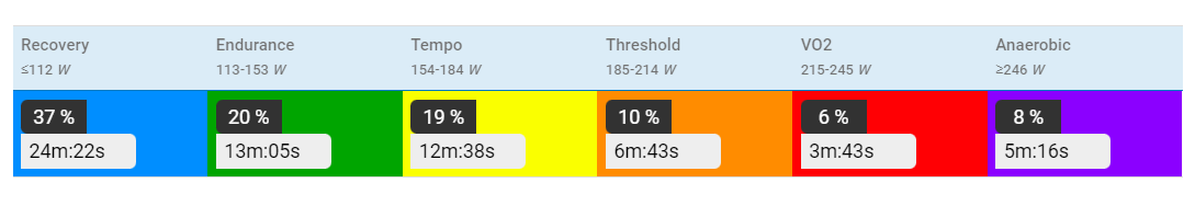

Keep in mind “z1” starts at 0 so it includes coasting. Honestly, that’s super good. Z1 is usually the most utilized zone on my rides due to coasting. So a z2 ride for me often is over 50% z1.
A “high intensity” ride might look more like this - but still 37% z1.
