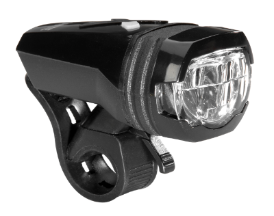

Just received one of the Alley F-275 headlights from Kryptonite, and was surprised to find that it has a shaped beam pattern. The cutoff isn’t as extreme as the StVZO jawns, but it’s far from the circular patterns found on so many inexpensive lights. Build quality isn’t on par with more expensive lights, but it’s not bad for $35. We’ll see how battery life and the mounting hardware do over the winter.

That light appears to be identical to Axa Greenline lights.

and they rebrand the same light too http://www.kryptonitelock.com/content/kryt-us/en/products/product-information/current-key/003069.html

I put ~50 miles on the Krypto/Axa light and it’s not too bad. The beam shape is decent, but there’s a distinct dead zone between the front tire and the main section. I have the light mounted to the front part of my Jones Loop bar, so that might be making it worse.
The mounting system is very flexible, which makes for a jumpy beam on even the smoothest of dirt roads. Cycling through the modes is a PITA, too, because it goes low>med>high>flash1>flash2>off. There’s no press-and-hold-the-button-for-2-seconds option to turn it off, and it always starts up in the low setting.
